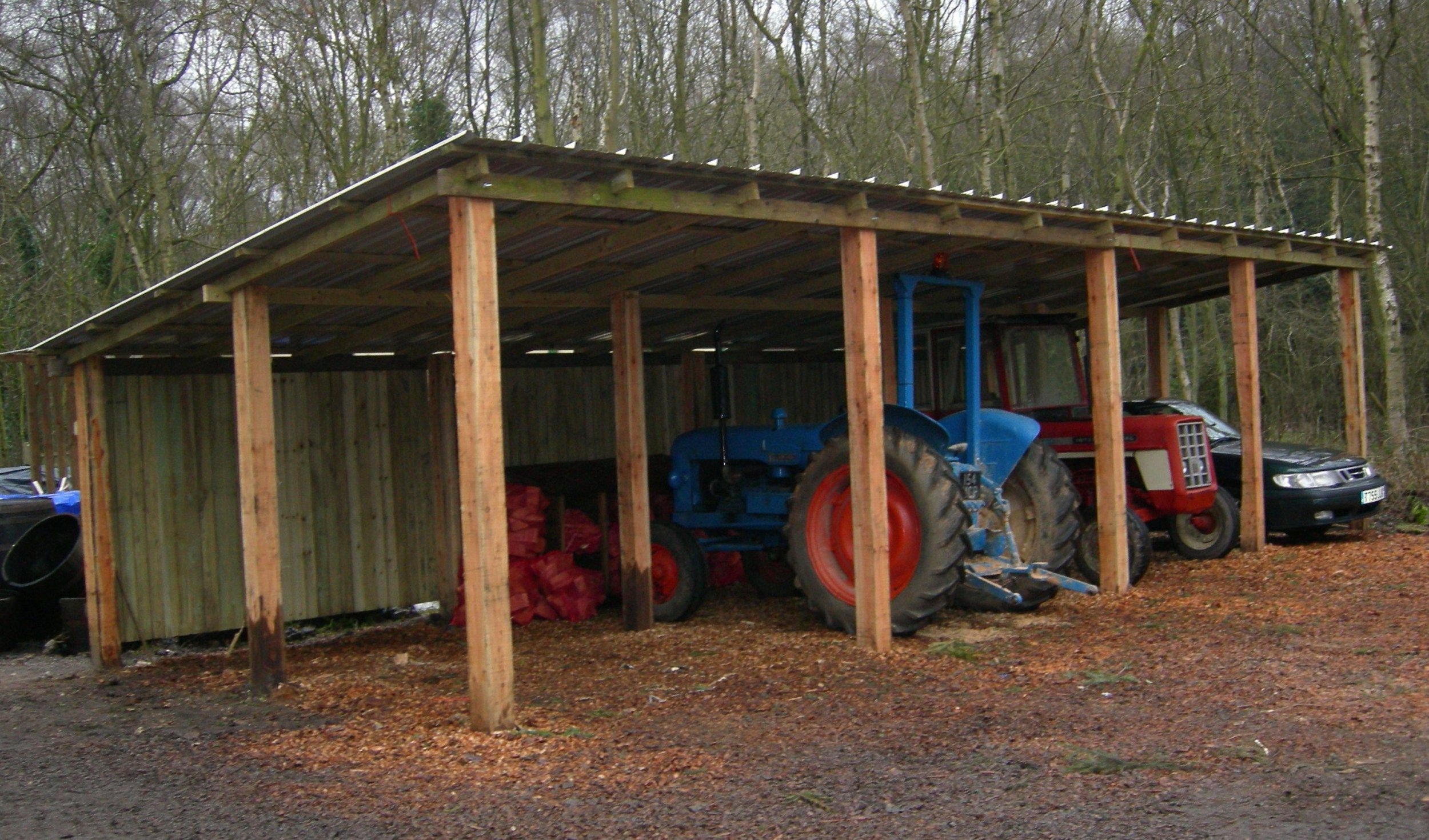

Could you add a lean-to on the other side? I suppose you could put down railroad ties as something to park implements on as an alternative to concrete?
I could, the problem is that it is visible from the road. I'd prefer to put it elsewhere. I will put down some stone and bind it with concrete dust or something like that.

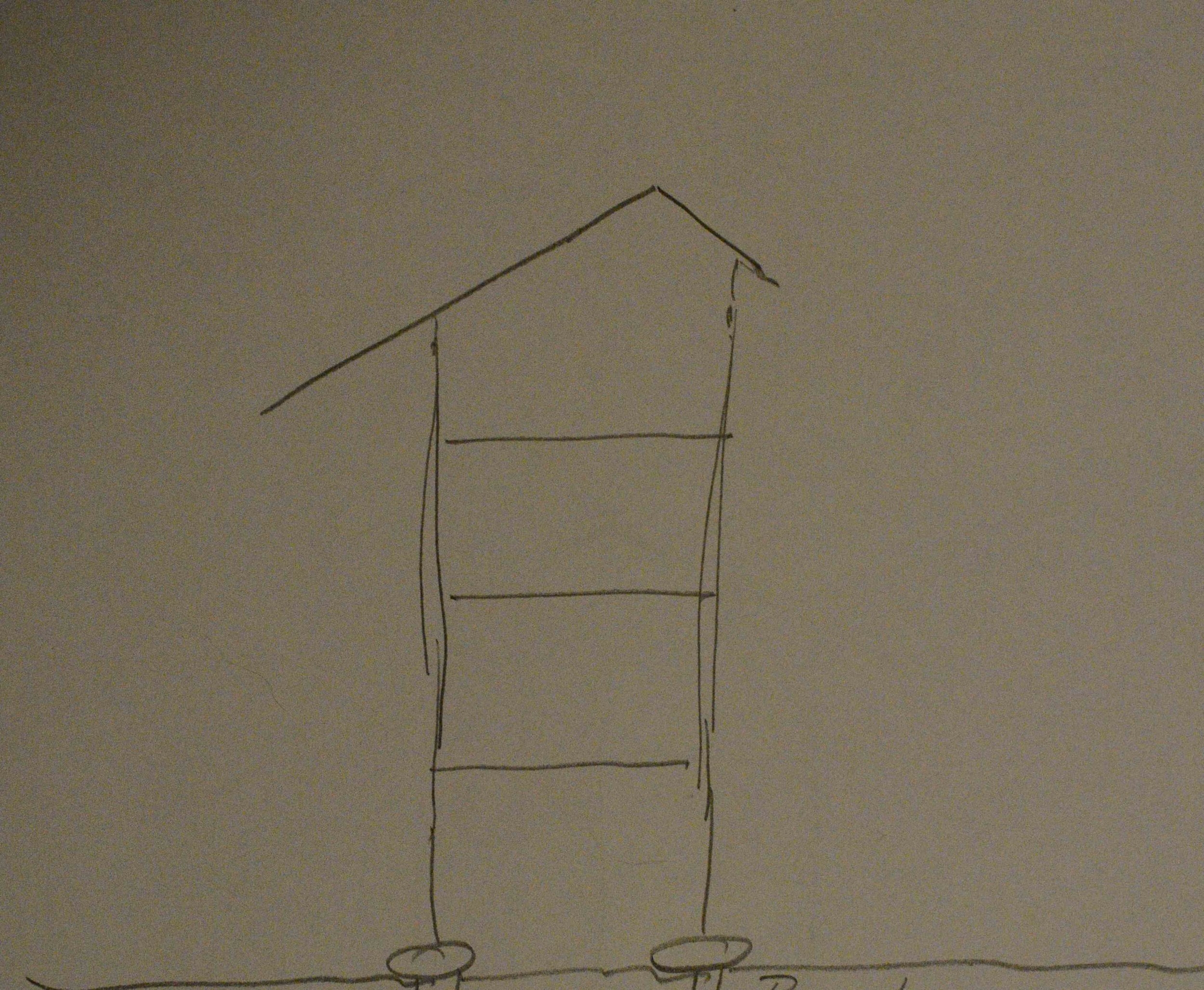

Wouldn't minimal free standing pallet rack storage look something like this? Some kind of shed roof that would be open enough on one side to remove implements, with the pallet rack bolted to some concrete piers poured in the ground? If you don't have a backhoe to dig footers, I'm thinking PHD could dig the holes for concrete piers pretty easily.

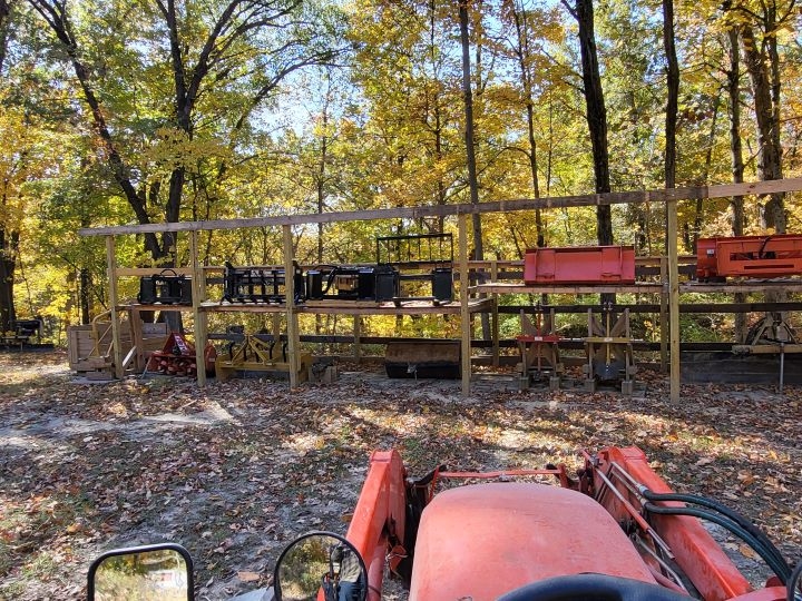

Definitely will set the posts in concrete. I could maybe do a 3x1 for now. It would be rare to have nothing on the 3pt. When using PHD, I could just set box or flail to the side, it would just be until end of the day. Grapple, forks and bucket could rotate into the top 2...my loader goes a little over 9' up, so even 4' high levels would be fine.

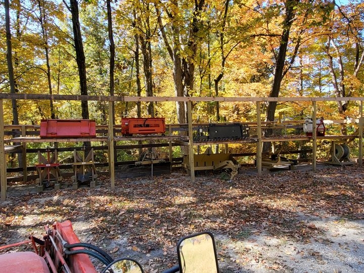

Much bigger than I will need, but similar concept. What are the dimensions of your 'stalls'?

I've been thinking about how I want to store my 3pt and FEL attachments/implements. What I envision is a stand-alone covered lean-to with room for 6 items. 3 up, 3 down. For my purposes, the implements would be 72"(6ft) or less (+/- a few inches). The plan is to use pallets.
How much clearance do you think? I was considering the outer 'stalls' at 96" and center one at 84". Is 4' high enough for the 2nd level to start? 6x6 posts at the corners? I'll slope the roof toward the back and cover with leftover roofing/siding from my house.
I know I could hunt around for Pallet racks, but those typically are not covered and I have no skills at metal working. I can do ok with wood working as long as it doesn't have to be pretty.
Just looking for ideas at this point. It will probably take a few months before I am ready to start.
Thanks!

If you have the room, I'd suggest something like this. Put the stuff on wood pallets and not worry about shelving/racks.
for FEL implements getting them up in the air so you can see them helps a lot with attaching them so for me all of my FEL stuff will be high.
