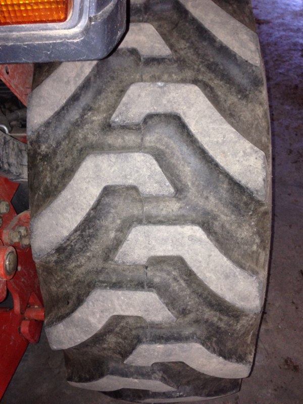

The tread design is important too. I see some of these CUTs with horrible looking R4's. I my 4240 had more agressive R4's on the rear.
   / How would you compare two HST transmissions? #40
Here's mine. I have seen some that looked more like turf tires. They are nearly as aggressive as ags, but they are much wider. I like the width, it doesn't cause ruts as bad as a narrower tire. image-542677385.jpg
