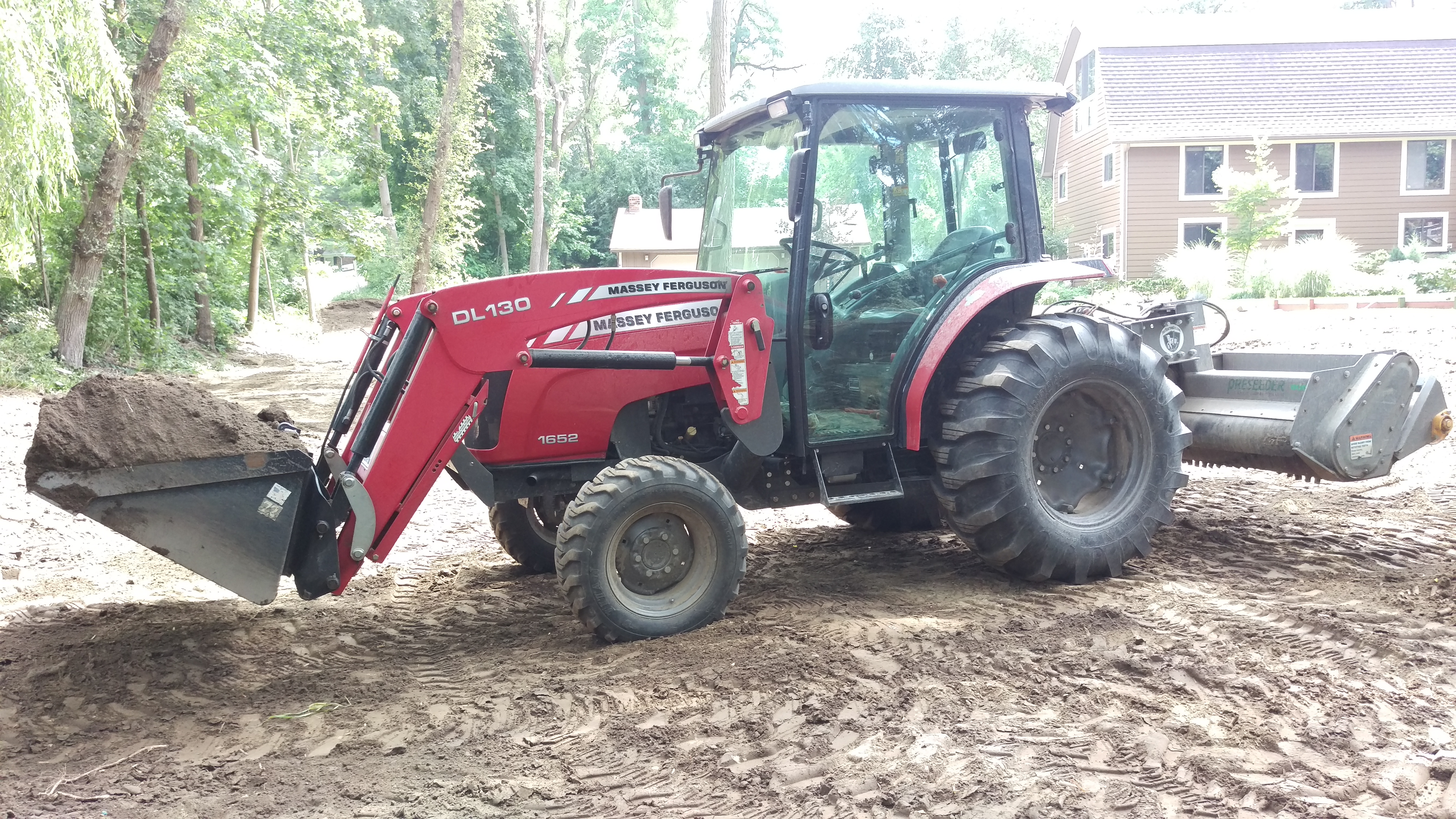

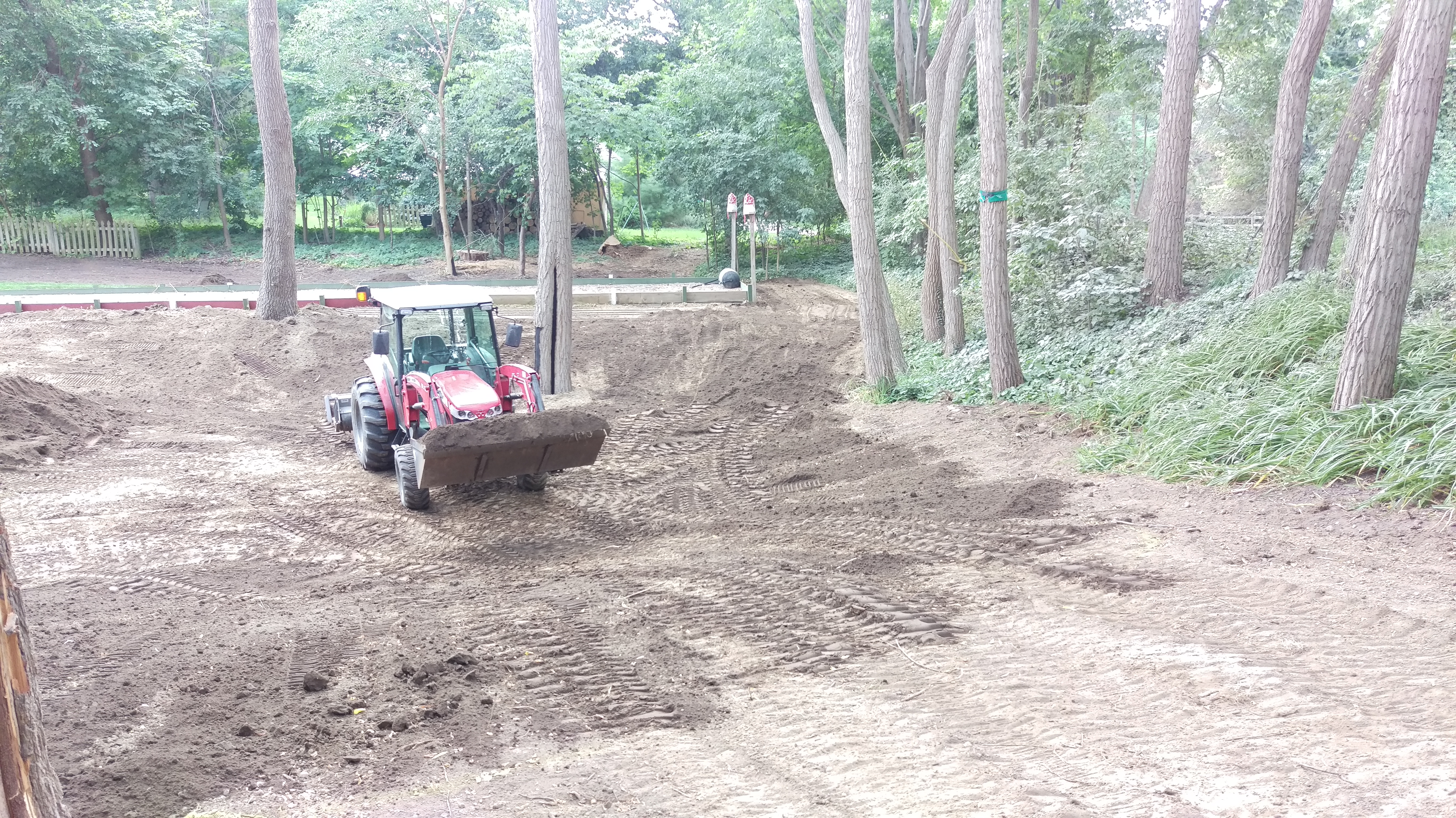

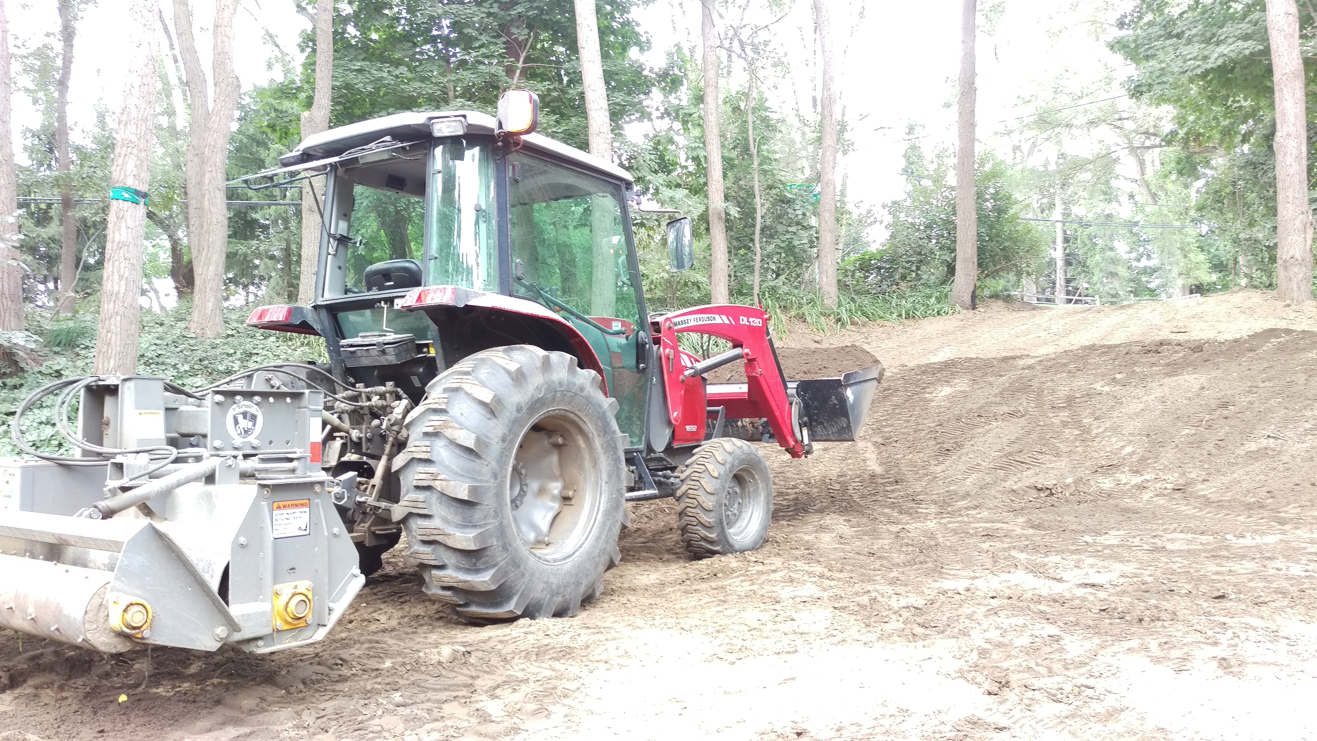

On a job today, took a couple pics & vids. The first vid (and I'm sorry they were so shaky) is going up a hill, first in Medium, then in Low. The second vid is pushing into a pile of topsoil, first in Medium, then Low.
The tractor is a 52 HP Massey HST Cab. Loaded rear 17.5Lx24 R4 tires. Have mounted on the 3pt an implement weighing approx 1200 lbs. Also, notice the full bucket of fresh, moist topsoil (probably right around 2000 lbs).
For the hill climb, Using auto-throttle when going up the hill, I kept the throttle near idle and let the tractor adjust. The hill is about a 30% rise (rises approx 10 ft over 30 ft). In the vid, I start right at the bottom of the rise, no running start.
For the "pile run" I set the RPM's around 2500 psi (for the loader) and pushed into the bottom of the pile, working the joystick like normal to fill it...no cheating by digging from the top where it's lighter.
Vids are just for comparison sake, to show you how my HST tractor reacts under load.

Seems to work well with no strain apparent, very similar to my Deere 4520. Nice tractor and should be easy to work with without tiring the operator. A lot of my work is similar to this, back and forth up and down an embankment makes good use of a hydro tranny.
The noise from the hydro is more predominate on your MF, on my Deere it is more a mix of engine than hydro. But no accurate way to judge actual sound levels from a video since playback volume is at the discretion of the individual computer settings.

Yeah I think the noise is a combination of the foot pedals linking directly to the valve (not electronic), that valve being right under foot, and the minimal amount of cab insulation that AGCO-Iseki uses. My buddies L5240 is also alot quieter.

Could be but a nice tractor regardless.

Get a few more hours under your belt and maybe you will learn how to actually get a full bucket when digging in a loose pile of dirt :D
Just kidding. :laughing:

Thanks for the vids. That second bucket load sure was full.
