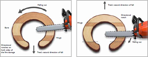

Found this info on the Huskvarna site: Felling weakened trees. Looks like option 2 for a fire damaged tree would be most applicable to this tree.

Cord,
You are thinking right IMO. I climb and top but its not my dayjob either. You know enough to know this trees a problem. Option 2 is what I was thinking as well. Notch your face and plunge the sides. If it were me, I would drill a hole in each side where the plunge cuts go just so you can assess how much live wood you have. Remove some bark and drill a 1 inch hole each side. Also, make sure you are watching out for widow makers up top. Probably didn't have to tell you that. I would have a rope in it as high as you feel safe spiking up it. If possible put you a safety tie-in on another tree just in case. A good maul hit can tell you a lot about the trees firmness too(widow makers issue again)
I read a lot on the Arborist site dot com. If you can ignore the people who just mouth off, you can learn a lot and pickup good info. You might even post your pic there to get more opinions and just take it all in as needed.

   / How would you guys drop this tree? #26
It would seem like your tree matches this example from that Husky website.
