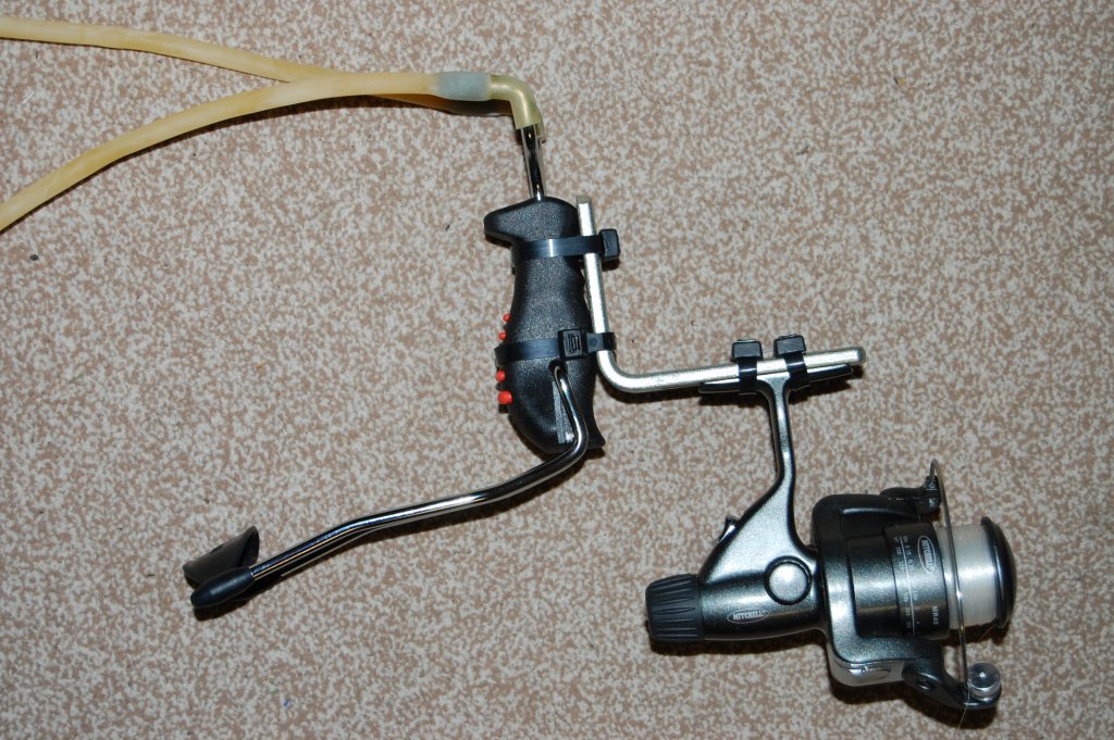

Or this... a wrist slingshot with an old fishing reel attached.
