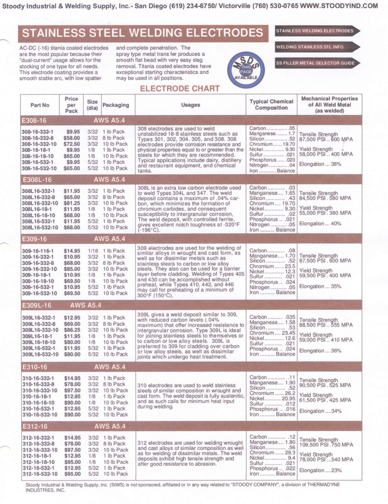

I've never used 312 filler rod, only 308 and 309. Curious as to what are the properties of this rod.

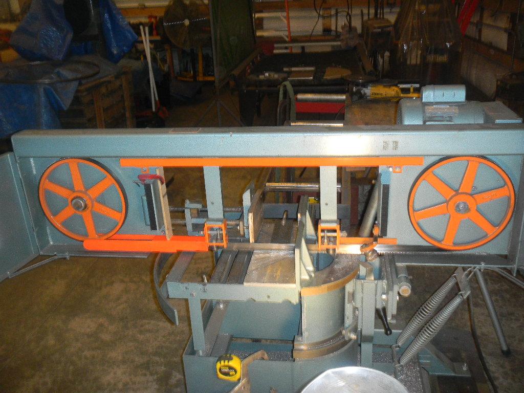

Have you ever checked tension on the BS blade? There are tension meters you can get for not too crazt money. Iturra has them (focused on WW applications, but tension is tension in a BS blade)... I'm just wondering if you are way over-stressing it by accident. Lennox is known for good blades. I have one of their sawzall blades and it is incredible compared to the usual Milwaukee or other stuff. But a defective batch is also a possibility.
Besides...a REAL MAN OA welds stuff like that, and doesn't leave all that ugly filler to grind away. A quick wipe with a scotchbrite pad should be all you need to get the weld flush with the blade...:D:laughing:
The amount of tension crossed my mind, especially when this blade broke at the top. When I replaced the broken blade I used a lot less tension. Trust me, I'm the kind of guy who can break a cannon ball!:eek::eek::eek::eek::eek::eek:

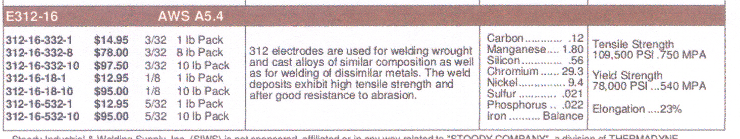

Only reason I went with the 312 is. I use to drive piling for a living. Seemed as I was the one who got stuck staying late or coming in on the weekends to repair the cast steel pile driving equipment. The company started out buying Super Missile Weld. The outside welding supply salesman told me if we couldn't get Super Missile Weld to use 312 Stainless Steel.
312 has 109,500 PSI tensile strength. 78,000 PSI yield strength.
Super Missileweld | The Harris Products Group

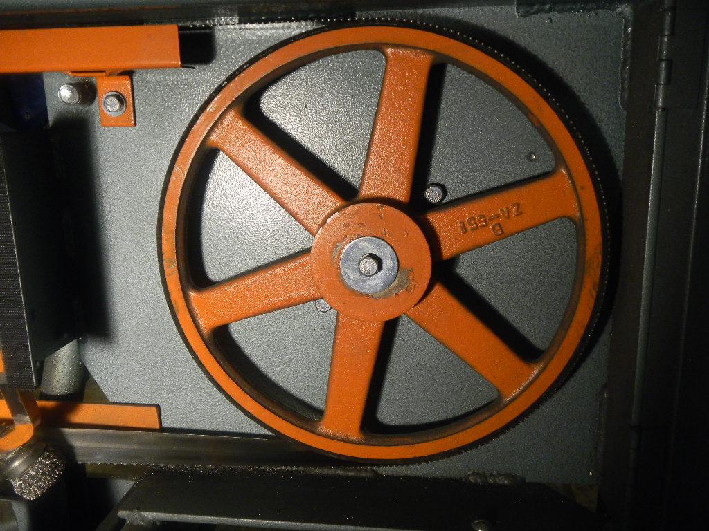

Do you have metal wheels, or rubber? If metal, check for chip build up. The big DoAll saw at work has grooves that will get chips in them. That causes the blade to bend a little more at that spot. Also, if the top blade guard accumulates chips, they eventually get caught on the blade and and a bunch get pulled under the idler wheel. That can break a blade.
