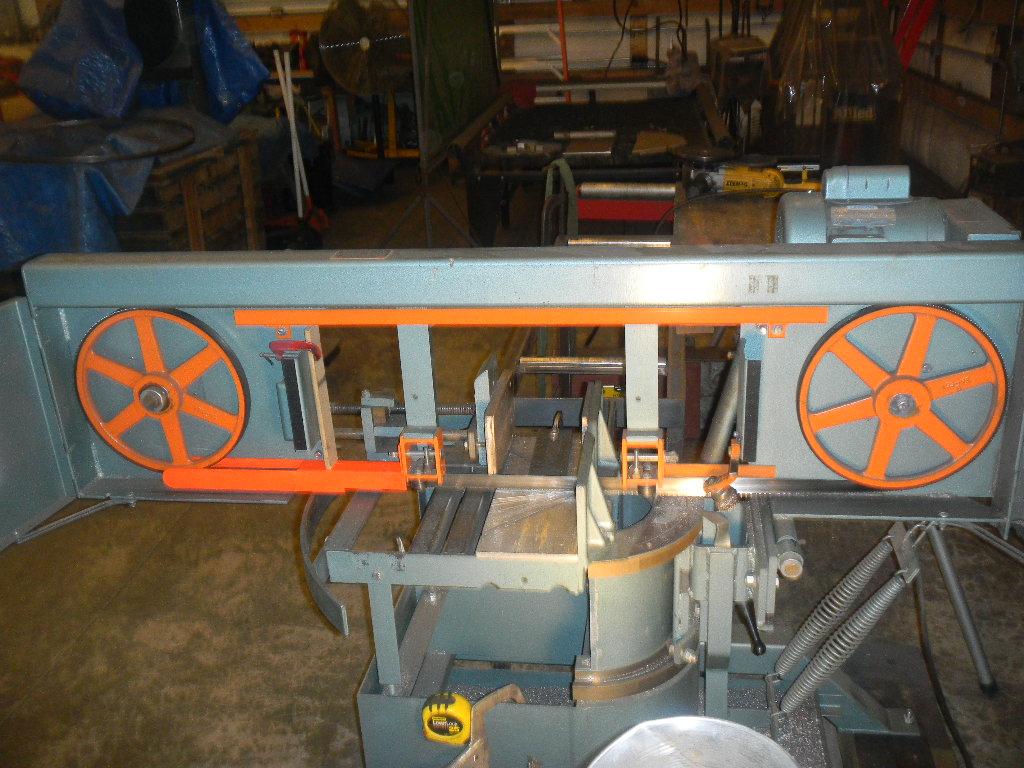

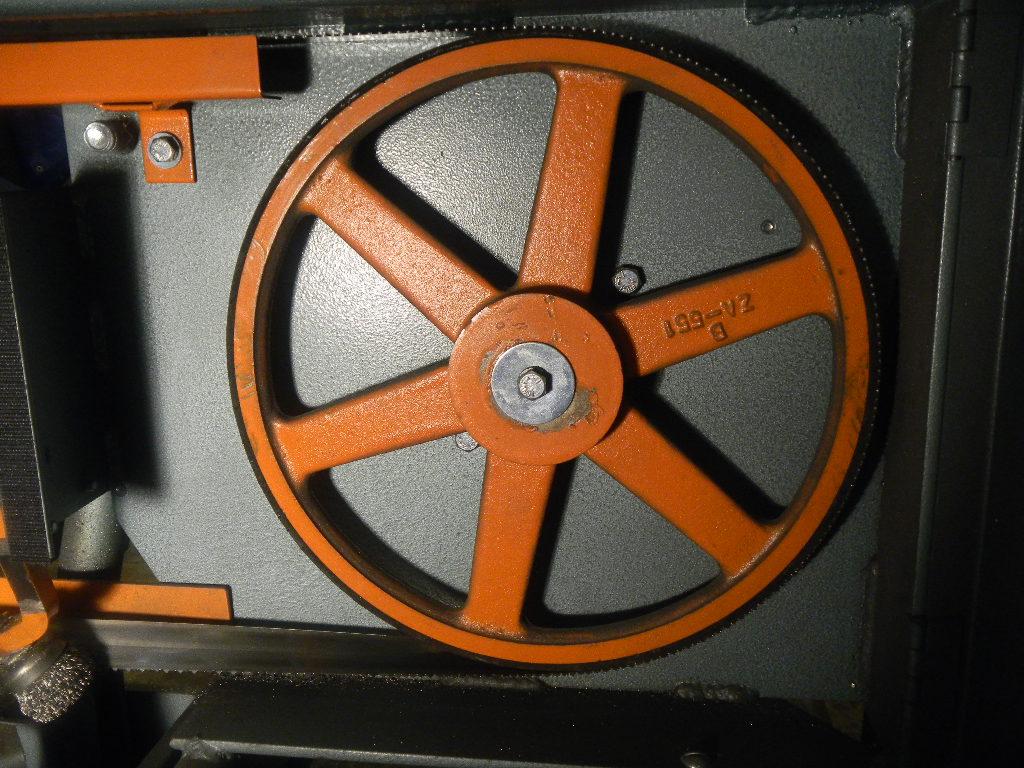

Dan they are steel, with a rubber pad glued to them.
   / How would you repair this? #22
So no metal to metal contact with the blade. Hmmm. The only thing that I can think of that would cause the blade to crack from the back is if it were nicked and had a stress riser, or if to were bent/creased at one spot.
A blade broke at work once, and we had no backups(guy was afraid to say he broke so many blades) so I tigged it back together to finish the job. Carefull inspection after the blade broke again in a different spot, revealed that the blade had many cracks all starting from the back.
We cleaned all the chips out of the wheels, and the top guard and blade life improved.
