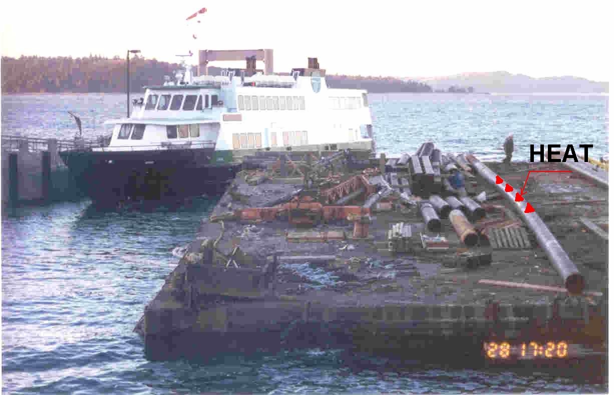

Working on a ferry slip. When driving this pipe pile, a 300 car ferry came into the dock. The wave action bent the pile. I had to straighten it with heat.

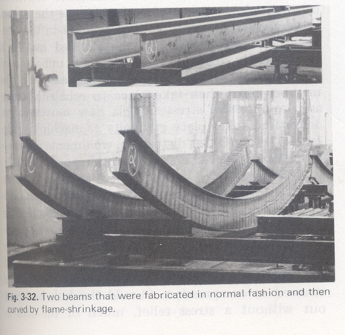

If anybody has this book. There is a picture in it, show what heat can do to beams.
