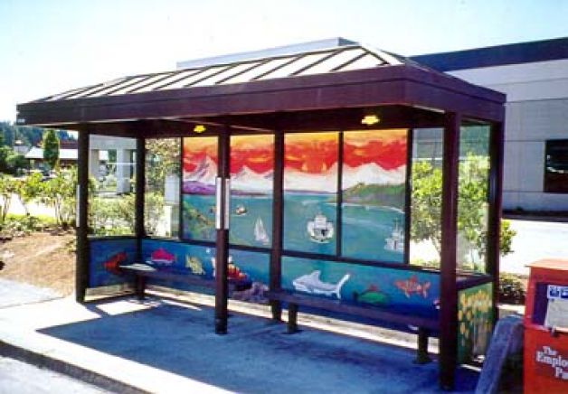

In the 1970s I got stuck building 200 of these Seattle Metro bus shelters. At the bottom of the legs, the specs said the legs had to be within 1/8-inch. Square tubing is very reactive to heat. Guess how I got all the legs within an 1/8-inch? :D

I'm just a beginner at welding, but I'll take a stab at this. My first guess is that you welded in a sequence, or pattern that caused the metal to heat bend one way or the other. More likely is that you assembled things in a careful manner and then heated the metal to cause it to "warp" into spec.
   / How would you straighten this? #40
I'm a big believer in correct weld sequence, back stepping welds, and skipping around a lot. To prevent weld distortion. But when welding these bus shelters together. I didn't worry too much. I knew I had to heat shrink all the legs within the 1/8-inch tolerance.
