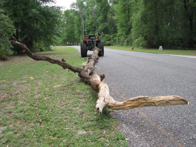

I cleared a lot of similar jungle in Florida. I used a Kubota B3300SU = 1,900 pounds bare tractor, 33-hp, R4 Industrial Tires/Air.
You are asking a lot from a subcompact 20-hp tractor with 10" of ground clearance.
First off, BE CAREFUL. It is all too easy to topple a light tractor when applying force.

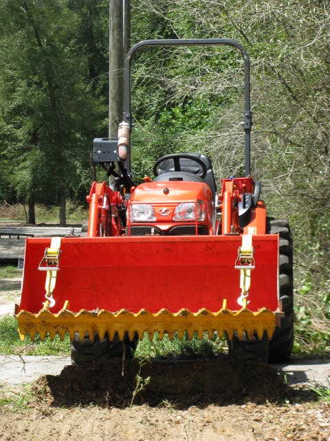

A Ratchet Rake for your bucket, in addition to the Tooth Bar you already have, would be my first suggestion.
Ratchet Rakes are sold by the T-B-N store.
RATCHET RAKE VIDEOS: https://www.youtube.com/results?search_query=ratchet+rake+brush+clearing
After knocking down brush and saplings with the Ratchet Rake, a Rotary Cutter (Bush Hog brand or other brand) will chop up vegetation, killing a fair proportion of the verdure.
I had a 48" King Kutter (brand) [standard weight] Rotary Cutter that was indestructible. You need a fairly heavy R/C by weight as you will often push it into brush in reverse, so the tail wheel and tail wheel mounting take a beating. Light weight R/Cs, made for mowing open pastures, will break.
Consider an Everytfhingattachments.com Rotary Cutter: Everything Attachments Xtreme Duty Compact Brush Cutter Inquire if 17-hp/PTO is enough to spin this beast.

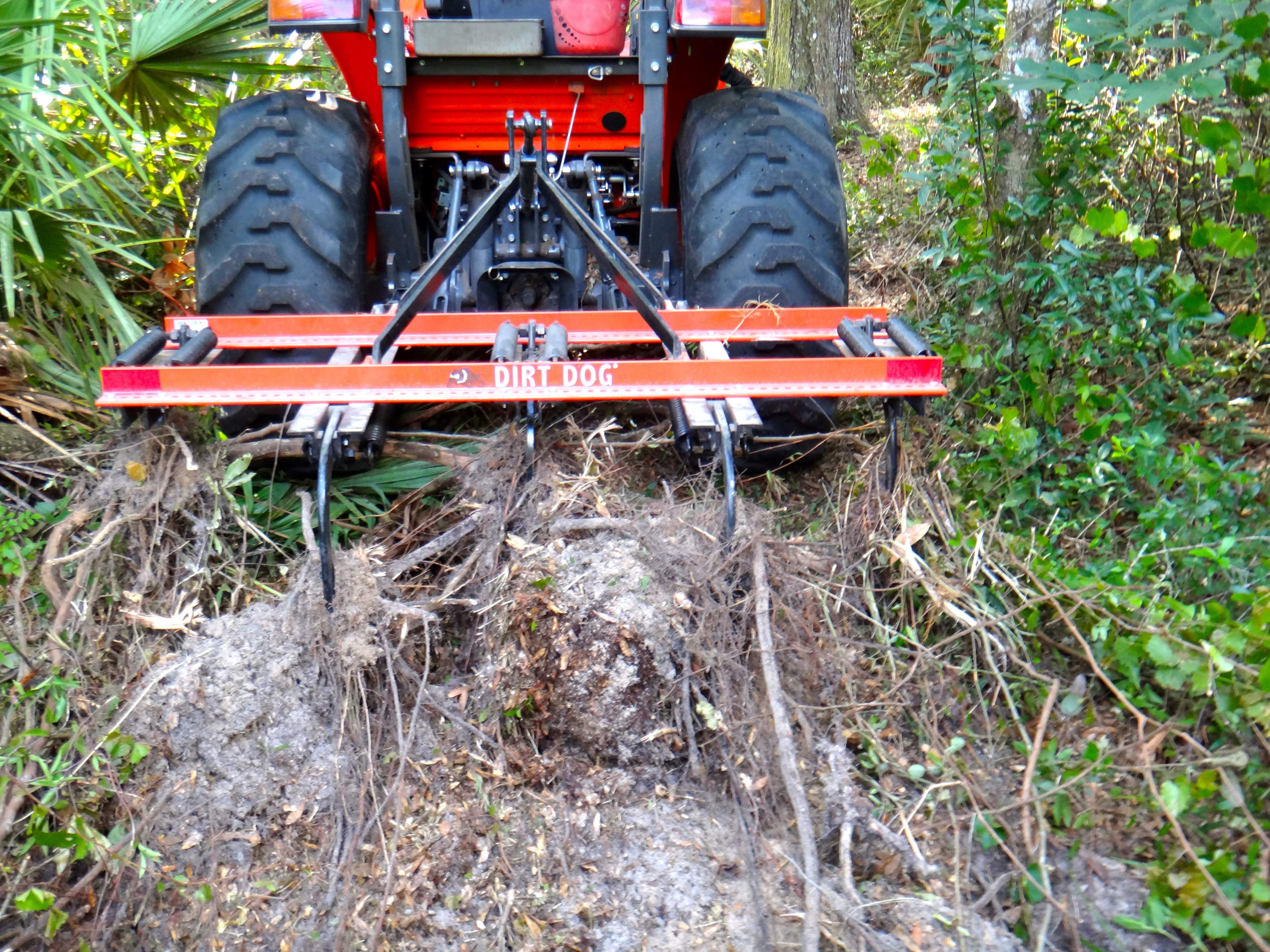

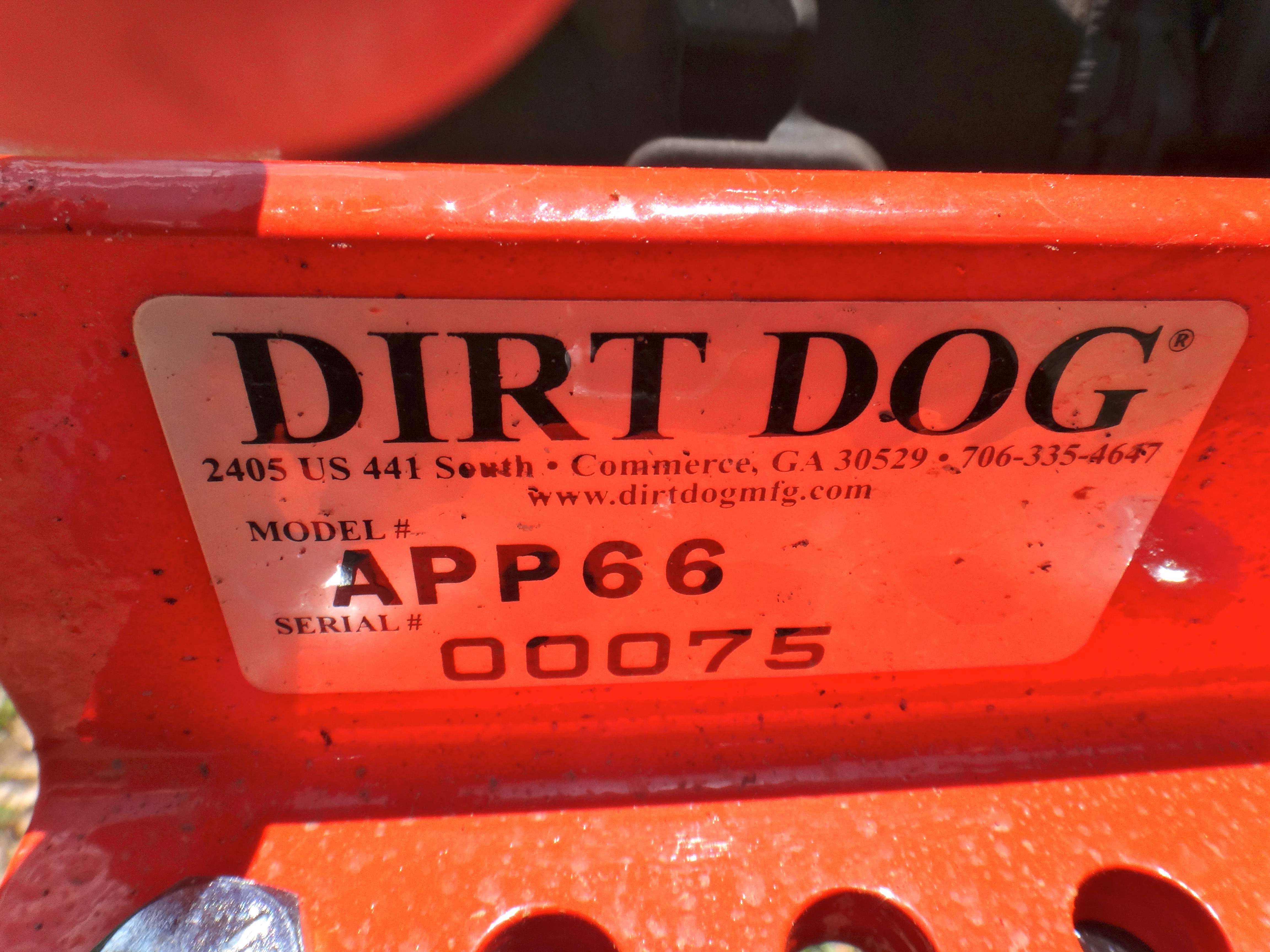

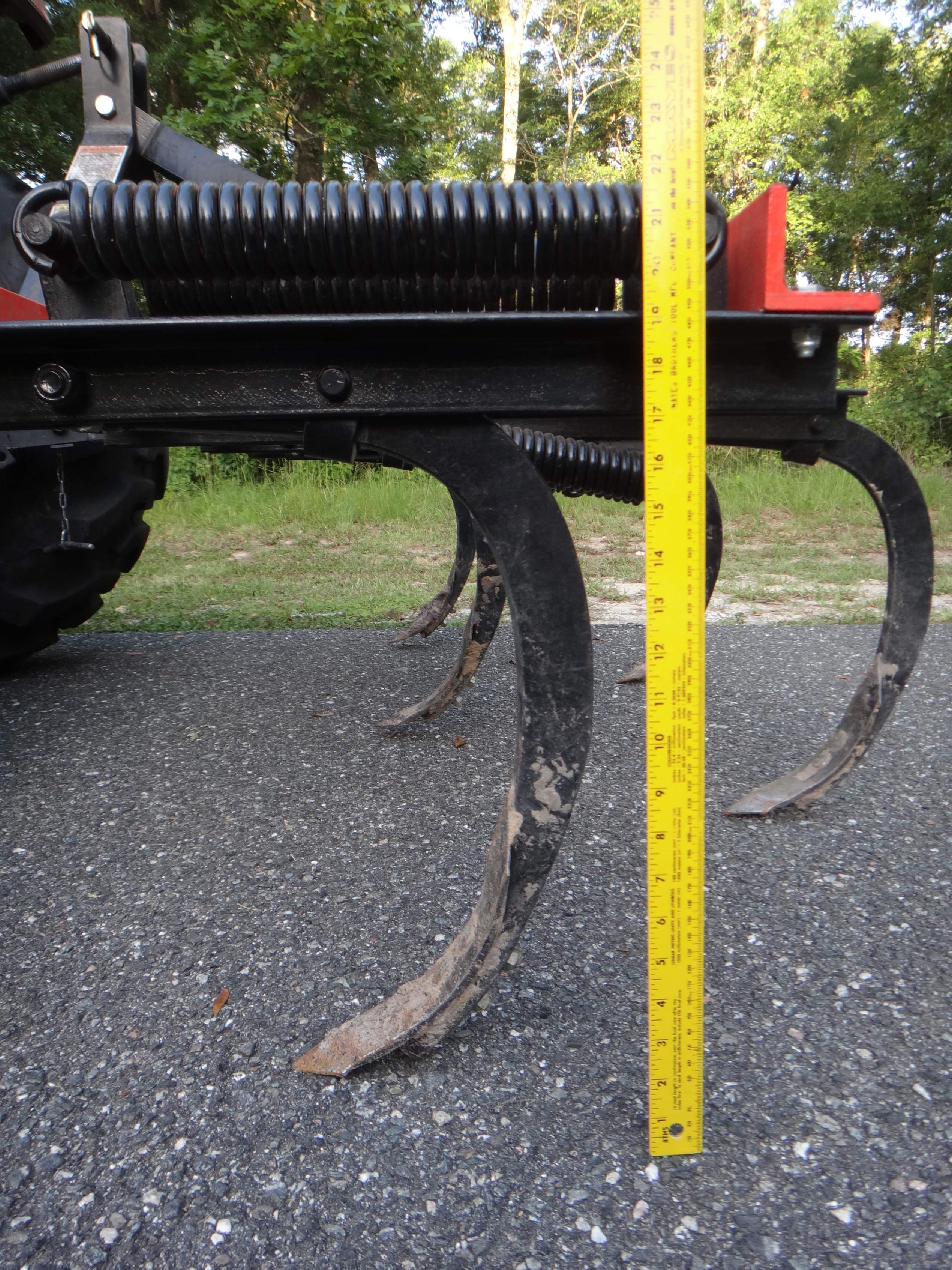

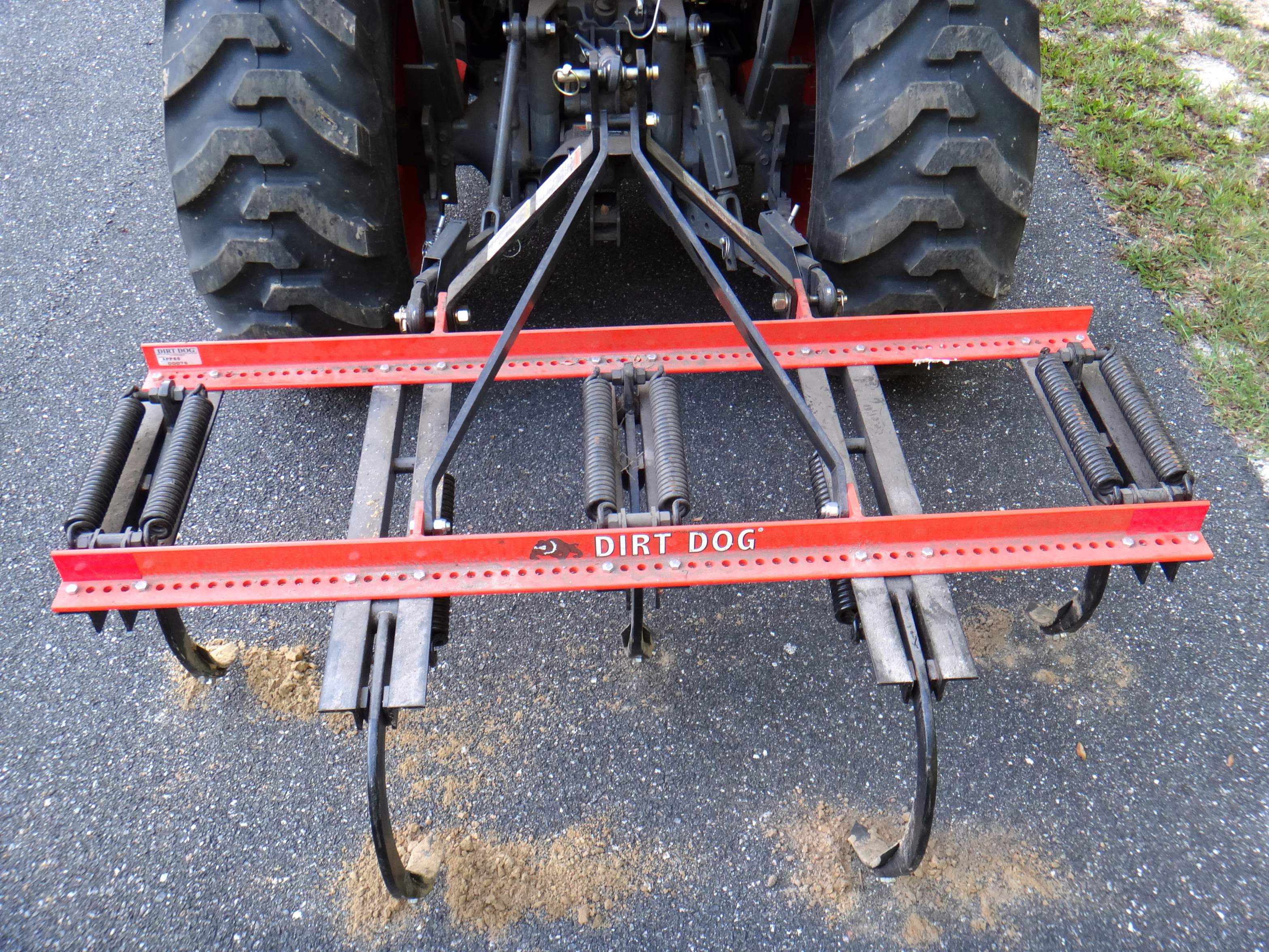

To pull out roots, wild rose corms, Smilax and grape vines under the surface a Field Cultivator is the best implement. The spring protected tines are 3/4" wide so they pull relatively easy. You would have to buy a five tine model then remove one or two tines. You can pull three tines, possibly four tines in moist soil. Read my LINK.
ETA FIELD CULTIVATOR VIDEO: https://www.youtube.com/watch?v=3R-8ZhFlO5Y
ARCHIVE LINK: http://www.tractorbynet.com/forums/...ement-vine-root-removal-woods.html?highlight=
With the Ratchet Rake you can readily pile debris. There will be a lot of debris.
