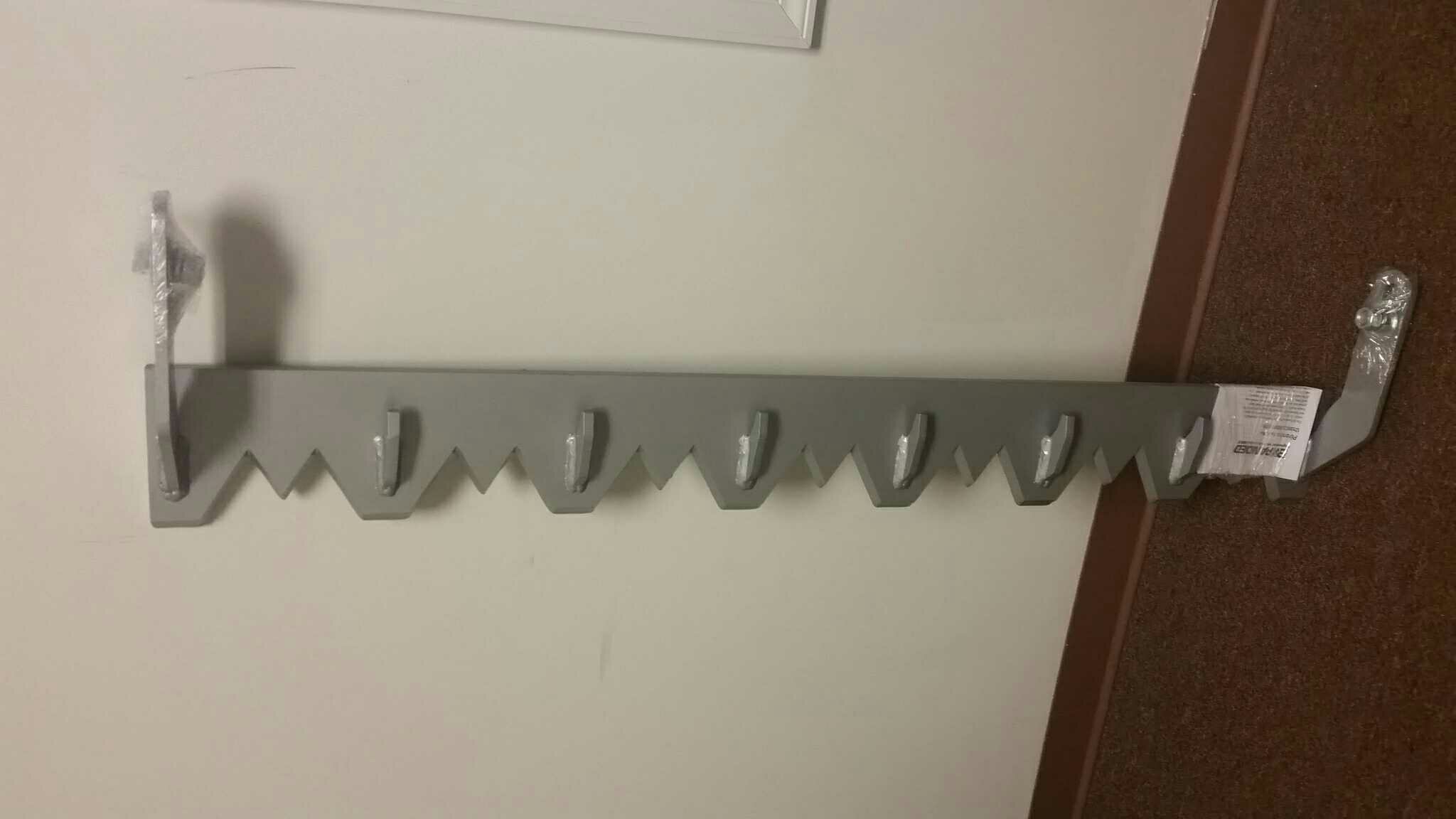

I have cleared acres of blackberry brush with a Piranha toothbar........well made product.......they will custom make one for your bucket. I never take mine off. Definitely a backhoe for the stumps.
BXpanded Piranha Tooth Bar
Look what arrived today. ..

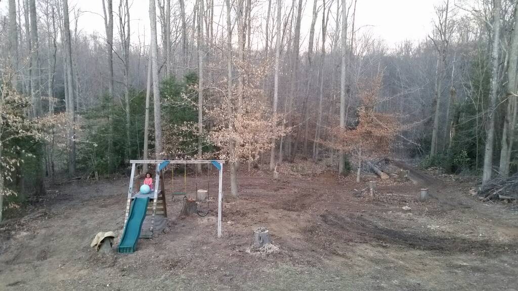

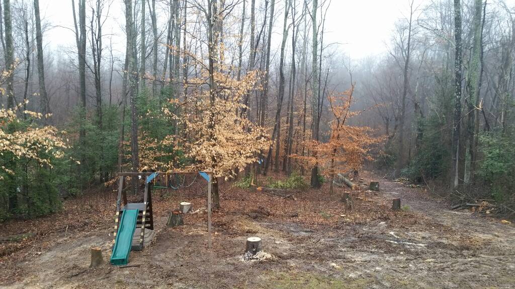

On the seventh day, I rested after successfully making play room for the little ones.
Thanks all for your input. The BXPANDED piranha is amazing.
