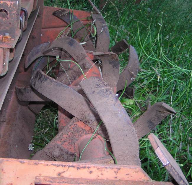

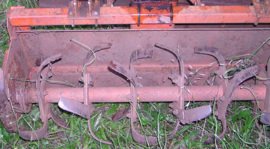

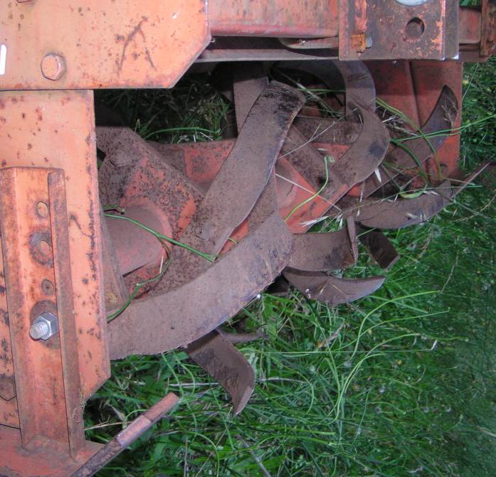

I have a Howard Rotavantor J and I removed all the tines and I can not remember how to install new ones. I have purchased them but not sure how they go back on. Can anyone help?

Here are a couple of photos.
My blade turns in the forward direction (as if to push the tractor forward as it is tilling).
Right/Left hand blades are alternated.-
Curved blade bolted so blade is mounted on side opposite from curved section.
Let me know if you need more info. I have no manuals with my tiller.
