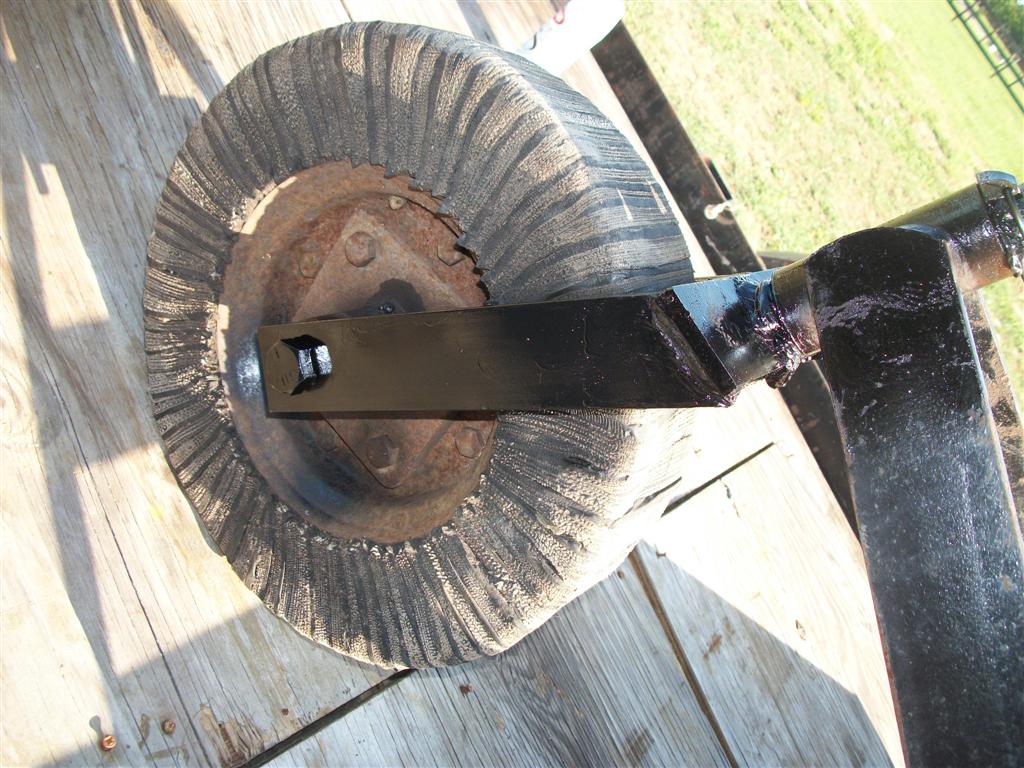

here's the fork installed

That is exactly what I need done to mine. Right now the wheel wobbles and is at a funky angle and won't roll properly in reverse.
time to make one. I did so with 3/8" flat stock, a chop saw, and a torch. used a framing angle to match some angles and measurements and a piece of soapstone to mark it all.
new long bolt and pal nuts for the axle.. some grease and paint and she was back in action. probably used 5 rods, and a minute of oxy-acet.
bet it didn't take me 15 minutes from 'darn that's not repairable' to 'there's the new one'
My Jbar has angle welded to the verticle pieces for stability. It is cut maybe 2"s shorter than the leg and stood there and each arm of the angle is welded to the flat stock. Im sure this it to keep it from bending easily.
   / Howse Brush Hog #29
if this one bends , and i doubt it will, as I don't abuse my toys, I'll weld some angle to each side..
don't forsee needing it. none of my other tailwheel forks has ever bent.. i don't use the back of my mower like a bulldozer like the previous owner of this one must have.. :)
