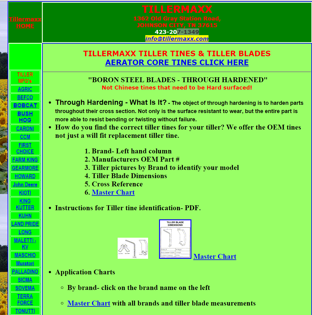

Any suggestions of the best place to get tiller tines? I run a 54 inch tiller, probably sees 20 hrs of use a year. After 16 yrs of use.. the tines have fallen fatigued and breaking off
Have you inquired at Tillermaxx to see if they have any tines for your Howse? I put some of their tines on my King Kutter ll tiller last yr. I've tilled over 25 acres since with minimal wear on tines.
   / Howse Rotary 3pt tiller tines
Will look into that.. thanks!
#9
odd..just attempted a call. and keep getting an Eva Campell... Johnson City is just across the state line from me.. one would think they would have their number right on the web page
   / Howse Rotary 3pt tiller tines #10
Did you call 423-207-1349?
