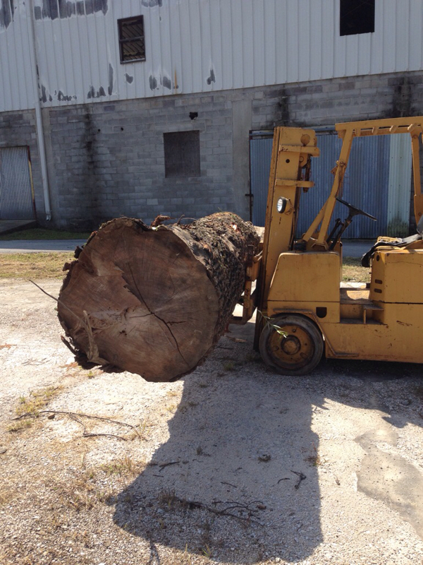

IF you have logs THAT big, you better be looking at "utility" tractors, IF you want the "front end" on your tractor to last...
SR

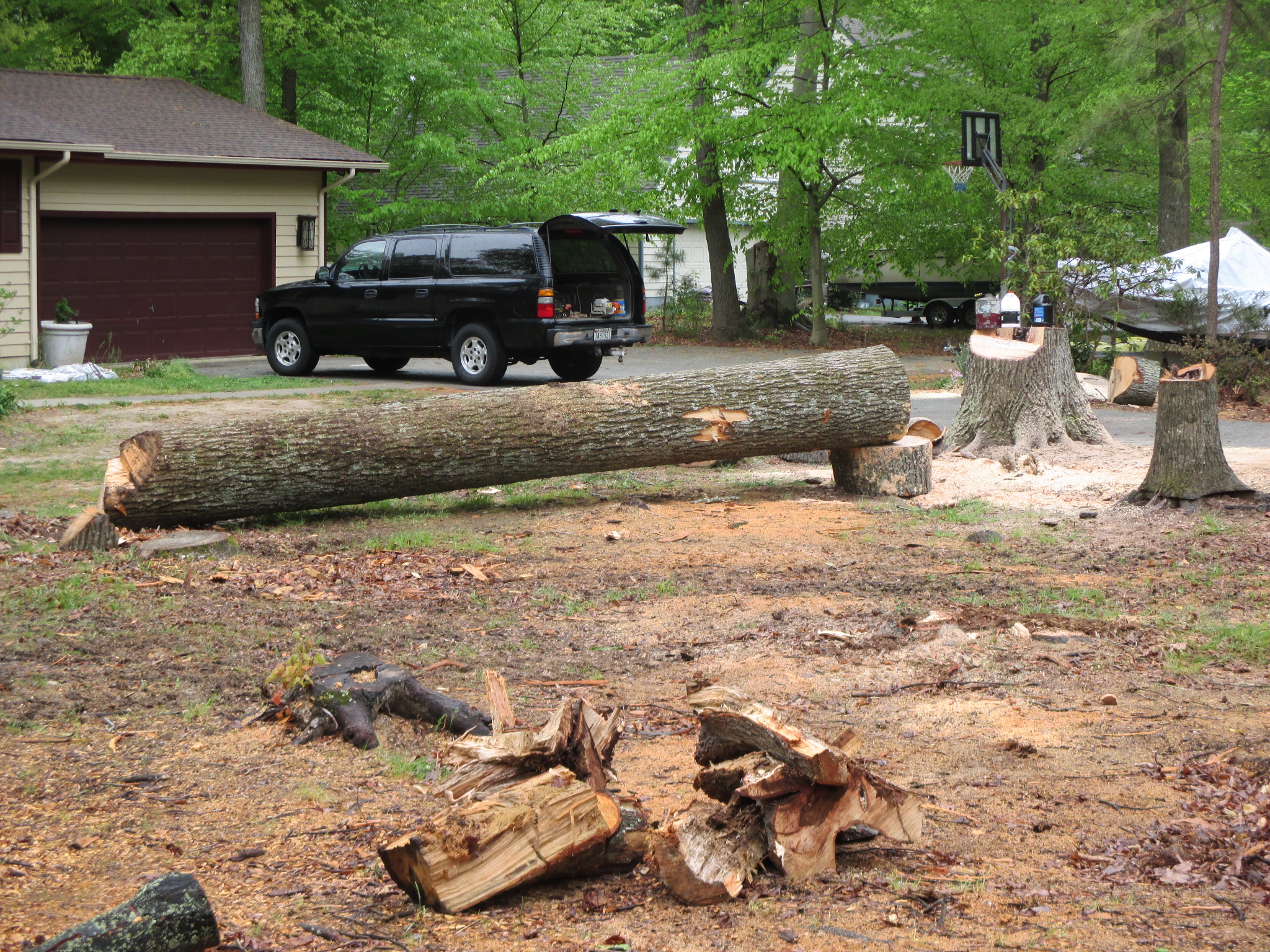

That looks like a big log....mine will be mostly in the 24-30" range with a few up to 36". Pretty sure I need to go utility, just not sure how much HP/hydro flow. On the back end of another post Ovrsvd mentioned his M9540, which interestingly was one I was looking at. Looks like 60 is about max HP range I have found in HST.
When looking at clutch units, knowing operator and use has a lot to do with it, what kind of hour range can I expect to get before a clutch job? Should I be concerned when looking at machine in the 1500-2500 HR range? What about synchro vs power reverser...opinions on either?

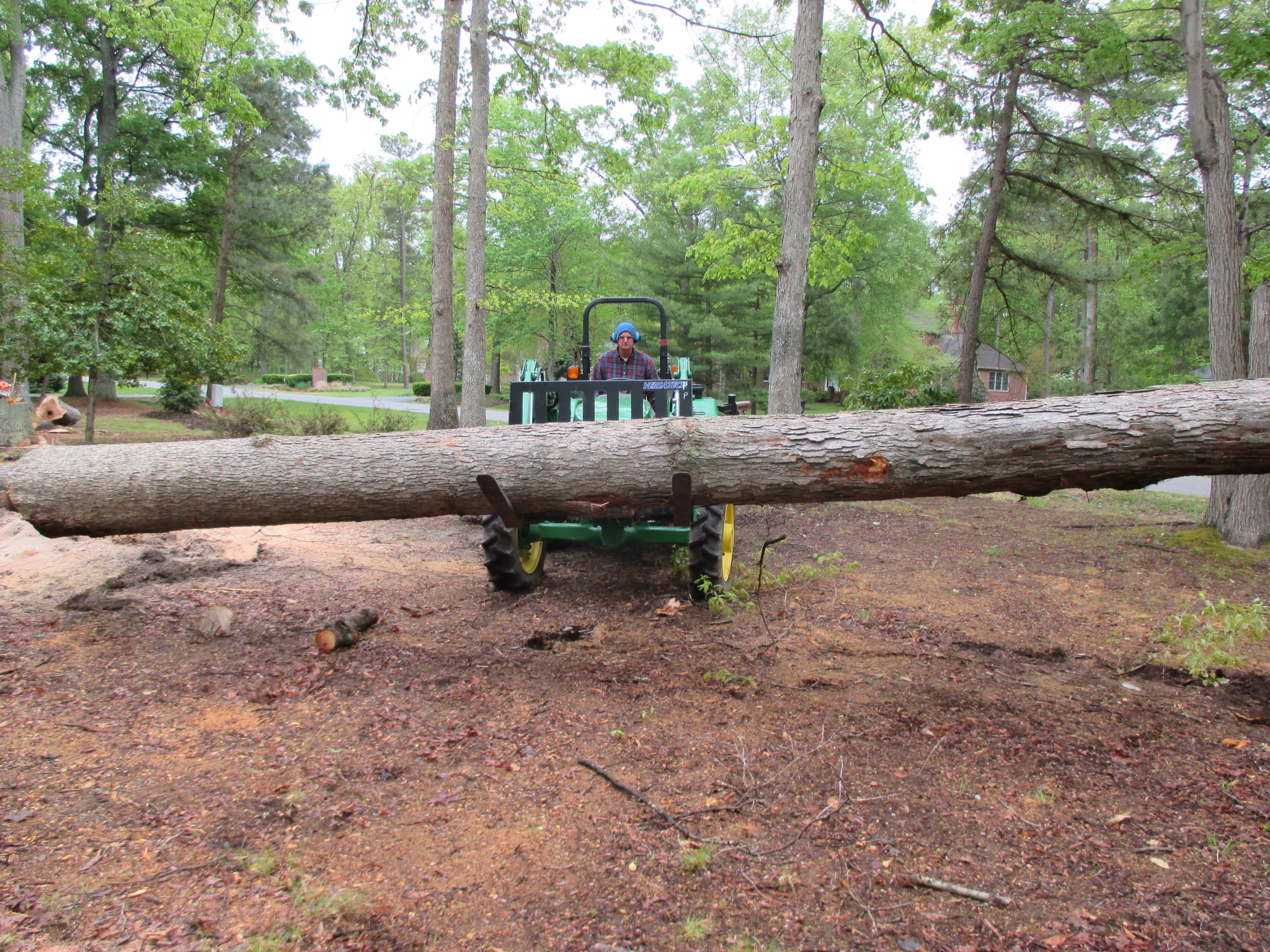

how long are these 24-36" logs? I have a 5055E with the 553 loader.
i could pick up this log 23" on end 26" the other and 23 ftish green oak
but not this one 25"-30" 18ft long (though it was close)
after this elm long dried out a bit i could lift it
the backhoe had no issues
i also wish i had spent the extra ~$3K for the power reverser. i expect at least 1800 hrs from the clutch on this tractor. we had ~ 2400 hrs on the gear tractor we sold last year and had adjusted the clutch pedal twice
