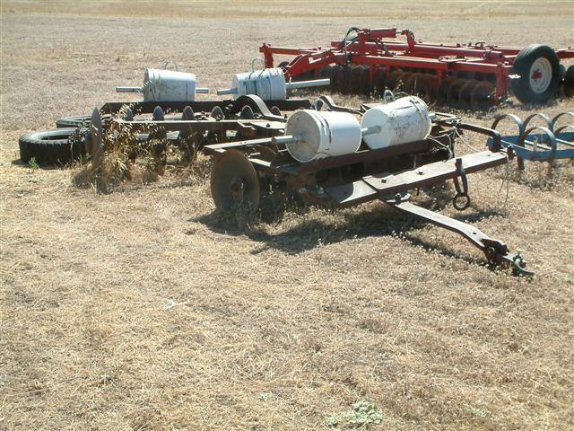

If it's a D-17, no problem with 49 hp on the drawbar. I pull a 6.5 ft offset disc with my Mahindra 5525 (54 hp engine, 45 hp pto) easily and it's a heavy disc with about 400 lb of additional weight I added to make it dig better.
