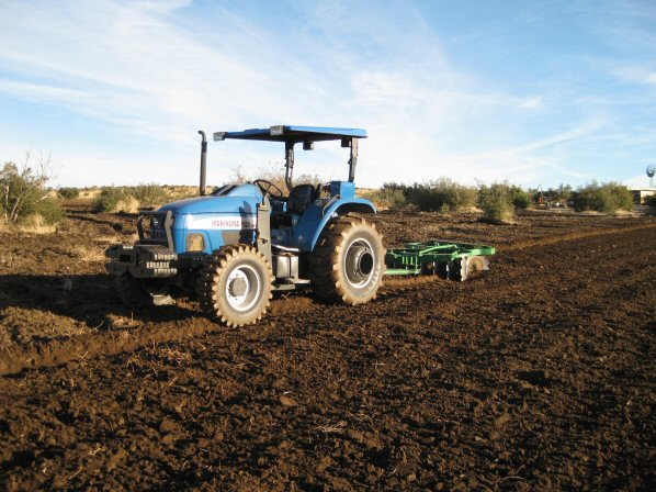

45 HP 2wd will pull a weighted 8' transport disc Ok. On repeated passes the issue is power not traction. Might get by with 40HP if 4wd.

Not a stupid question. The old drag disk were transported by taking all the "set" or angle out of the gangs. They would then just roll on the blades without disturbing the soil.
/ HP to pull disk #49

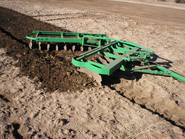

We farm 56 acres with a 49 hp WD45. I have a heavy duty wide front end not the factory wide front. We have 16.9's on the back with 15" rims. The soil is a nice river bottom sandy loam. Over the years I have used an 8' 3 pt disc and three different drag type disc's including a pair of 11' kewanee's. The 11 footers pulled better than the 8' 3pt. All of our drag types had hydraulic cylinders to lift and lower.
For the last several years we used an 18' batwing allis chalmers 2300 drag type disc built in 80's with the 17" fronts and 19" rears with 8" row spacing. We were going to pull it with the 190 but we pulled it with the wings up with a WD45. The disc was built in the 80's and is a drag type.
Now, however, we rototill with a couple of dead simple grey market 2pt rototillers converted to 3pt. We have a wopping 300 bucks invested in two of them. The chains inside are massive. I rebuilt them with new bearings and new seals and sleeves....no plow....no disc....no rotary hoe or drags and no more cultivator. I save about a day of work and about 30 gallons of fuel just prepping the field.
I'm sorry I don't have any pictures. I may have some after the fields are planted each year. If you contact the National Guard they should have thousands of them considering the amount of time they spend observing us from a beautiful blackhawk helicopter. I can't believe that in the last 24 years of observing us they haven't gotten bored. Sometimes they visit us over 20 times a season....sometimes they get irritable and give us a little wack with rotor wash. They must use a lot of fuel. We built them a big 100' smiley face tilled into the back field but I think they don't have much of a sense of humor.
Anyway, I liked using a drag type disc behind a 49hp allis until we found dirt cheap dead simple rototillers.
