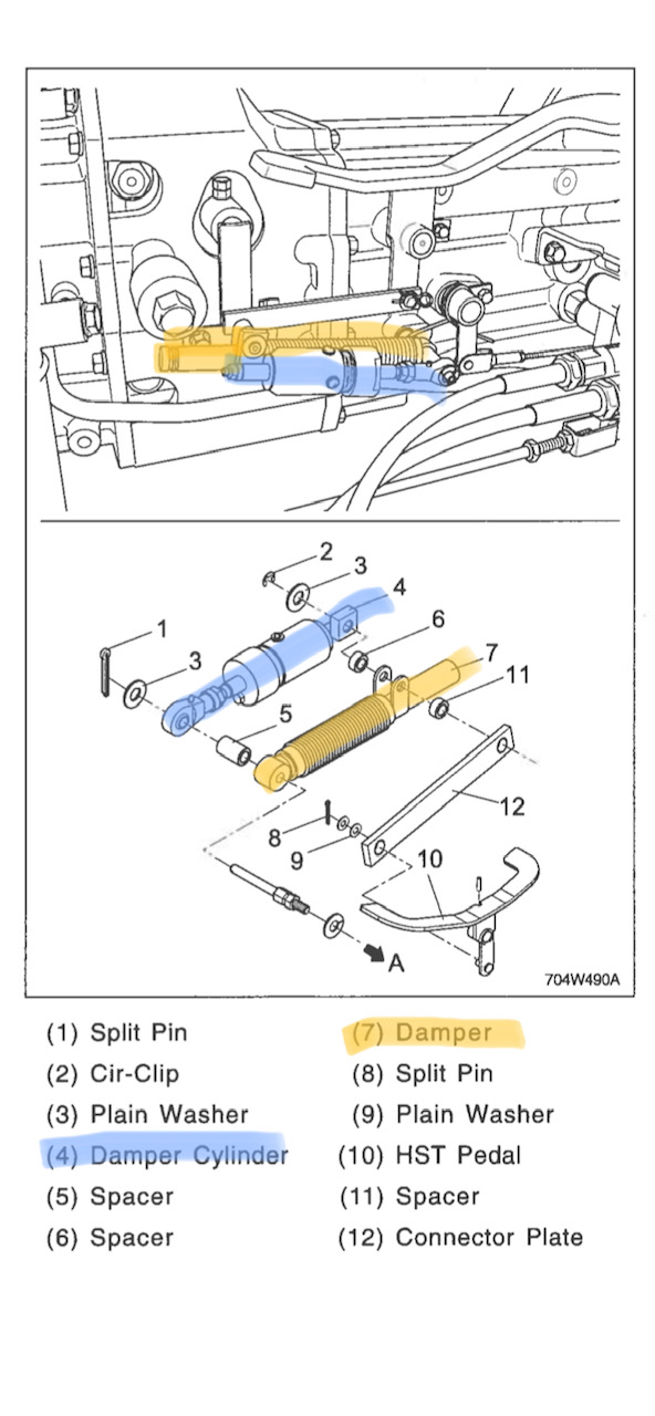

Do you have some knowledge in how Kioti HST works?
My Kioti CK30 HST creeps forward or backward when you let off the rocker pedal. There are threads littered with diagnoses, none of which seem to clearly fix the issue. Some blame the HST, others point to lubricating where the the pedal mech enters the transmission, others claim damper replacement... I did some trials myself to see if I can isolate the issue. There are three components I played with:
a. HST
b. Damper (orange in image below) - this controls the rate of pedal return from fwd/reverse
c. Centering spring (blue in image below) - this centers the pedal to neutral when you step off the pedal
1. Normal operating mode, with orange damper and blue centering spring working together
On a flat if you let off the pedal it just snaps back to neutral. But when the transmission is under load, such as going up a hill, the pedal is more firmly held (I call it "loaded) in the fully extended position and requires a tap on the pedal the opposite way to get it to neutral, but it will still creep. You have to keep tapping it gently fwrd/reverse to find neutral. It's dangerous, so let's see if I can narrow down the problem...
2. Removed both the blue centering spring and orange damper:
Some have said that the HST has a role in centering to neutral so I wanted to see if this was the case by removing everything connected to the pedal. Press forward and it just stays there. Press reverse and it stays there there. It just flops back and forth between positions - there is NO resistance, and therefore no feeling the HST has any responsibility for returning to center. Consistent with #1, when going up a hill the pedal is "loaded" ()))more firmly held in the fwd position) but it takes just a tap harder to push it back to neutral than when unloaded, as in on a flat.
3. Removed Blue centering spring but kept the orange damper attached:
If you put the pedal to reverse and release, the damper pushes the pedal to the forward position. This seems odd. Since the pedal just flops fwd/reverse when there is no damper I would expect the damper to just keep the pedal at whatever position you put it in and it just gives the pedal some resistance when doing so. I found this odd and potentially wrong.
4. Removed the orange damper, but kept the blue centering spring attached:
Snaps back to neutral on flat ground. On a hill, it takes a few seconds for it to pull it out of it "loaded" state, as the pedal is slowly pulled from this position to center. If you take your foot off from full fwrd, you can watch the pedal slowly return to center. It does not do this quick enough (4sec), but once it does, it's in neutral, and does not creep. This seemed like a good sign.
My takeaways from all of this is that the creeping is not an issue with the HST but is an issue with the orange damper/blue centering spring. But I don't see how the damper/centering spring work together to have more force to pull the pedal back when it's "loaded" and then less force when it's not. I would say the blue centering spring needs to be stronger to pull the pedal back when it's "loaded" but that strength would need to be less when it's not "loaded" (i.e. on flat ground)
If anyone has some experience in how this system works, I'd love to hear your input.

While most all axial piston pumps are similar, the actuation of the swashplate varies a lot, especially when it comes to tractors, some are direct linkages others use pilot systems, and again still there is electronic actuation. From what I am seeing here, it looks like your CK30 has a few things to consider.
I think this diagram and description will be most helpful to you:
View attachment Pages from 04 CK25, 30 Transmi.pdf
If that PDF does not load up properly, here is a lower quality screenshot

Talk to your Kioti dealer. Kioti made an updated damper that helps pull the HST back to neutral.

Ah! the Kioti dealer never mentioned this to me. By damper do you mean the orange damper or blue centering spring (which they also call a damper):
   / HST pedal creeping - how does this system work?! #8
The blue centering spring assembly was changed. If yours has 2 small Phillips screws in the case, 1 on top & 1 on the side, it is NOT the latest version. The change did not affect creep was only to assist in return to neutral but new ones still do not snap pedal back fast. If the rear mounting hole or the ball joint on the end show wear or if the shaft as any free play this would allow creep. The orange damper is to provide consistent amount of pressure to move pedal to aid with smooth control much like a shock absorber. When you have it removed and move it by hand it should require same effort throughout the stroke. The centering/return spring and damper are actually working against each other when you take foot off the pedal.
Looking at listed #4. If it does not creep with damper removed but does when connected I would be addressing the damper.

This is great info, thank you! I have not seen any obvious wear on the rear mounting hole or ball joint but I will take a more thorough look at all the connection points - the Kioti dealer suggested this as well.
The orange damper has resistance both ways, but it does make a bit of an oil gurgling sound which I don't hear on new dampers of similar type. The blue centering spring (I have the older one) feels good with no slop at the center point.
Regarding my #4, with the orange damper removed and only the blue centering spring attached, the tractor stops without creeping but is slow to come to a stop when in full fwd position. I'm actually now thinking the issue is the blue centering spring being too weak to pull the pedal back from full fwd AND to counteract the force of the damper. Because, when the orange damper is added back into the system it is possibly dominating the centering spring's strength and therefore the orange damper is keeping the pedal in neutral position (but only because the blue centering spring is too weak). It's too bad the springs can't just be replaced to make it stronger...
Does that make sense?

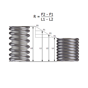

From my view, the blue centering spring is slightly too weak. Since a replacement is $400+, and you can't just get replacement springs, I'm considering disassembling mine, stacking some washers on the spring stop to increase the spring preload in an effort to make it stronger than it is currently.

Sounds like a good experiment. You may also want to try a total spring replacement with a stiffer, non-Kioti spring. Pls report on how it goes.

Exactly, that was my initial thought, but determined that getting an accurate compression rate might be difficult. And easier to just stack some washers...
