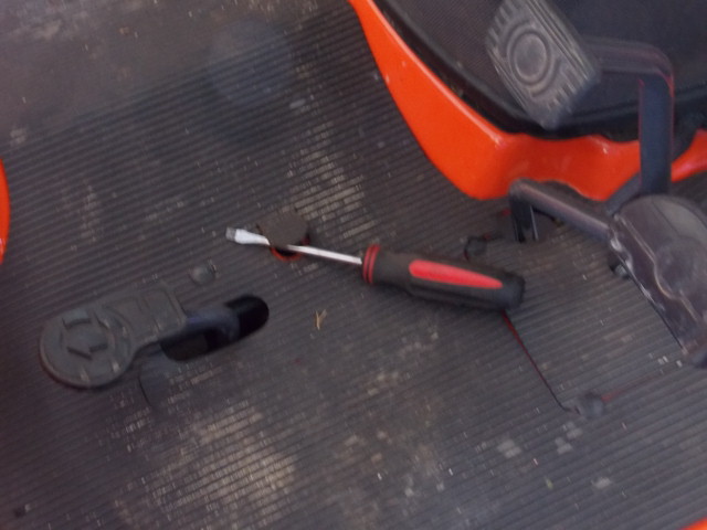

/ HST pedal #12
Here's a pic of where they hide the grease fitting for my BX-25 pedal.
