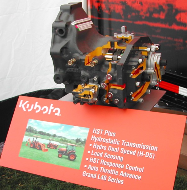

   / HST Question/Concern.... #15
Some HSTs have an electrically-controlled dual-angle swash plate on their hydraulic
MOTOR, e.g. Kubota's HST+, JD's eHydro, etc. I am not aware of such a system on
the tractor's HST PUMP.

   / HST Question/Concern.... #17
Well, I don't know if they're electrically controlled or dual-angle or any of that stuff, but I think most HST pumps in use on tractors these days have a variable swash plate. Yes... in the pumps. But even if the pump were constant volume at a giving input rpm, and the variable swash plate were only in the motor... the resulting output at the wheels would still be subject to the same effect.

   / HST Question/Concern.... #19
All of the tractors that I know of, including the JD eHydro are a variable
displacement pump coupled to a fixed displacement motor.
The "LoadMatch" feature of your eHydro HST is the system that changes the swash plate angle of
the HST drive motor. The computer monitors various things like engine RPM, go-pedal position,
etc, and automatically changes the HST output. On some JDs, you can't even turn this feature off.
New Holland has this feature, too, tho I don't recall the trade name. Kubota's is "HST Plus".
If you have your service manual, look up the LoadMatch info. I don't know if ALL eHydros have
the LoadMatch feature, but it is integral to JD's HST.
