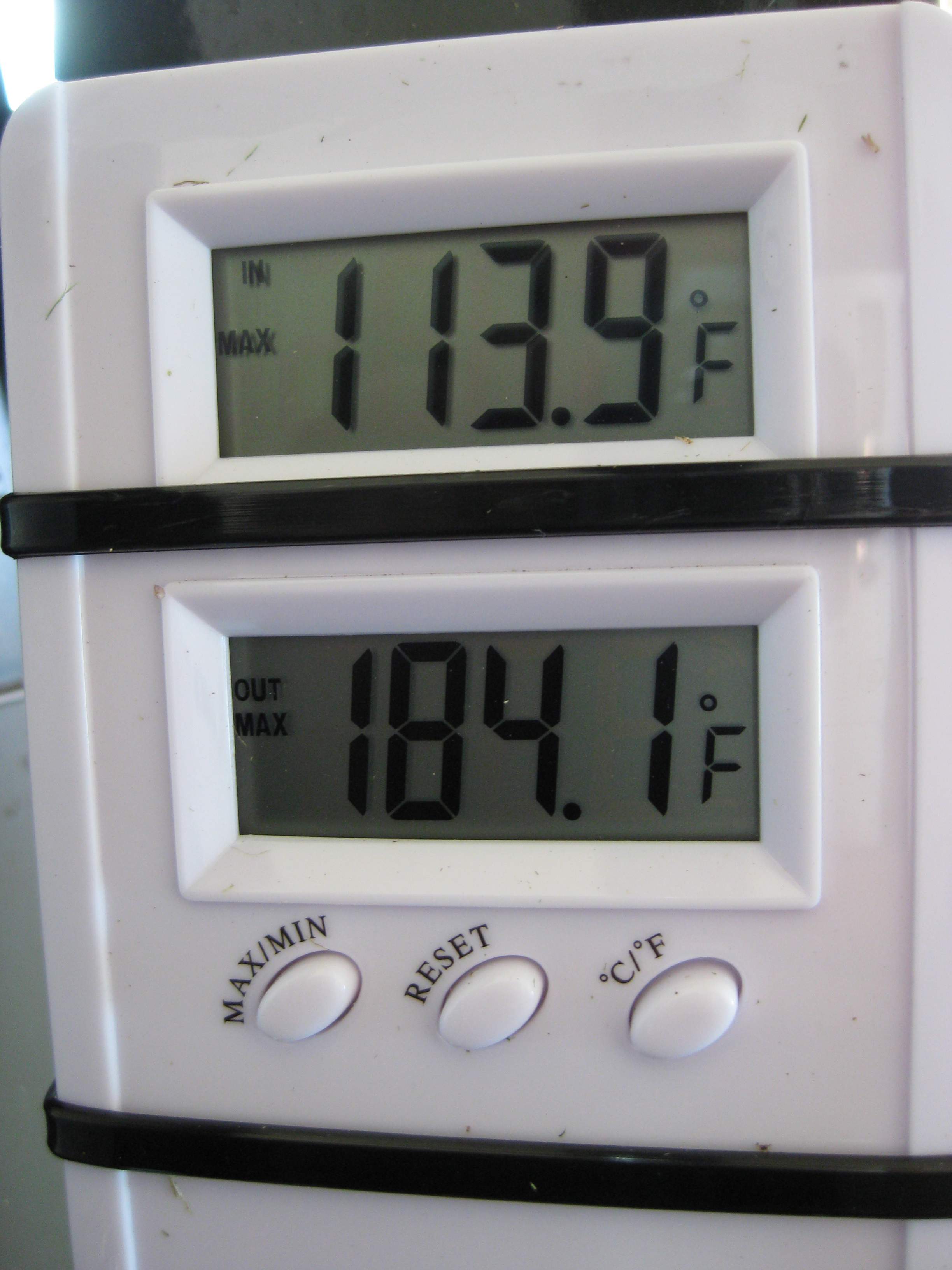

/ HST temp #8
This was last summer ; sunlight temp ( rather than 95f shade )
and trans oil temp ..................
/ HST temp #9
I have the same tractor .. dropped a temp probe down the filler hole and it maxed out at 212. Changed to Amsoil after 50 hrs and got 203 (but on a slightly colder day). Use mine to mow in 4wd low range. So I guess that's what they run at.
