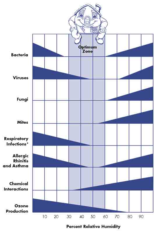

We just built a new house,using open loop geothermal heat/ac. So far this winter the humidity has stayed around 35-40%. Do you all think we need to add humidifier?
This chart might help.
