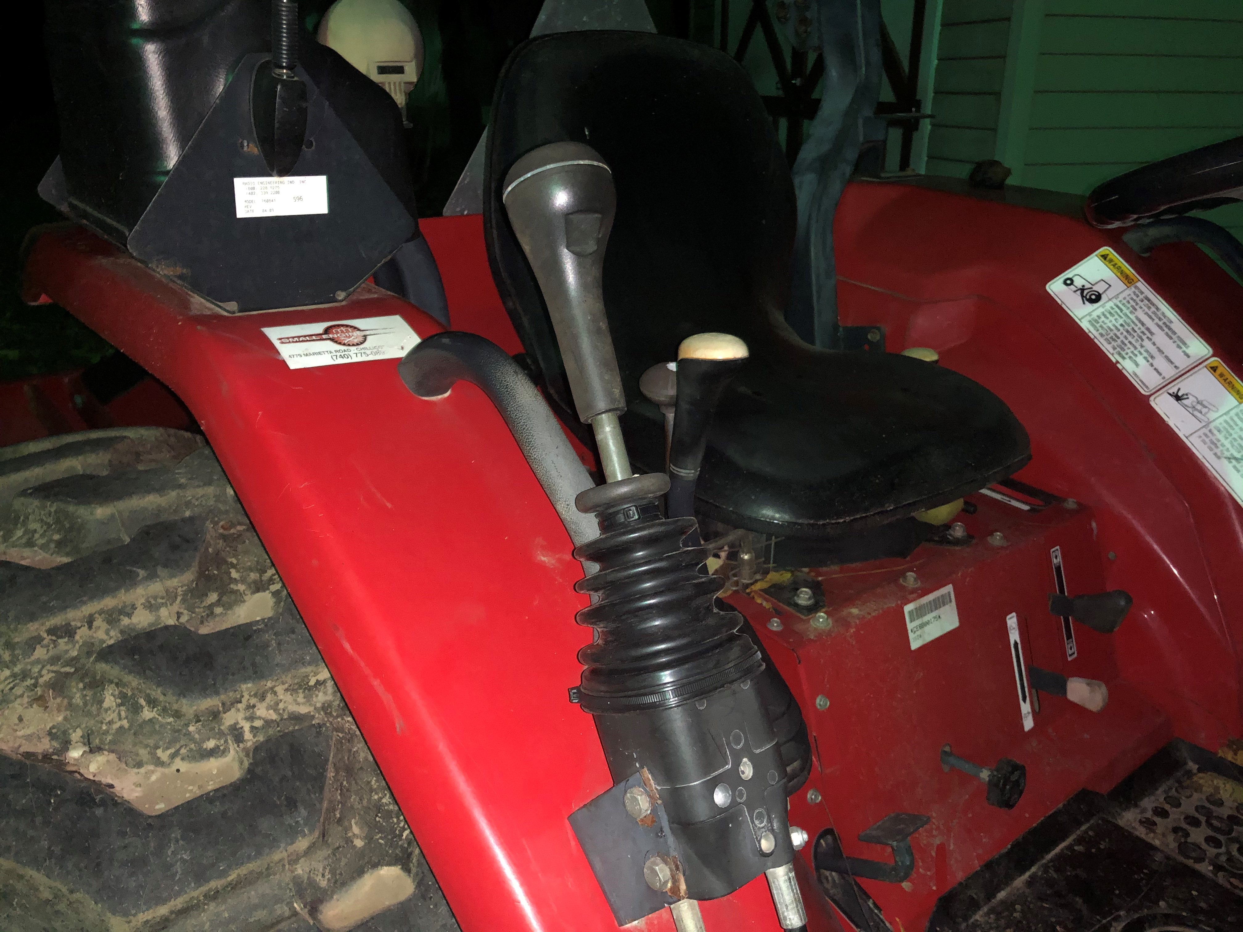

Picture of my CV Boot from a Polaris RZR 1000 XP to replace the FEL boot.
That looks REALLY NICE !
I hadn't considered the possibility of a "boot" that is nominally round at each end being stretched over a nominally "square" joystick box.
(I must have blonde roots - a Duhh moment indeed).

OK, so I broke down and ordered the ATV CV joint boot - from WALMART of all places about $18 with tax.
I'll have it in a couple of days.
Hope to report back favorably.

BLAHH !!!
Walmart's 3rd party vendor (All Balls) sent the wrong parts.
Hopefully I get the right part TODAY !
BTW, I went to ridiculous lengths to measure the squarish control box with rounded corners to get its circumference.
Came out scary close to the spec on the ATV CV Joint boot.
   / Humpolec loader parts - Joy stick.
#24
MANY THANKS to Cen3035 !!!
I finally got the ATV CV joint boot through Walmart and it is *-SO FRIGGIN' PERFECT-* that I don't really "NEED" any securing straps or hose clamps.
Worked with it for a couple of hours the last couple of days and it stays in place nicely, starting to forget that it is even there.
Thanks again cen3035
