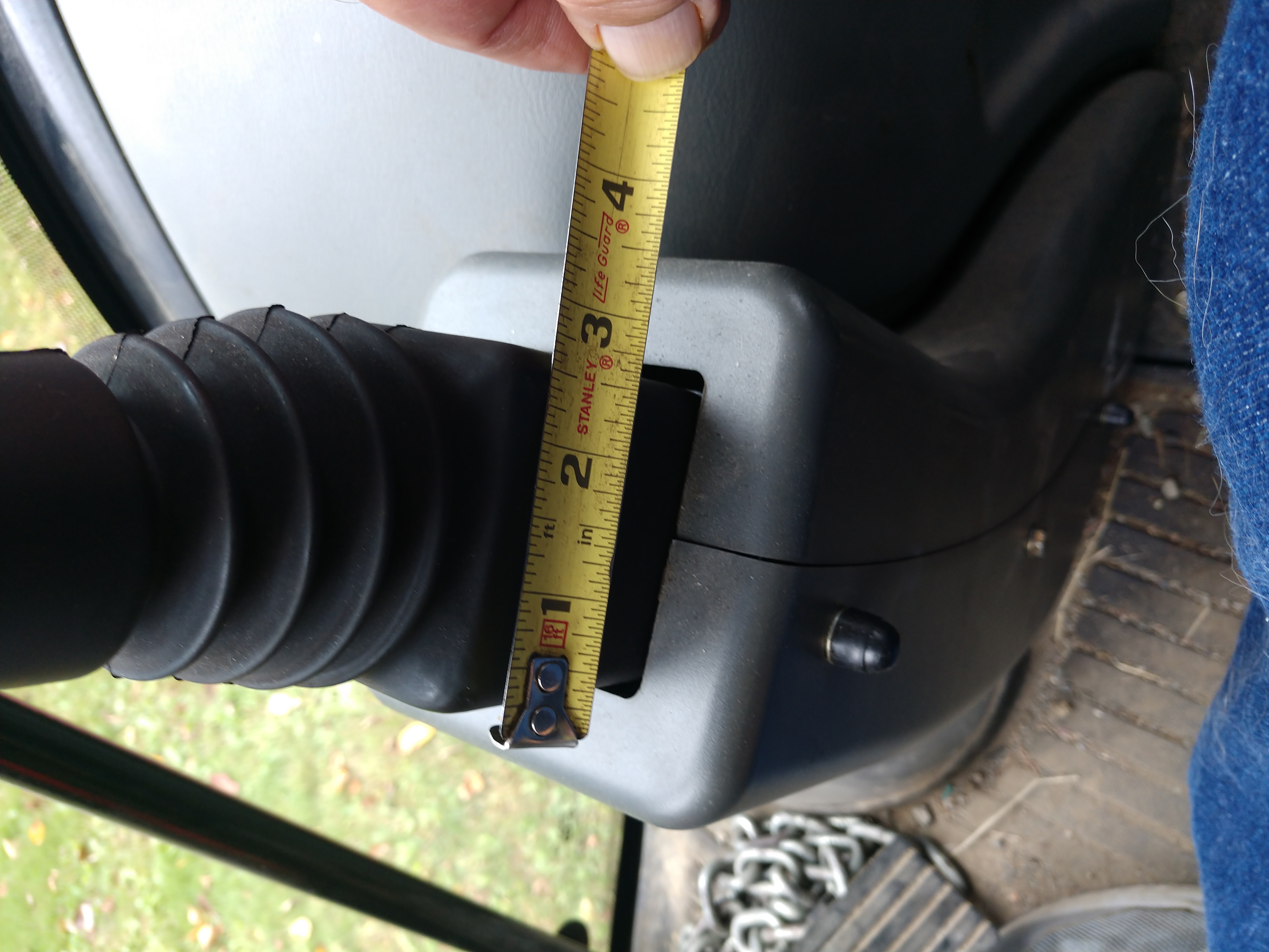

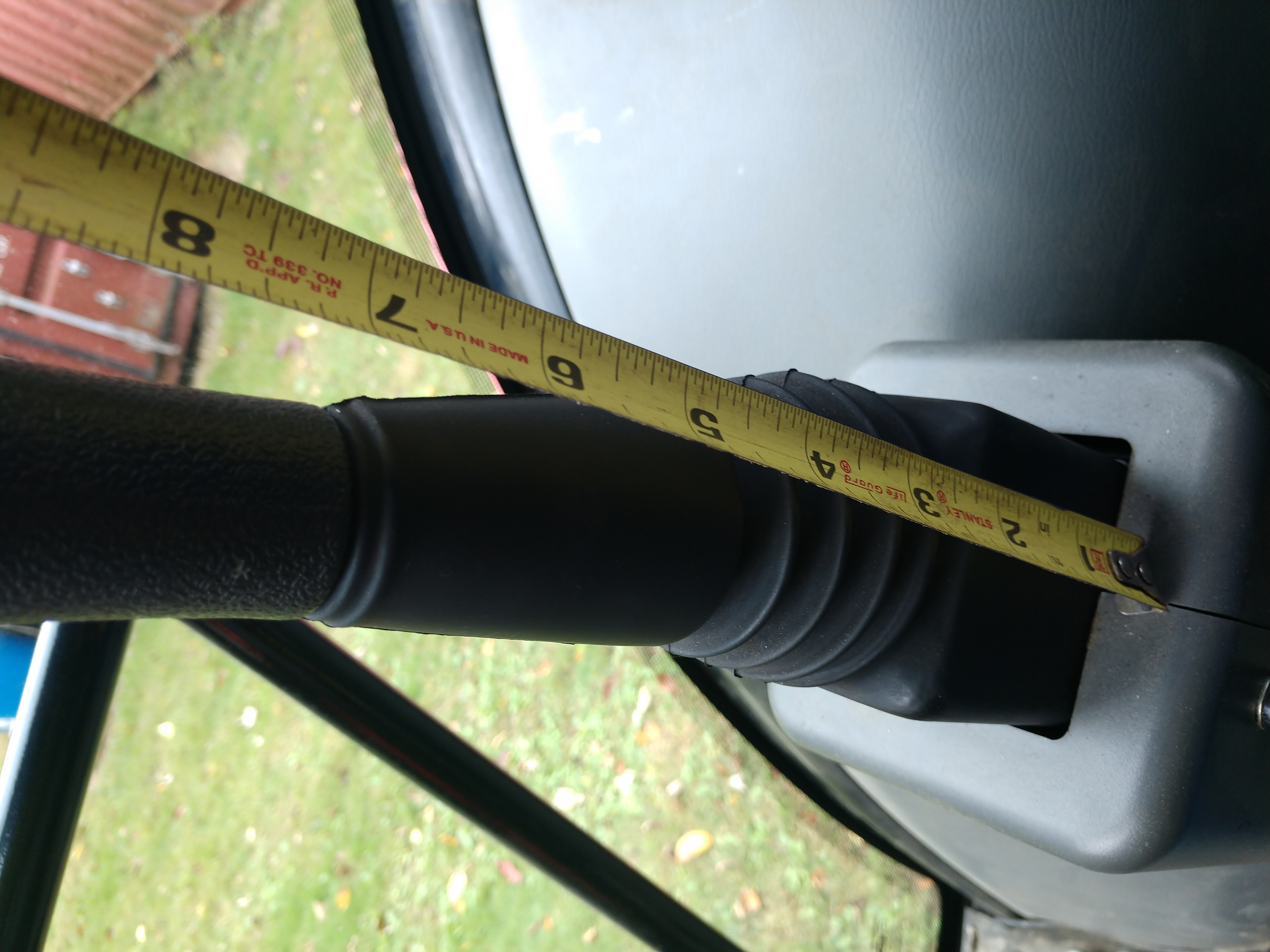

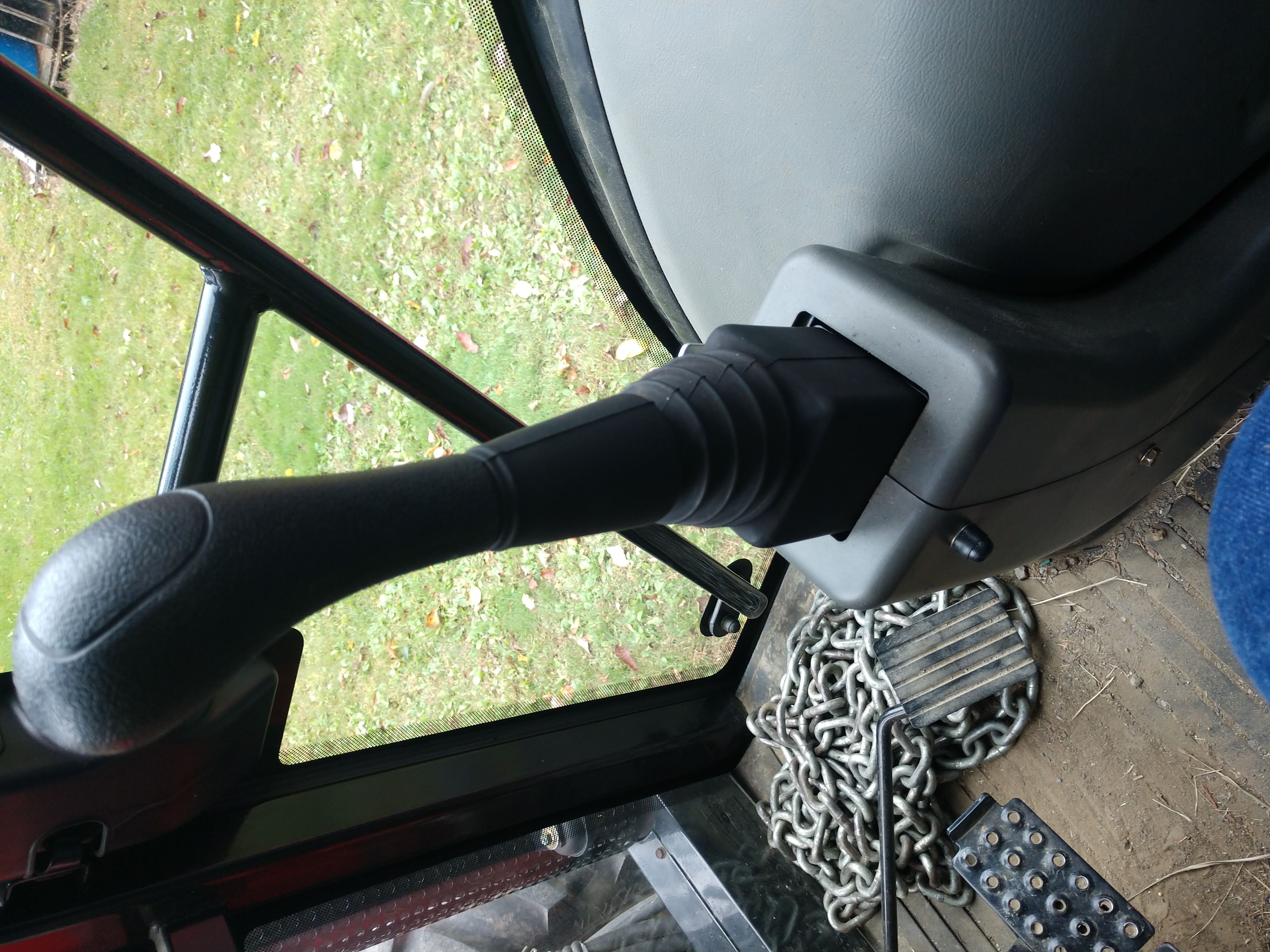

Well I hope the glued up one works good for you.
I can see that you where looking for a square one but What size?
The one on my 8050 is square about 2 1/2" x 2 1/2" about 7 inches tall.
View attachment 623510 View attachment 623511 View attachment 623512
That looks close and from memory the size may be about right.
It is possible/likely that Branson has used the same supplier for 8050 loader controls as for the smaller tractors.
2 1/4' square sticks in my memory, but the tractor is about 15 miles from home right now.

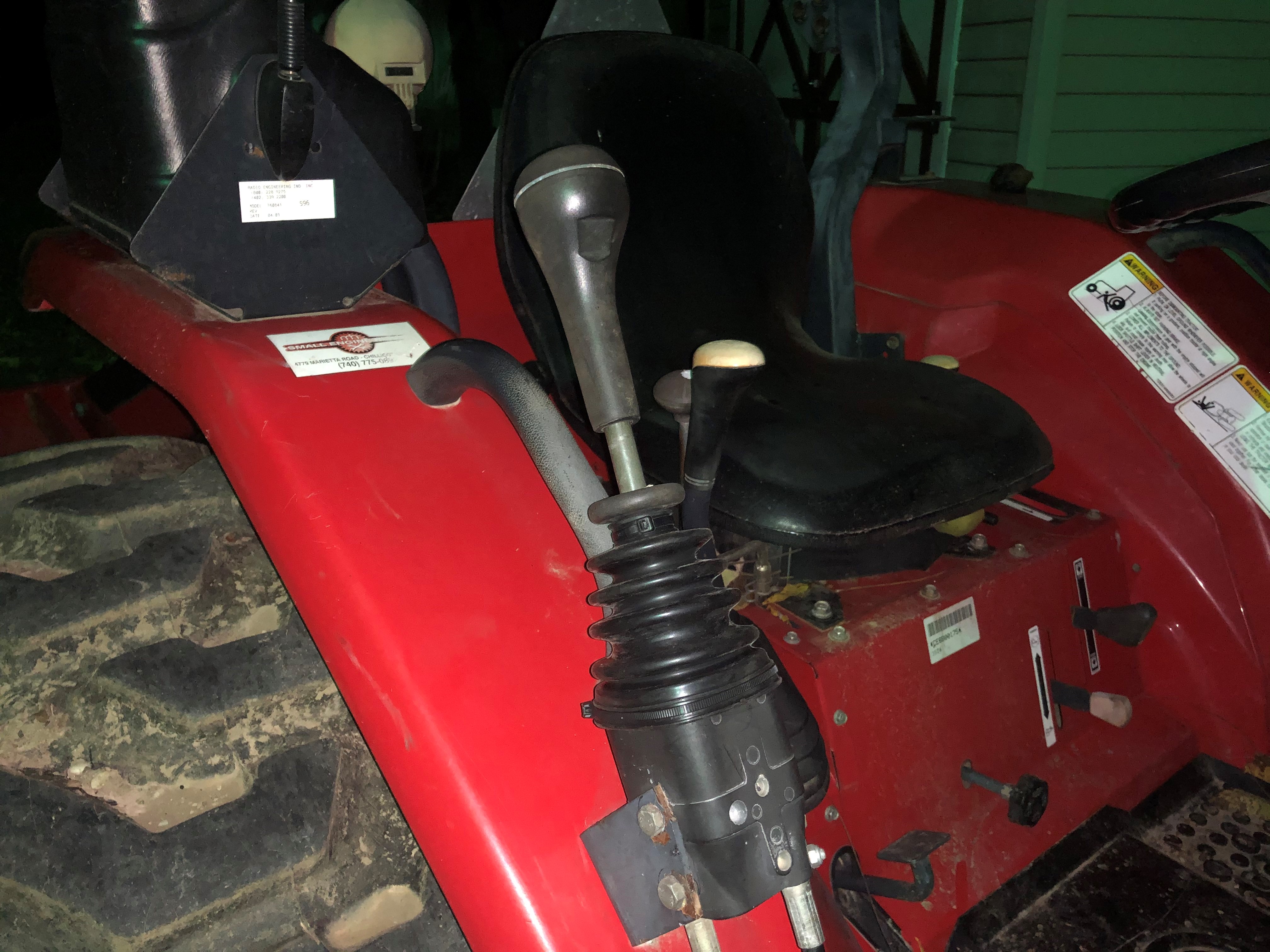

I have a Century 3035 that needs a new FEL Joystick Boot. They are available from Zetor (P/N M001946) as they used the same loader on some of their tractors. It is a bit pricey at around $56. I am going to try an ATV CV Boot. I found one from All Balls that should work if it will stretch a bit, it is P/N 19-5022 and costs around $14. They have a couple of universal fit boots also, but I have not been able to find the sizes for them so I have an inquiry into them for the ID of the two openings, will update when I get that info. This should hold up to the weather just fine as they are made to take a beating in mud, water, snow, etc.
   / Humpolec loader parts - Joy stick. #17
Picture of my CV Boot from a Polaris RZR 1000 XP to replace the FEL boot.
   / Humpolec loader parts - Joy stick. #19
Looks great! Thanks so much for sharing what you found to work and posting the part numbers as well. I am going to pick up one of these CV Boots as soon as I can to fix mine.
