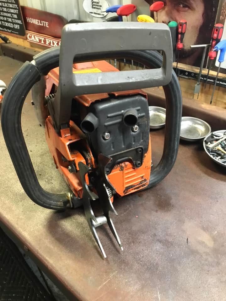

How to reset chain brake on 395xp? Found one video on u tube but enough info to make tool. Made tool but could not get it to set. The new models are different.

I have not noticed that it works drastically different than my other saws. Maybe a bit stiffer. Did you trip the brake off the saw or on it?
   / husqvarna 395xp #4
No tool for older 394 395 design I know of. The tool and one you make was for later ones like on 346 etc.
One that I do since easy for me. I just remove the clutch and drum from saw. Put on cover and reset.
If you dont want to do that. Put you cover in a vise and reset. Use wood etc to keep from marring.

I am familiar with the reset using a screnwrench modified to fit the reset and the tool husqv. sells for the saws with the chain brake on the block. The older saws the chain brake is on-in, the other cover. I have not reached a live person to talk to at husqv. The computer talk is a waste of time in my opinion, it is not real. The one on You Tube video does not give enough details, may be a husqv repair- sales. I have tried the tool I made, and HD clamps to rest. May be I am not pulling hard enough

I reread your post and understand what your saying. Do you use spacers or any items to tighten the cover on too?
   / husqvarna 395xp #7
XYZ123.
Nope, never had to on any cover that has come in.
