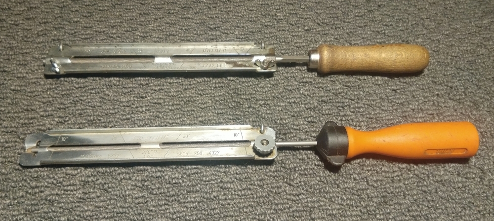

I've used hand files, dremels, and carbide burs to sharpen my chains over the years. When I hand file, I use the guides like the OP has. If I don't I've found that I have a tendency to let the file go a little too deep. It produces a really sharp edge, but the edge dulls pretty quick. Those guides ride on the top plate and keep me from making that mistake.

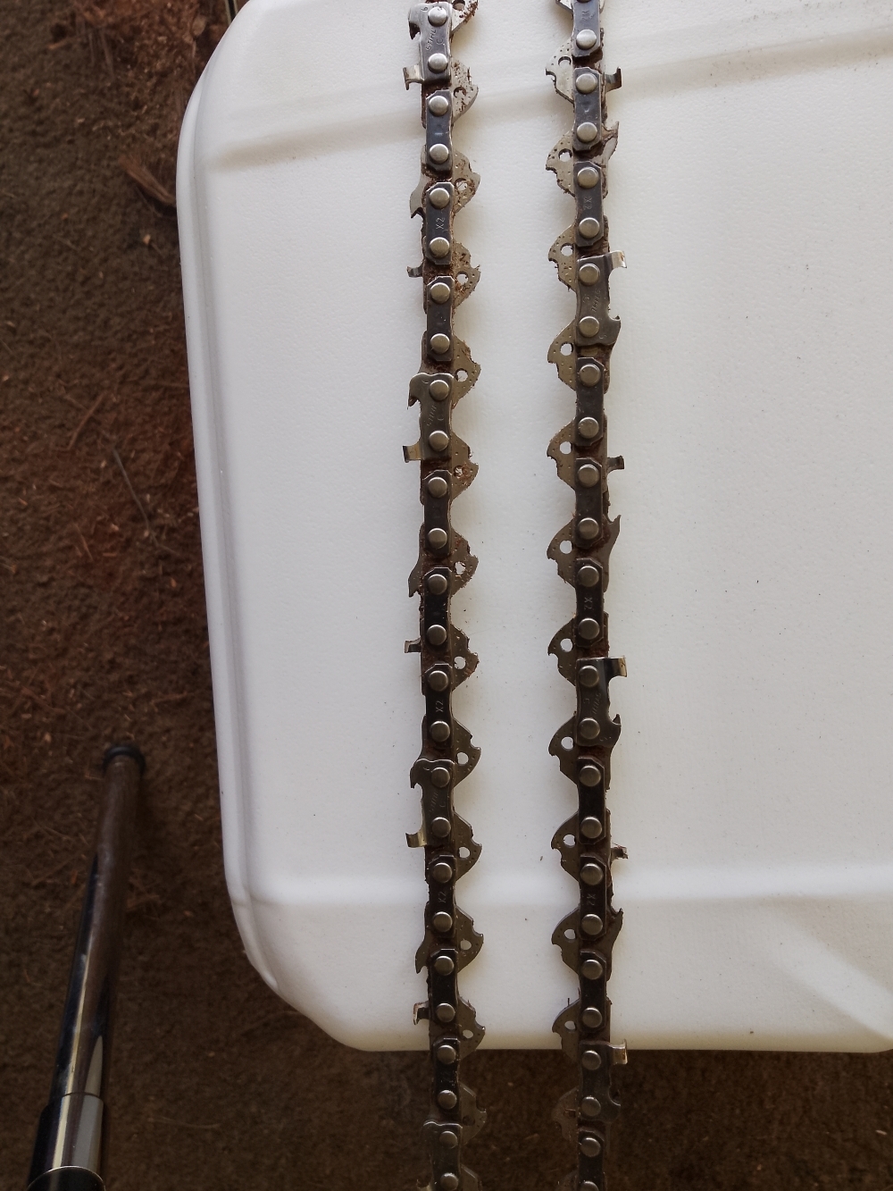

You touch more saws and chain that probably any of us, so you definitely have better methods worked out from sheer repetition. But for a DIY'er / home user, I'm cutting a crap-ton of wood, 10-20 cords per year. This makes my time a big factor in each step of the operation.
So, excepting some very rare case of one tooth somehow way shorter than the rest, I simply eyeball the shortest cutter I can find (quickly check with dial calipers) when setting up a chain on the grinder. Then I set the grinder to that tooth, and just knock all of them back to that same length. I find that faster than re-adjusting the grinder for a few teeth that are of different length than the rest.
If there were a chain where just one or two that are way shorter than the rest, I guess I'd do them individually, but otherwise I find it faster to just set all the same.
See if I did that on some of these guys chains that would take a basically newer chain and take it back at least a 1/3 of it's life. Not worth it to do that to their chain.
Then you have several passes so not to over heat cutters with a big bite.
You just want to kiss the cutters.
Can have most chains done on grinder with adjustments, with rakers done in 10min range give or take so isnt really a time thing IMHO.
Not going to waste a guys chain like that being lazy IMHO.
Most chains I would say 90% are the normal way. Start with shortest and rest right there with it. Do all the same.

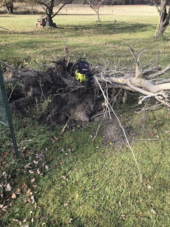

I used to live by the file it down until there’s teeth broken off or looks like a triangle. Then I cut into a rock that the tree grew around and carried with. Tooth didn’t break off it straightened out and the next time it came around kicked back so hard the handle got broken off and I got 18 stitches, 9 in 9 out across my knee. So now I live by the 1/3 of tooth left is scrap metal.

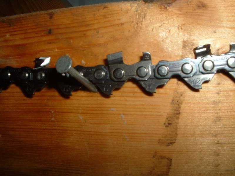

All the chains that I use have a scribe line on them, When the cutter gets to that line I toss it. Cutters breaking off chain is not something I want to be around.
YUP!
See that line off to the right. (not where the arrow points) That's the trigger to toss the chain in the "just for roots" bin.
