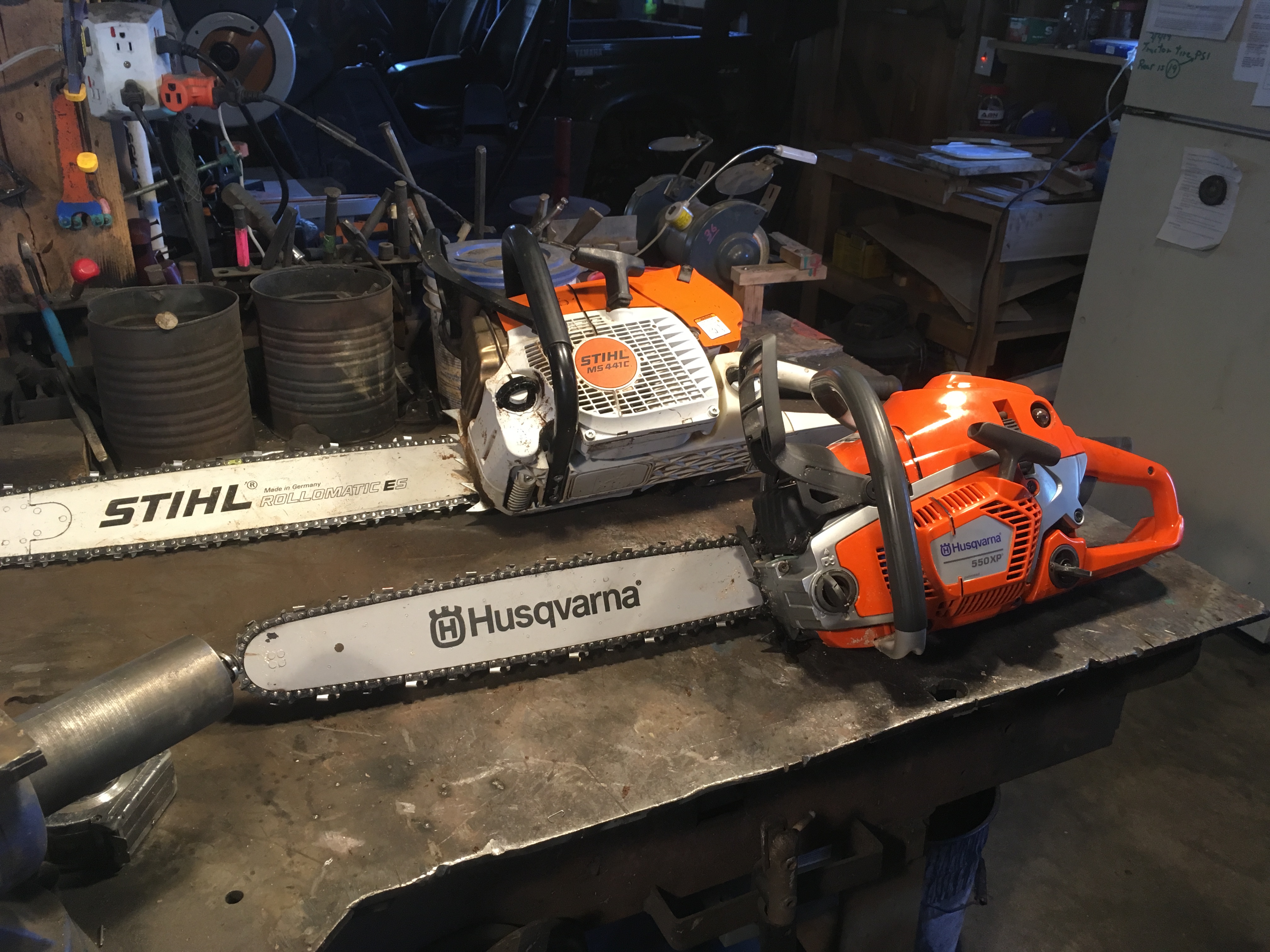

Flip up fuel caps, fast becoming a fan, but what saw came up with that idea first? My sons Stihl is two years old and he likes the flip caps, so I put them side by side to see the flipping cap difference. The verdict is in, Husky has a far better flip cap, easy up, spring loaded so it easily flips back down. The Stilh I broke my flipping finger nail flipping the flipping flip cap up because it flips a little harder and not spring loaded.
Why'd they come up with "flip caps"? Never could understand the need. Never had trouble with the regular caps and take them off with gloves on.
   / Husqvarna 550xp repaired-ish #92
Husky flip caps got it right. Still screw in. Not some over engineered crap.
Huskys you can run regular caps or the flip caps. Well thought out IMHO and owners choice. Not forced on you.
The flip cap is lot easier to open, I've had times when I had to use wrench to open, one reason why theres always a place to put the a wrench in the cap. If you got a husky see if a new flip cap will fit your saw, try it you'll like it.
