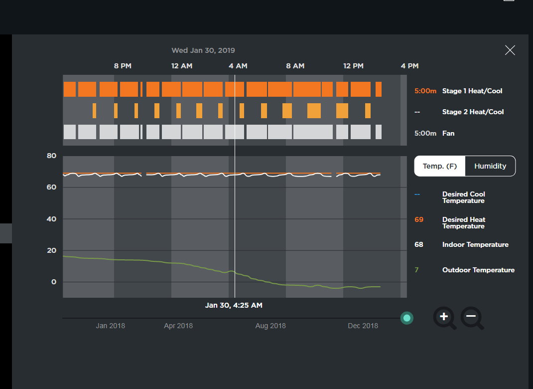

Hows everyones system handling the cold?
My 4-ton geo unit is hanging in there. No backup. My system was set to kick the second stage on if its on first stage for more than an hour and not been satisfied. But its a "smart" stat with a "learning algorithm" meaning that it wont necessarily kick second stage on if it knows first stage is real close after than hour.
Second stage has been having some work to do this past 12hrs or so sub zero temps.
But until the second stage is running darn near 24/7.....I dont think I have to worry about having a cold house:thumbsup:
