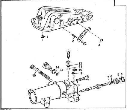

Yes oil must travel through pressure control valve to get to RS valves
Ok, I took off the pressure control valve. Took apart and cleaned, it all looked good, replaced 4 oil rings and reinstalled. When i put back on the SCV I replaced the 3'' hose(temporary) with a clear one so i could see flow going tho it instead of it being loose and dumping in a bucket like i did before. I started tractor and still don't have flow, very, very slow and not even filling the hose. I do have power steering but only after the tractor warms up some. Any ideas what i need to check next? The screen is clean on this tractor with JD high dollar fluid ($75, 5gal)

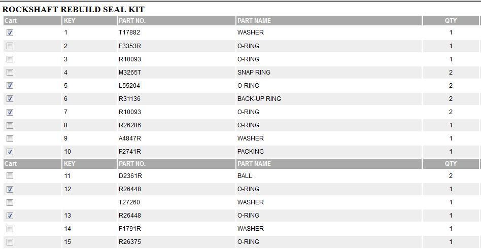

Remove rs and replace o-rings and back-up rings. Replace and do settings !
Its funny u would think there would be some type of o ring kit for this but when i went to JD place they showed me diagram and said they would have to go though the parts list and get items. By the way a good gage is expensive so is it worth spending the money if only use a few times.

   / hyd problem on jd2030 #35
A hyd gauge to help diagnose problems will save you money on parts. Yes a few yrs back JD had a RS valve overhaul kit but now one has to look up each individual parts.

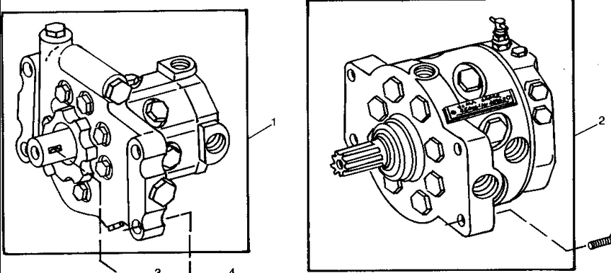

Got my gage in today to check pressure. U said to hook it up on front of pump. I don't see a place to hook up. There's the inlet and outlet flare fittings and then the flare fitting on the right side thats going to the pressure control valve. there is a small flare fitting on the left side between the mounting bolts. I hooked it up there and got no pressure at all.
DLTTrekkers, I took out the small fittings under gears but cant find a way to hook my gage in it, my gage threads is to large for it.
   / hyd problem on jd2030 #38
Which pump does your tractor have?

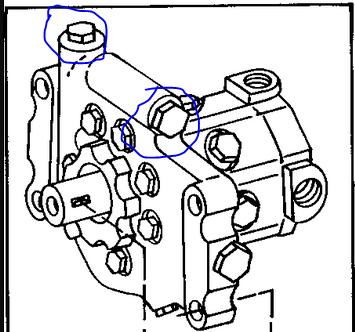

   / hyd problem on jd2030 #40
IIRC one can test pressure at either orifice outlined inblue
