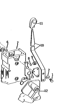

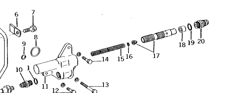

When I put new O rings in pressure valve I didn't see anything wrong in there. It was clean, spring looked good. I don't see how that can mess up. How do I diagnose that.
Ok this is what I did, I took off the pressure control valve outlet line going to the SCV. I put my gage on the line and started tractor. The gage read 1900# just like at the pump, so my thinking is the PCV is working correctly, you tell me if i'm wrong here.
Then I took my coupler off tractor, (I only have 2 hose connections). I connected my gage to one line and blocked off other line and started tractor, I had 1900# at gage when i worked lever. I then took of gage and put on other line and blanked off other line like before and started tractor, I don't have no pressure out of that line. Is my SCV bad or needs adjustment? Keep in mind I just bought this and its been rebuilt by a good company. Any suggestions?
