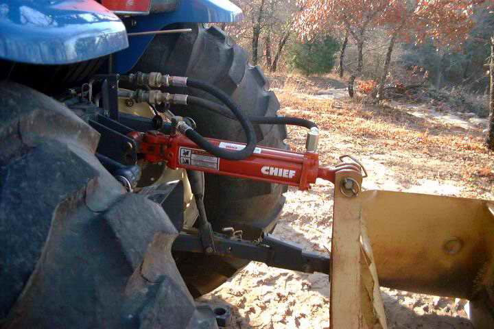

picture of the connection of the hoses. They hang down a bit; I'll need to do something about that this spring, but they're fine for snow-blowing.

Mark, your picture didn't make it. Are you hooking in where the FEL normally connects (under the front of the floorboard)? Anxious to see /w3tcompact/icons/smile.gif
/ Hyd. Top Link - $150
#27
Sorry about that... missed the fact that it didn't show. [image]/w3tcompact/icons/hmm.gif[/image] But, yes, I'm simply hooking right into the FEL ports.
This picture shows them hanfing down more than they do now. I pulled some of the slack back to the cylinder, them tied them.
/ Hyd. Top Link - $150 #28
With your hoses and quick connects you have duplicated what John Deere offers as another rear remote option for the JD790. The only differents is that they use 2 90 degree elbows (you only used 1) coming off the quick connect to get the hoses up under the tractor. Looks good and a inexpensive way to get TNT. I went the way of adding the rear auxiliary remote kit ($160) and then a 3 valve control, hoses and quick connects, and 3 cylinders to get mine.

<font color=blue>they use 2 90 degree elbows</font color=blue>
I like that idea. I've been wondering how to pull that up closer to the machine/w3tcompact/icons/cool.gif.
I remember talking to you before about how you did yours ($$$); that was a big part of the reason I went this route. Remember, though, I only got Top, no tilt.
