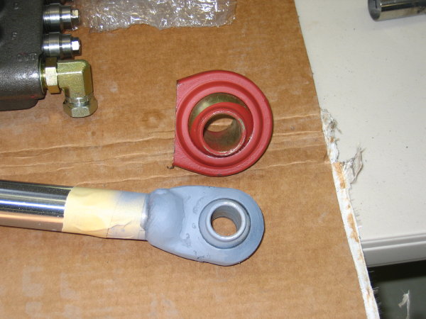

Well, after listening to some your recommendations, and getting up a little courage, I decided to modify the Cat 2 end. I cut it off and welded on a new Cat 1 ball joint I purchased. I think I will be happier with this solution. I am just about done with the entire project. As many others have done, I did a complete photo documentary. I probably will not post as this has been done in very nice fashion by many others. However I will take a finished shot when it's all complete. Here are a few of the cylinder modification. First is cutting off the end...after getting my guts up.

Here is what I ended up with...after welding and with a coat of primer. Not the prettiest thing, but you can see the difference in size. I hope it works. More later.
