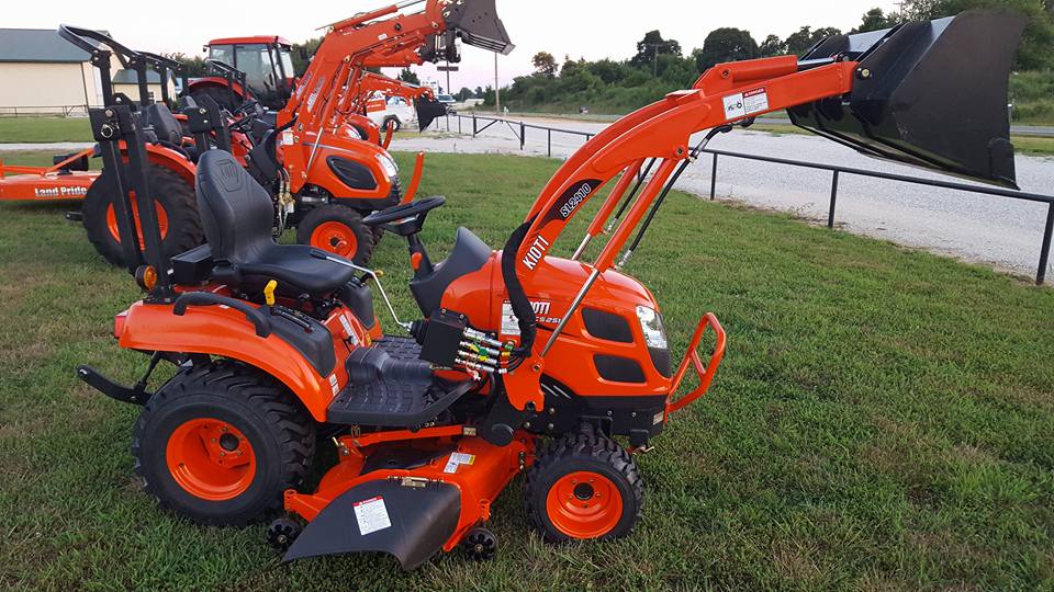

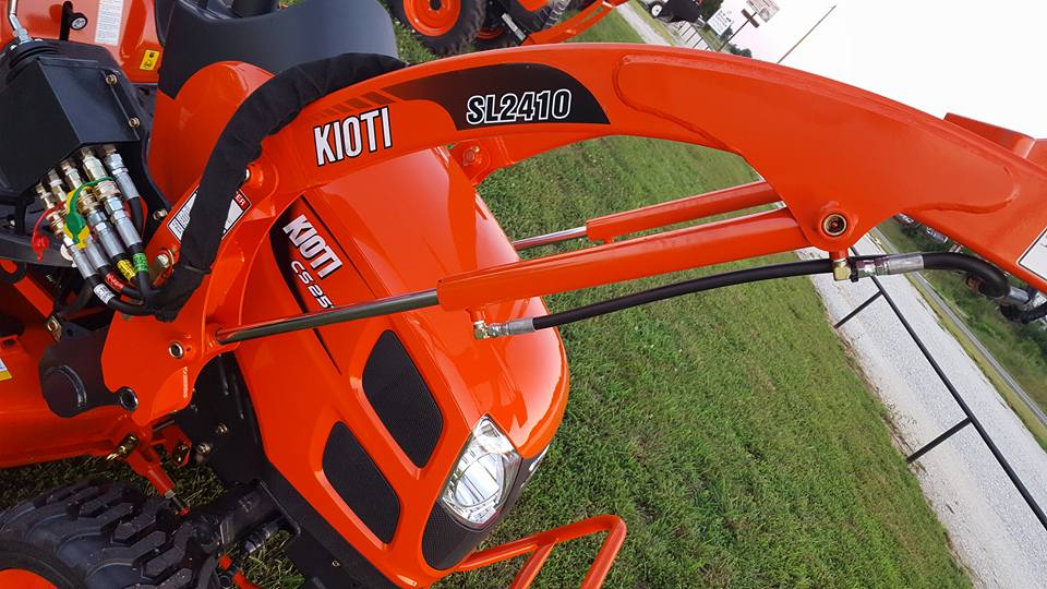

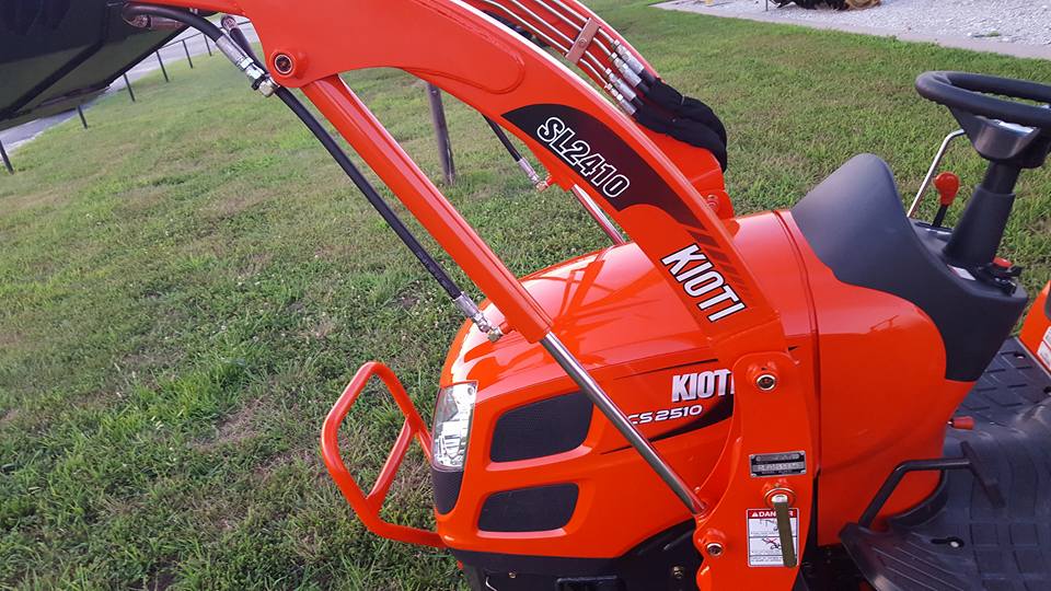

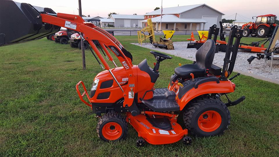

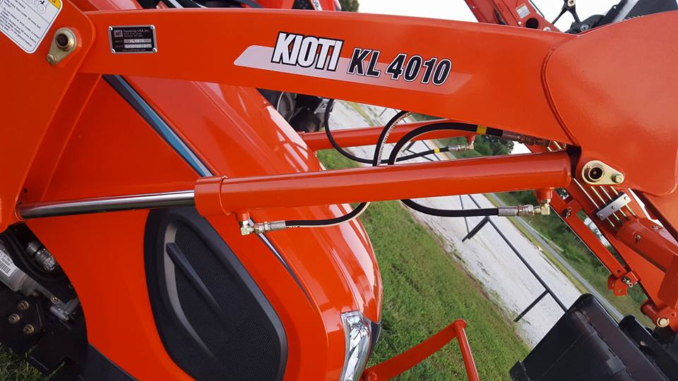

Went down the road to tractor dealer and miced up some cylinders. Here is what I found. The itty bitty one...lawn mower with loader...LOL had about the same size cylinder that mine has....what a joke. loader3.jpg loader4.jpg. The 40 and 50 horse ones had bigger ones like should have been put on my loader. Mine is 40 hp. loader1.jpg loader5.jpg loader2.jpg

I looked around a little and my loader has 2.36 bore. My loader is for 42 to 57 hp running with max 2630 psi. The loader one size down has 1.97 bore and that is for 32 to 39 hp running with 2560 max psi.. I did not find the rod size, but I would say they are over 1". What size are the rods in yours?
If you cyls are under 2" I would be making a phone call. With the relief set right, no spick, and the right cyls I'm just having a hard time understanding how that would happen. When you find out please post back.

Checked the cylinders on my K2 ( 55 hp tractor)( similar to the 220) Koyker and they are just under 3 inches o.d. the rods are 1.5 inch o.d. and are about 32" in compressed length.
from the pictures it looks like the rod size is under 1 inch.
