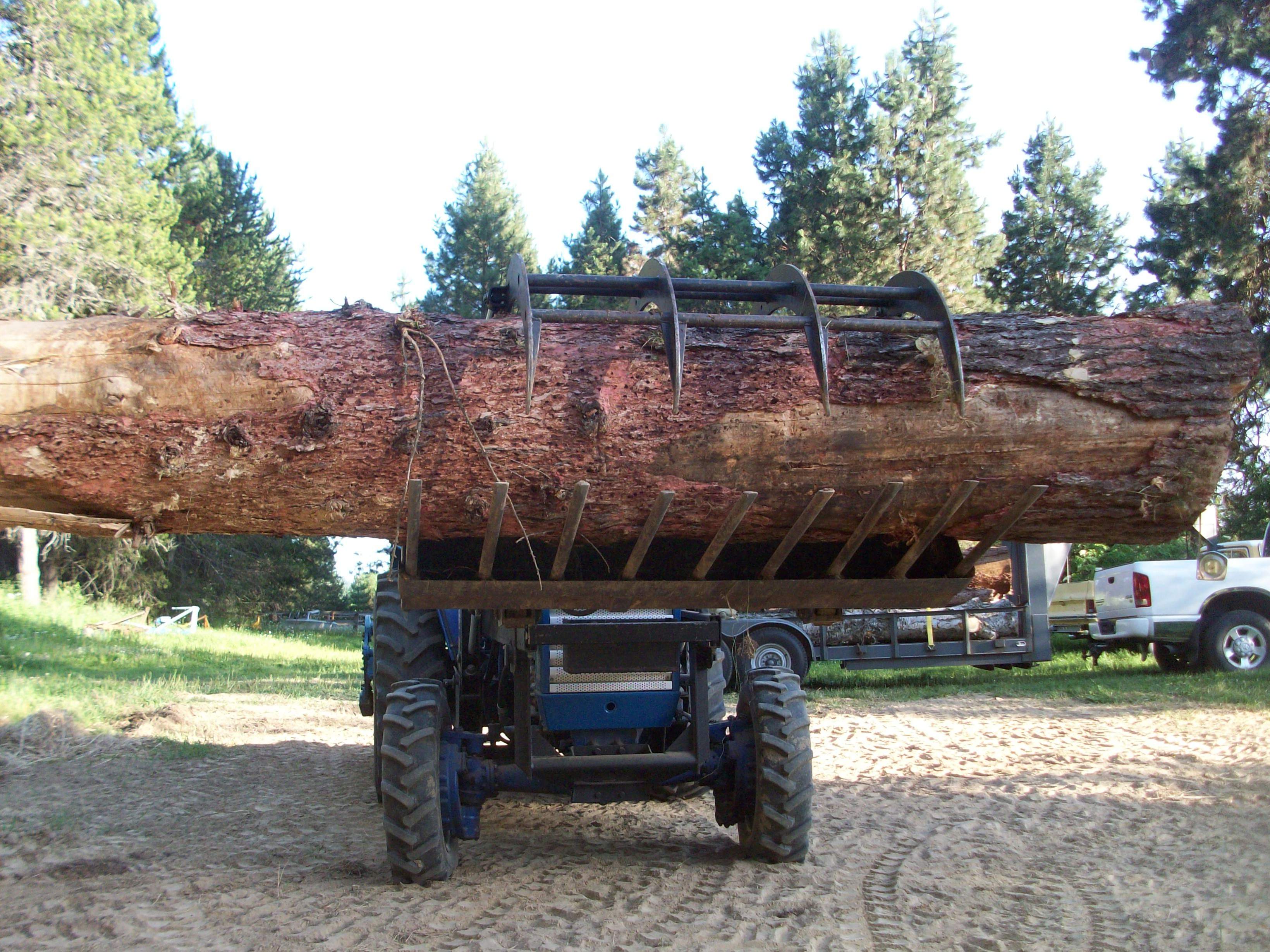

I miced up the shaft and cylinders on mine as well. It has a 1 3/4 bore with a 1" shaft. It came on the tractor when I bought it with 42 hours. It has around 100 now. I bought some online last night I am going to make them work I hope.....with a 1.5" shaft. All I can say is..............
KOYKER LOADERS...made in the USA with cheap china parts....LOL
All I can say is my chinese tractor works very well with a Koyker loader and it's lift capacity has been adequate so far
That 1.5" shaft should be plent-y it is the same size as what my K2 has

Looks like the rods in those bent cylinders were way too long for the dia. Looks like several inches never went inside the cylinder. Someone designed them special so they'd bend easily. You should do great with your new cylinders if you can keep the back tires on the ground. :)
   / Hydraul Cylinders on Koyker 165 Loader
#29
Yeah I have BIG wheel weights on the back wheels so should be fine....LOL
   / Hydraul Cylinders on Koyker 165 Loader #30
I would want some hefty weight BEHIND the axle as well
