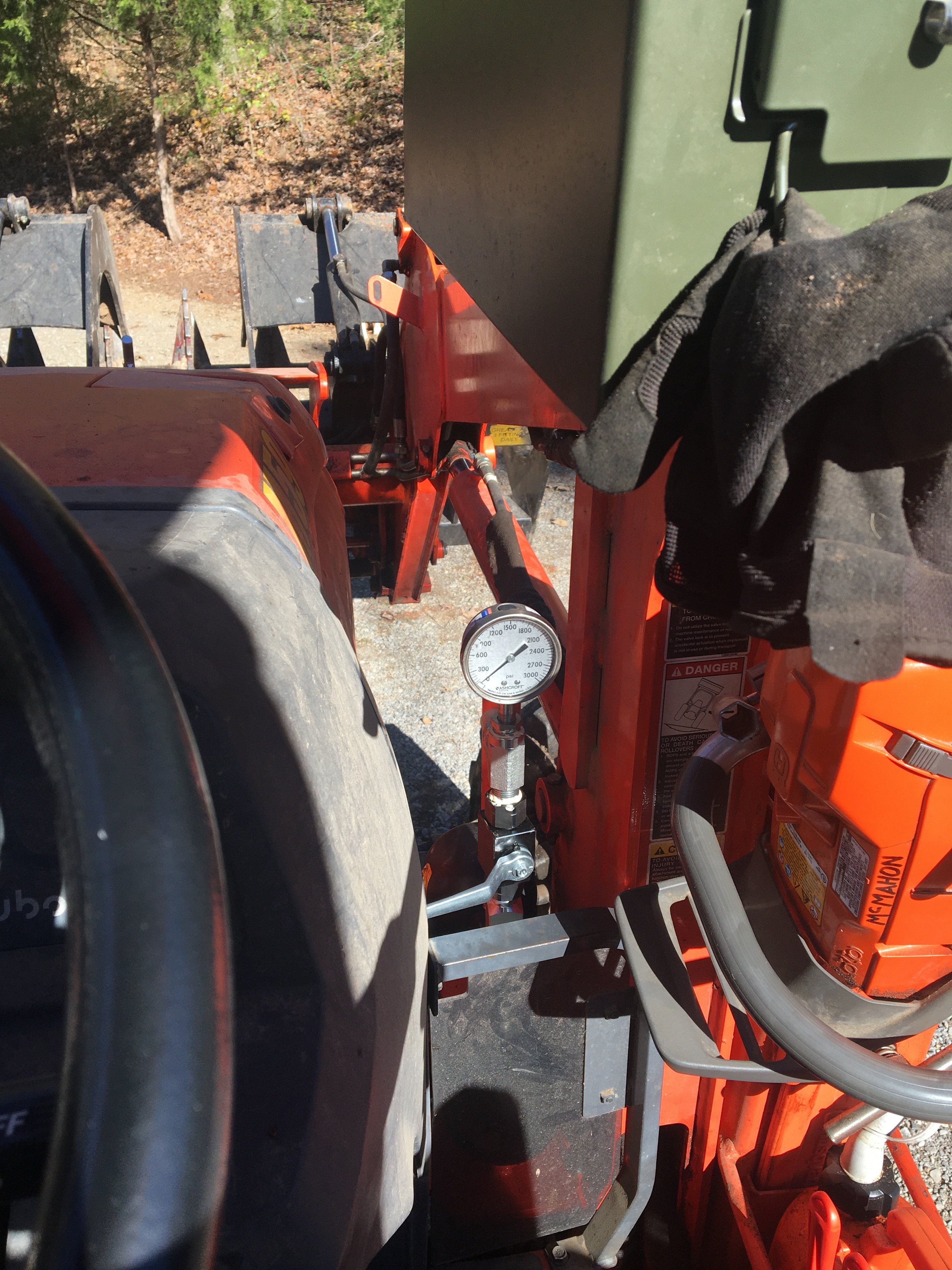

Do you guys have on/off valves installed so you can turn the suspension on and off? The bigger Deere tractors all have this as an option including a control switch in the cab.
Ball valve below the gauge.

Ball valve for both of mine. I would have loved to go with an electric solenoid valve and a switch in the cab but that added complexity in wiring especially since my loader is quick attach and I do remove it sometimes.
