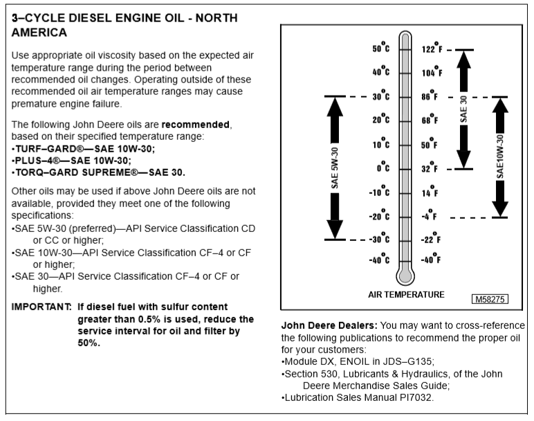

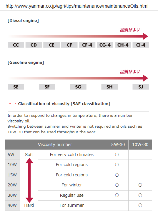

Sure, the old Yanmar specs called out things and they back tracked and made corrections. rScotty proved that time and again. Yanmar and John Deere worked out the bugs with the 15W40 not being ideal with the 3-cly compacts. They did settle more inline with the 10W30 and 5W30 oils. I too changed and notice much less soot out the exhaust before the engine fully warmed up.

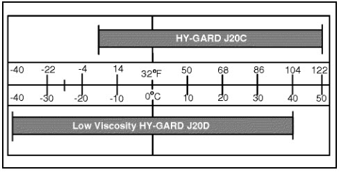

Hydraulics

California,
Thanks! Rip Van Winkle here, I hadn't seen this updated advice from Deere and Yanmar.
But that chart doesn't allow multigrade oil above 86F. Doesn't that imply that 15W40 would be preferable for operation that includes running hard in summer heat?

California, The upper temps in the engine oil charts only make sense for AIR COOLED engiines. Alll water cooled engines see about 212 F as set by temperature difference between oil and cooling water set by 190 F thermostat.
SAE30 does all that. 40 isn't there.
