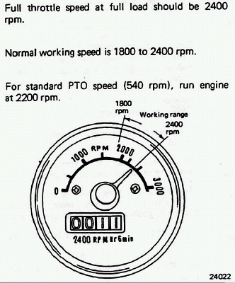

But that Benz isn't typical of tractor rpm's. From my Operator's Manual:
ym240tach-gif.60240

I measured this fuel economy credit on a 240D Benz with high mileage on it. Typically, it would be at around 3,000 rpm, much like a tractor engine at 540 PTO speed.
