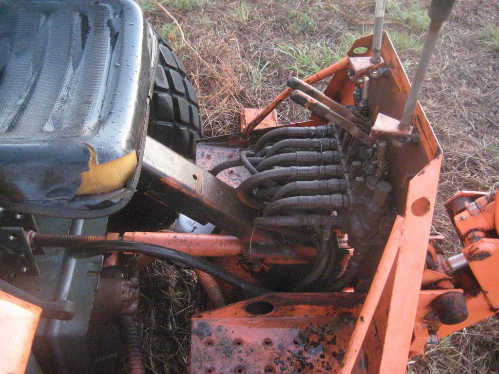

The backhoe indeed has its own pump, which is attached to the PTO with two hoses. One house goes to the backhoe filter, the other goes to the backhoe main valve.
When I operate the backhoe, I see the PTO shaft turning, which I assume is what generates the hydraulic pressure to lift and turn the bucket, but what do I know - I might mis-interpret things.
I included two more attachments that hopefully clarify the setup. One showing the backhoe (with the panel off, showing the hoses) and the other showing the main hydraulics pump feeding the front loader, which works fine) and showing the lines that go to the back - to the rear hydraulics.
I do have the manuals (for the tractor and for the backhoe). They describe the parts and the installation, but don't quite answer my question. I can scan the relevant pages and post here, if that would help.
Is it possible that once I disconnect the backhoe pump from the PTO, that the pressure will come back and I will be able to raise and lower my implements?
Can I just simply disconnect these hoses coming from the backhoe to the backhoe pump. As in - is this a safe thing to do with the tractor turned off or do I need to be worried about the pressure of the oil in those hoses?

If the backhoe is self contained with the pto pump (thats what I observed so far) I would remove it to get it out of the way. Then check the linkage from the rockshaft control lever to the rockshaft valve, make sure the linkage is hooked up, as the poster did say that there was no resistance in the lever. Could be the linkage was disconnected to prevent the arms from raising up and interfering or damaging the backhoe mounting. Just a thought.
kenstrack, you are right, reading the thread from the beginning and seeing the pto pump I was humored. Gotta look at the pictures!

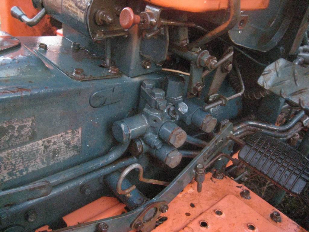

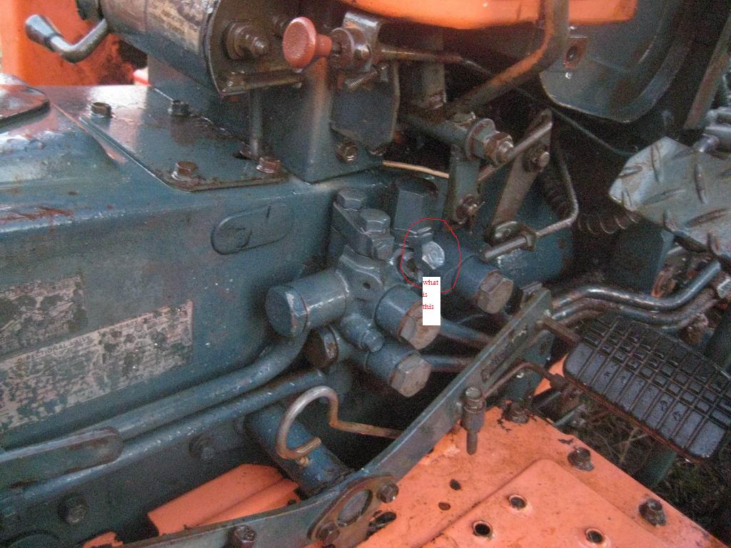

Is this a directional control valve?
   / Hydraulic arms not moving? #16
Sure looks like it.
Generally those twist valves have a 90 degree sweep and they are typically used to turn flow off for the loader when it is disconnected from the tractor.
My old heston has a valve at the back near the lift that is used to adjust "up" response as opposed to the one generally between your feet below the seat that adjusts "down" response.
On the up response valve, it is possible to have it cranked so low that the lift will not rise even without a load on it. If your tractor has one of these, this could be the issue. The fixture on this valve is a threaded cap with a slot in it for a LARGE screw driver. I use it to slow down the lift response for a light implement such that I can get smooth "up" motion as opposed to jerking motion. The trick is to tune the valve to the weight and functionality of the specific implement.
to clarify on the auxiliary HYD point I made earlier, the example I give is as follows: When I am running my splitter off the aux hyd ports at the back of my tractor, which are valved by a control lever at the seat, I bungee the lever in one direction or the other such that the valve on the splitter gets a constant flow. In order to lift the splitter with the TPH, the aux hyd valve has to be back in the neutral position or the lift will not get flow.
If I use the loader power beyond circuit, (I have both circuits plumber to the back of the tractor) this is not an issue. However once again only one circuit choice can be pressurized at a time.
   / Hydraulic arms not moving? #17
Definitely not a pump.
I believe this to be a selector/control valve, used to route hyd fluid to the front, rear, or both . I have something similar on my Kubota. Try turning the valve one way o the other. A gage would be a big help

If your backhoe uses a PTO hydro pump, then it is like my neighbors Kubota. The 3 point mount for the backhoe will not allow movement of the tractors three point hydro arms. Actually is very hard on system to move 3 point lever with backhoe attached. Take backhoe off first.
   / Hydraulic arms not moving? #19
Correct. Remove backhoe, and connect loose male to loose female, and your 3PT should work.
   / Hydraulic arms not moving? #20
Like it was said 2 or 3 times, this is a stand alone BH.

The 3 bolts that have no paint on them were added when the loader was put on. I would guess the BH at the same time. They disabled the 3pt and took all lift link and arms off... You trouble is in the hydraulic block. turn that bolt in. The one thing I don't understand is the loader valve seems to have a PB line feeding the 3 pt. IF so there might of been no reason to unscrew that bolt. That should be in the manual, but hard to understand sometimes.
The plug just above the dip stick is the relief valve and the long hex above the bolt that screws in and out is the flow divider.
