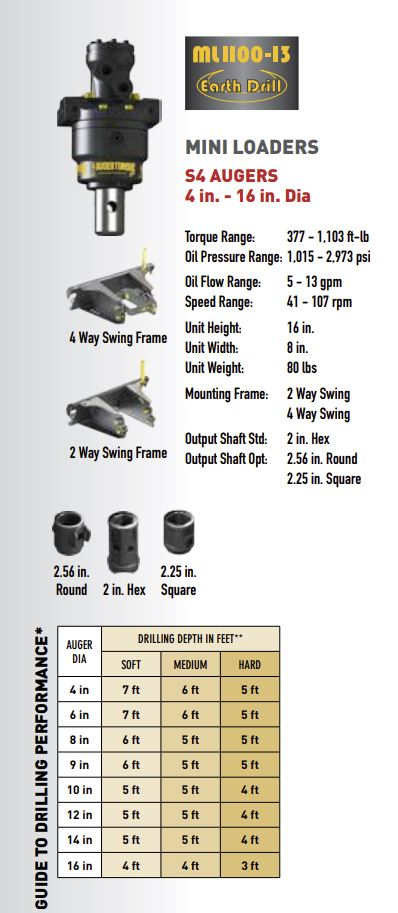

I'd read some reviews on them or find someone that has actually ran one...
At a normal tractors PSI, your torque is gonna be somewhere around 900ft-lbs. Which is about 1/4 what a skidloader auger makes. Gut feeling you gonna have to baby the downpressure and not get in a hurry with it.
But in terms of augers........remember, pressure = torque. FLow is simply the speed/rpm the auger turns.
So you could even run a much bigger auger with alot higher torque and have plenty of power......it will just do it slower.
For something like a auger....speed isnt really important. So dont get hung up on the flow requirements. For things like a power rake or hydraulic brush mower.....speed does matter....but an auger, not so much.

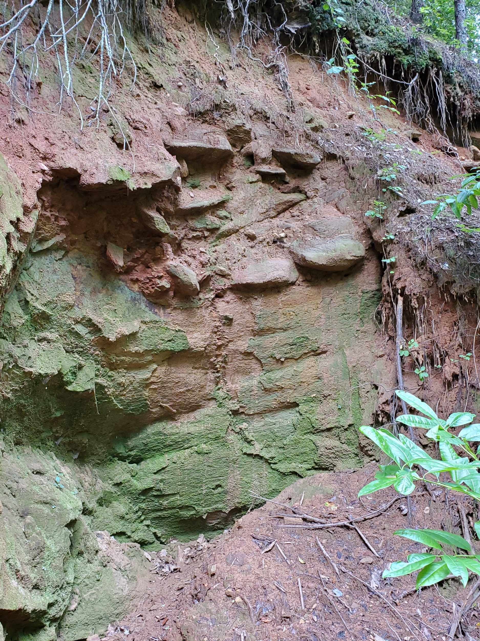

You are going to absolutely love the FEL hydraulic auger. I have one on a SSQA for the M59 TLB and run bits to 36" dia with no issues other than rocks and roots. When it binds up on a rock, I just turn on reverse and back bit out. NO hand digging to get stuck bit out of hole ( the major issue with 3 Pt Hitch auger being one direction spin). Down pressure with FEL is amazing and powers thru pretty much anything with correct bit teeth. I run both spade teeth and rock/frost tips & teeth on different augers.
A pick of auger and some typical rocks hiding under surface in NC.
I suggest you buy the hex shanks since they are are easier to mount in auger and less prone to damage since hex also becomes part of the driven system rather than just the pin is in the round shanks.

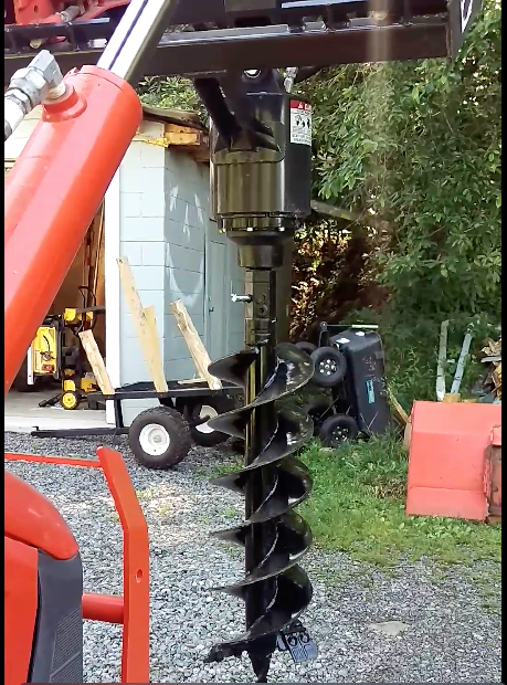

Not a Auger Torque unit, a McMillen X1475 running 2" hex drive with 12" rock/ frost and dirt bits and tree planting auger ( 36" max dia but tapered at tip for an inverse cone shaped hole for trees/ shrubs ).
I use the 12" for 8x8 posts and broken telephone poles that I get for free from local power utility and use for gate posts. Telephone polls already treated for maximal ground contact/ wood destroying insects so they last a long time.
I will take pics of bits when I am in NC on Wed or Thursday of this week.
Other major benefits of FEL ( SSQA) mounted auger are being able to drill at an angle, better visibility of where bit is ( the approach angle) not having to move tractor while drilling for 4 foot bits ( just curl the loader to keep the bit vertical as it goes into ground, a bit more reach between tractor and hole being drilled, and really being able to put some serious down pressure on the bit. My M59 scales at 9K+ Lbs with auger mounted.
A future improvement on FEL mounted auger is to mount a SSQA with correct adapter so my backhoe, with its quick coupler, can run the auger on the end of the hoe. Just like a excavator can. Future project.

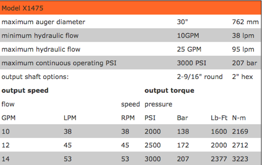

Some details on torque vs flow at psi

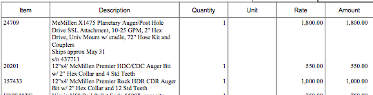

iptman,
I guess thats a reasonable price for auger and bit, given today's crazy prices for tools.
Here is screen shot of what I paid in 2016
I'm trying to avoid buying implements right now unless a amazing opportunity comes along.
