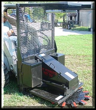

Have you used your machine with any other hyd motor on it? If so, what temp does your hyd fluid temp light come on? If not, I recommend that if you have a temp gun, take a reading after you have completed a big cut, or ran it for about an hour. If no temp gun, use a candy thermometer in the reservoir . I believe the ideal max temp for hyd oil should be around 180 degrees. Keep the hyd radiator clean as has been suggested. I would go beyond just blowing with a good soak with detergent and then rinse with water jet. Small nozzle. If I am not being nosy, how good a deal did you get on it?
Good luck and keep them blades sharp. Don't let the bush hog people know that you sharpen blades. By the way, how about a picture of the underside. I would love to come across one of these real cheap. The blade housing can slide out and cover the blades or retract for some serious work.

I've only had this Bobcat for about 6 weeks. All I've done with it so far is move dirt. I haven't run it with any other hydraulic attachment, so I don't know what the hydraulic temps are doing. I do have a temp gun, one of the best tools I own. I'll shoot the motor, lines, and tank after a good workout and see what the temps are doing. I rountinely use a leaf blower to clean the screens/radiators on both tractors and now will do the same with the Bobcat. About twice a year I wash the radiators with a low pressure water hose and "Simple Green."
I had a hard time finding one of these things used. My local Bobcat dealer in Atlanta wanted $5400.00 for a new Bobcat brand. The local Kubota/New Holland dealer could get me a Bradco RC60 for $4200.00. The local Caterpillar dealer in Atlanta was talking something over $6000.00. I know their stuff is good, but it's not that good. The Bobcat dealer in Oxford, Alabama could get a Bush Master for $3800.00. So I kept watching Craigslist and found a used one In Spartanburg, South Carolina listed for $2700.00. After a couple of phone calls and a lil wheelin and dealin I gave the guy $2300.00 for the used cutter. So add in $50.00 in diesel fuel, breakfast at Waffle House $7.00, and $100.00 in hoses and fittings I have less than $2500.00 in it.
I'm at the airport at my real job now, when I get home I'll try and get a pic of the bottom of the unit.
I agree with you on sharpening the bush hog blades. I have a small landscaping/tractor business as a side job. Most of my customers have pastures ranging from a couple of acres up to 10 or 12. So I'm mainly just cutting grass. I have a 8 foot dual spindle Kodiak cutter that will leave a finish mower look when I sharpen the blades.
