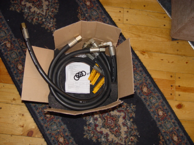

LOOK WHAT CAME!!!!!!! Better than a box of candy and at a very fair price.

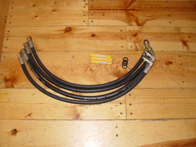

I bought 4 hoses, three were leaking[one for the shelf] and a set of Glow Plugs in case. The rubber coated metal washers came with the hoses. I installed then, Man it was cold! No leaks, nice!

hey,richard
I have been following your project on this site
good work,could you post where your hoses came from for future reference
