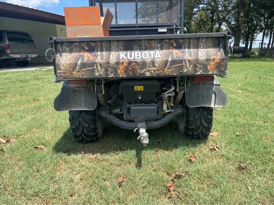

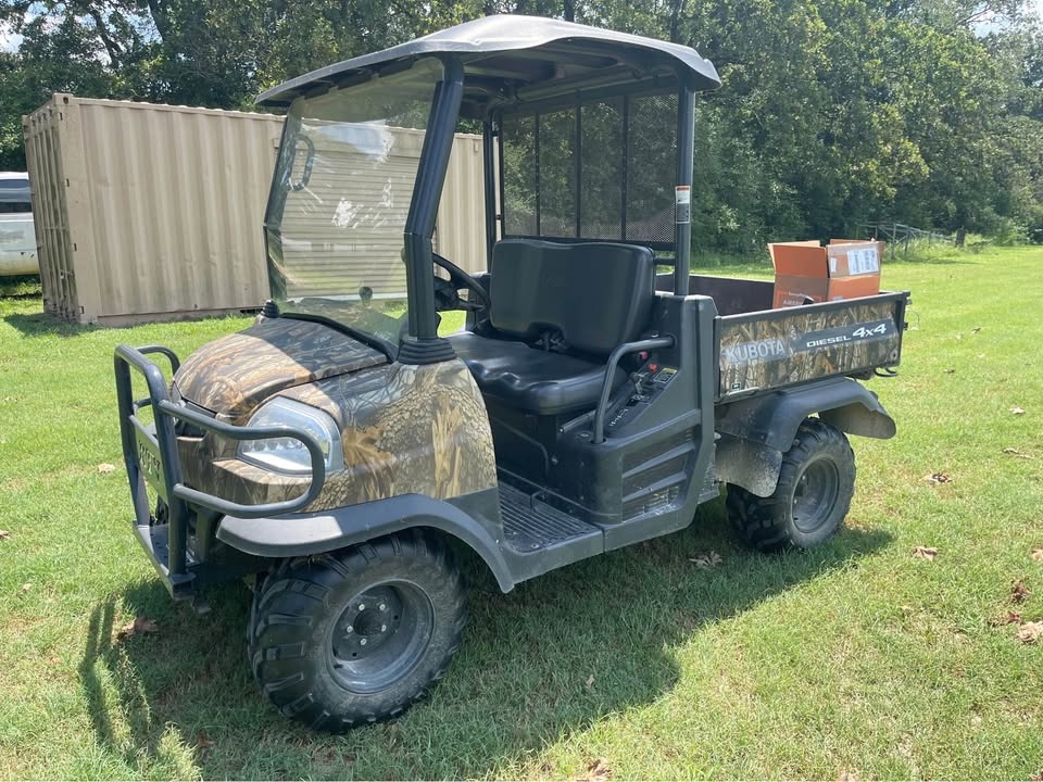

I have the RTV900 with the rear remotes. Don't think I'll ever use them.
We moved to East Texas in 2020 from the Philadelphia area.
Now live in ranch country with literally thousands of acres all around us.
They call them buggies down here.
We found a used one on FB MP.
2013 with only 300 hrs on it. $10k. Was a steal. Title and all. One owner.
Picked it up with a standard height enclosed car trailer. It was so tall we had to let air out of the tires and get people to stand on it to get it in the trailer LOL.
Absolutely love this thing.

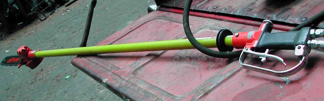

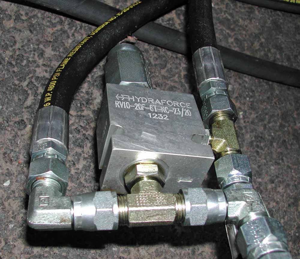

It has now been over a dozen years since I set this Reliable brand hydraulic polesaw up for a guy to operate from the seat of his tractor. He could drive around his property and trim trees without leaving his seat. I did have to add the 2000 psi cross-port RV to it, as I did with my Fairmont saw.
Since then, battery-powered polesaws have gotten better and better. So good, in fact, that I don't see any reason to go hydraulic unless you are a tree company with hydraulic power already plumbed to your manlift bucket.

That makes sense. You will need RV protection for it, and you will probably want to idle down when cutting, so you don't overdo the flow rate.
Also, long 1/4" hoses are fine for intermittent flow of 5GPM or so, but heat up the oil noticeably.
