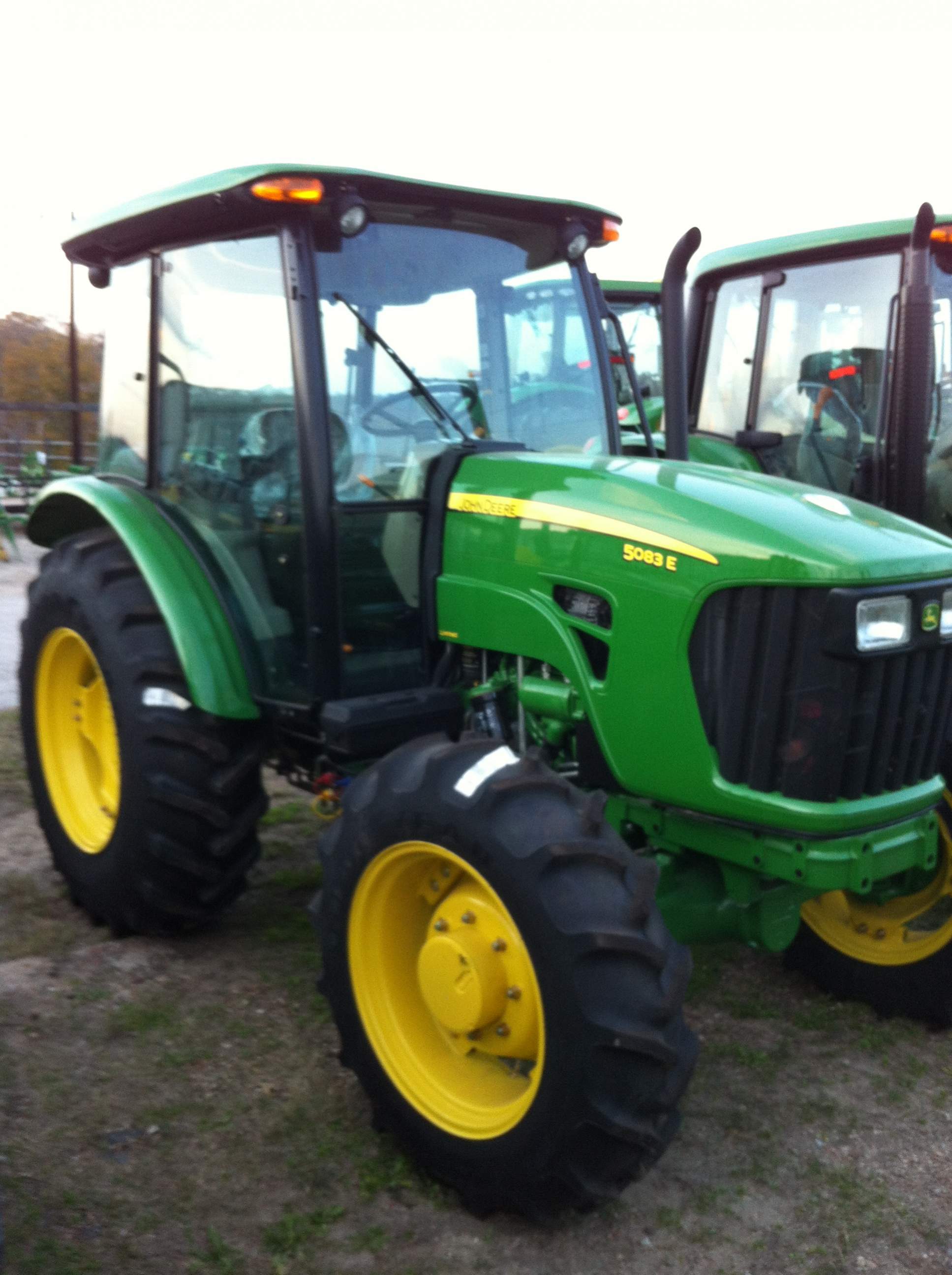

I fixed my issues...traded it in on a new one.
Whoa... is that a "total parts" replacement? Congrats! (No black axles on the new e's..)
Why not go another yard or so to 1st down territory - M series?
Nonetheless, sure like the looks of these new Deere's!! :thumbsup:
