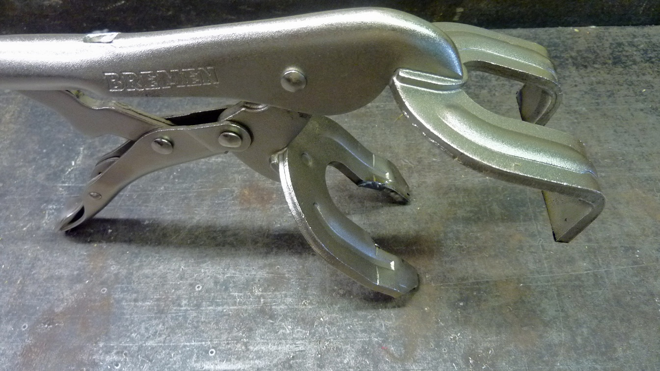

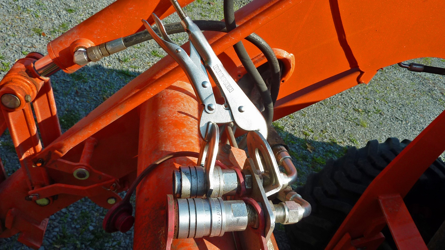

To further aid in connecting and removing these QR connectors, I made this tool from a cheap Harbor Freight welding clamp:
I ground off the clamp tabs to fit the notch in my Pioneer QR fittings. Makes the process much easier.
