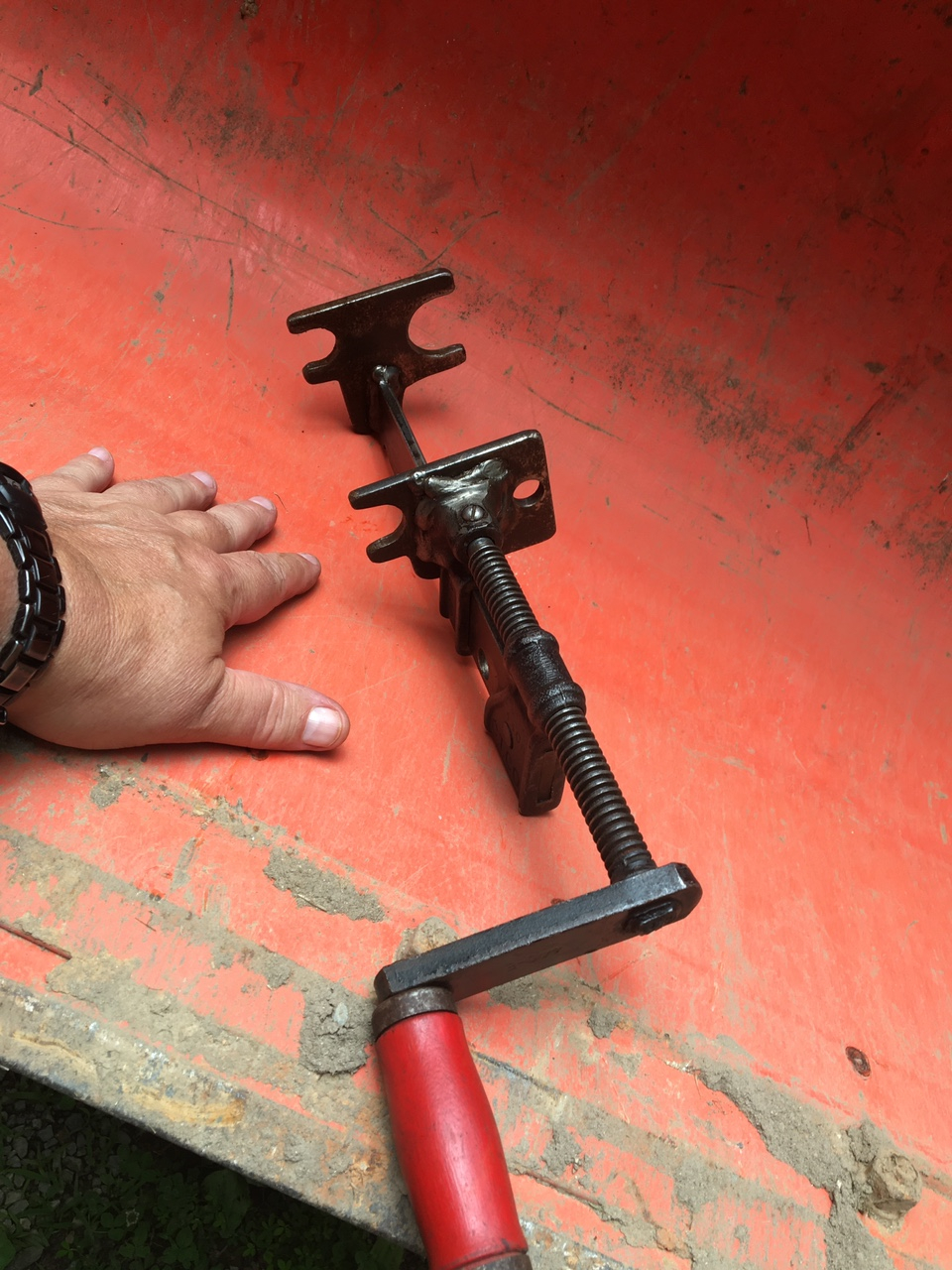

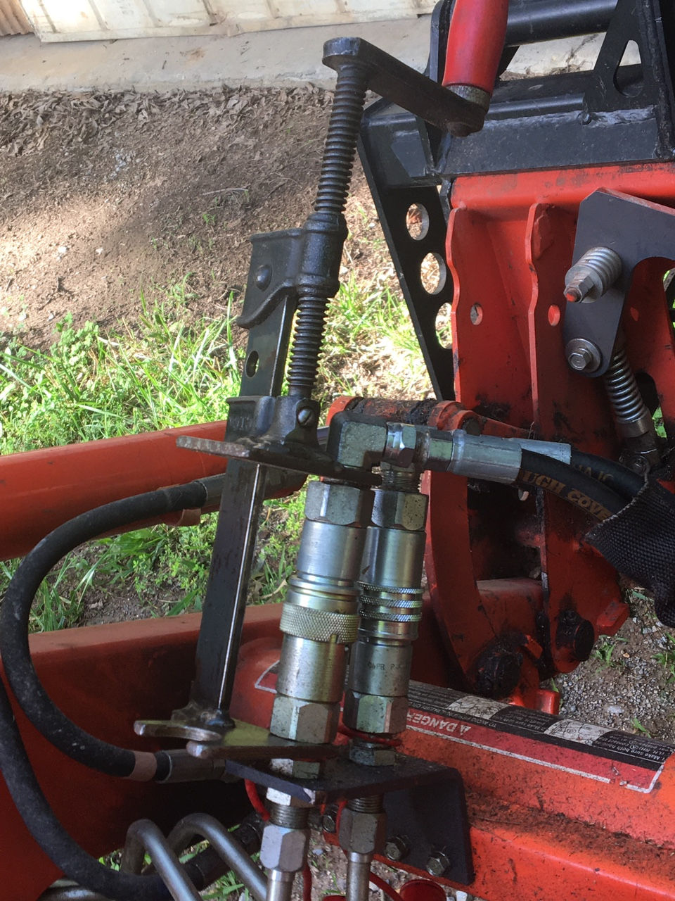

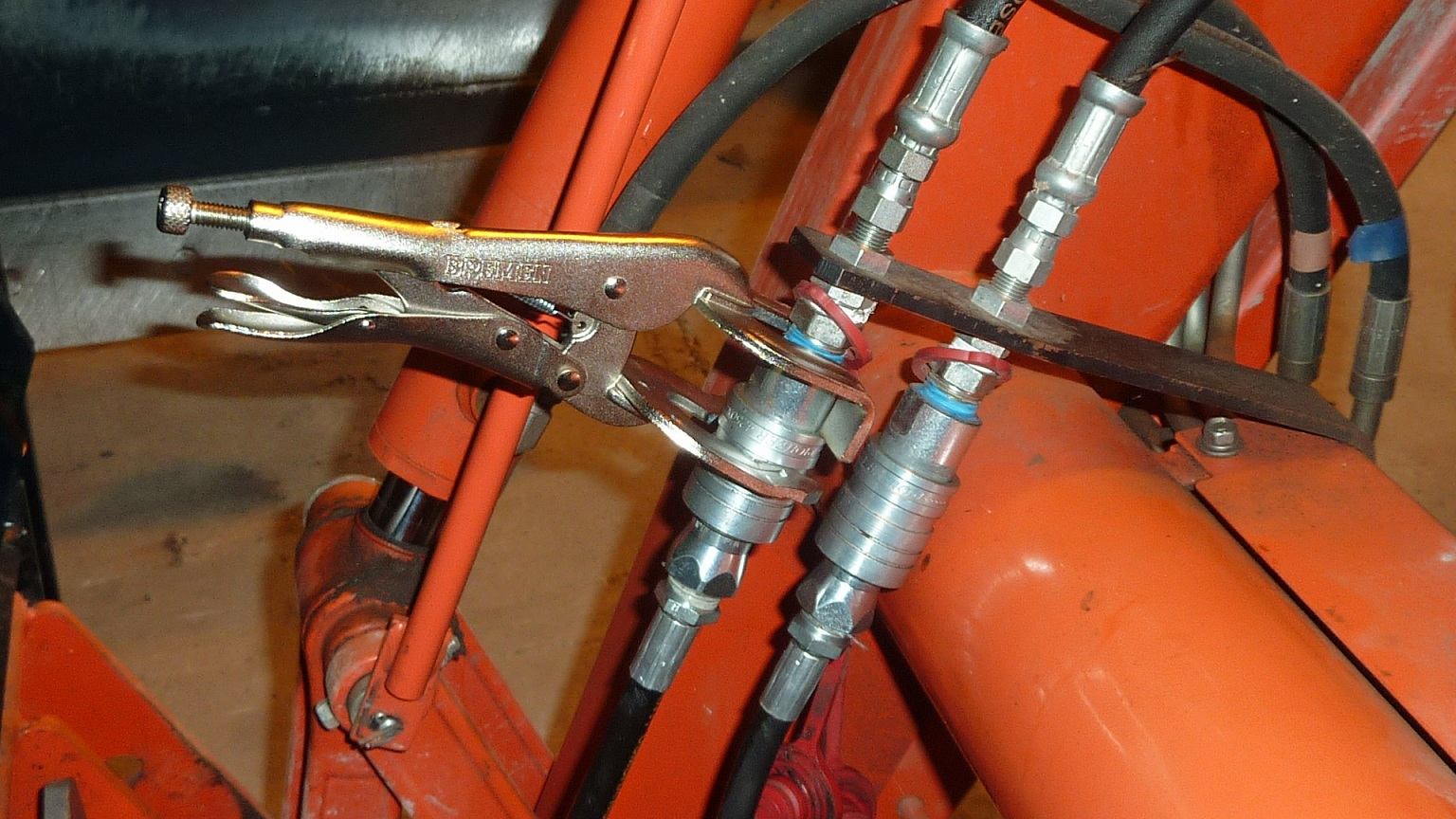

I made this clamp 20 years ago for two things. Kubota B20 backhoe and flat face grapple QDs. Doesn’t take much pressure just more than I could do by hand. Use to have to crack a JIC fitting.
Since then bought the Waite plier and it works too but you lose a little fluid.
Most times I don’t need extra help just every so often especially if I’m in a hurry.
With the pioneer type QDs on the remotes I could make them leak to connect equipment. With the newer HST tractors I prefer the flat faced connectors that I can keep cleaner.

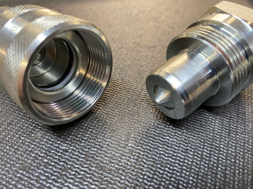

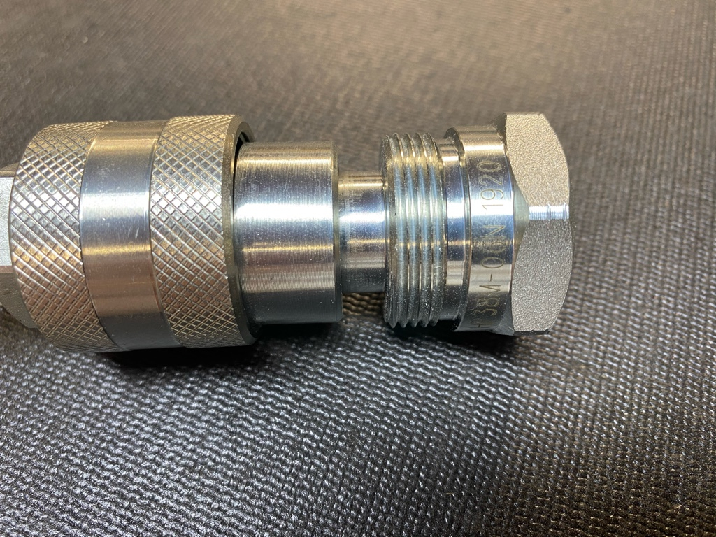

Summit HP38-06N-SET
Nigh & Day difference! I no longer bother doing the steps to cut off the engine, activate the grapple valves, etc.

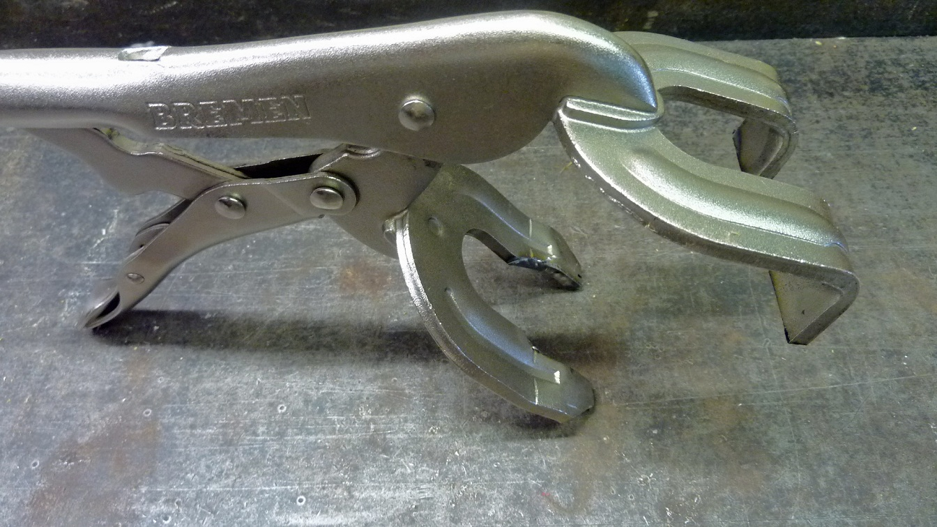

Based on one of Andrew Camarata's videos, I bought this Irwin hydraulic coupler clamps:
About $80. Now, no more fiddle-farting around attaching my grapple. Made life a lot easier.
5 minutes with a grinder will turn this $12 welding clamp from Harbor Freight into a similar tool:
