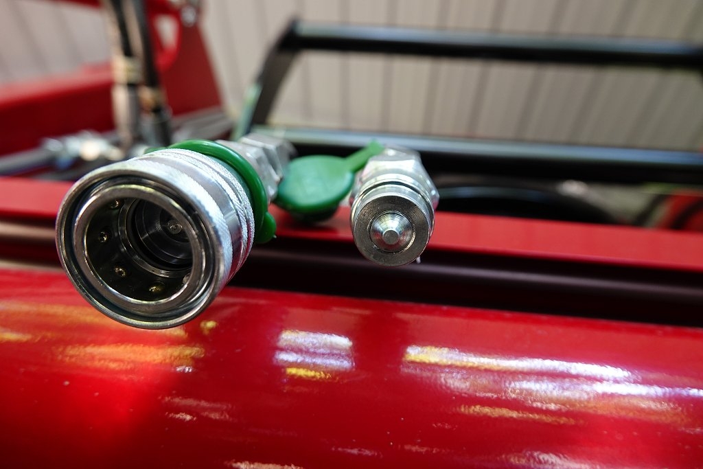

I just got in an implement for my FEL to mate up with my 3rd function, which is (from what I can figure out) a poppet style coupler set.
What I got on the implement is some sort of round ball instead of that tapered raised center. I sent the above pic to the place I bought it from, so they knew what I have. Been wet behind the ears with this hydraulic stuff, I have no idea if the two types of couplers are going to be compatible together. Yeah, I know I could just try it, but I don't like experimenting with things like this. Not to mention that the implement is still in the back of the pickup truck.
So will they work together or do I need to buy exactly compatible couplers and switch out those round ball ones?

Oh hell..... So there are two different styles of the poppet couplers? Is one more likely than the other to be on my TYM T474 tractor?

You very likely have AG couplers on the tractor. The ones in the pic are shown front on instead of in profile but they are probably AG couplers too. If they're the right size and also AG couplers, try them. They probably work. The ball and poppet types of ISO 5675 are supposed to interoperate. Mine do.
/ Hydraulic coupler compatibility? #5
Poppet type coupler is designed to be higher flow(GPM's) than ball type but most will interchange when connecting.

Three "types" of couplers that all look similar
ISO 5675 (AG)
ISO 7241 series A
ISO 7241 series B
NONE of them are interchangeable yet all look similar. Ball vs Poppet are usually interchangable as long as the couplers are the same series.
There are also different sizes.
Its not "experimenting" to see if they will plug into one another. And taking a picture of the SIDE of both male couplers would help us identify them (if there is no writing on any of them). Front pics show nothing

What you have are Pioneer style not release under pressure couplers. The Pioneer ball end couplers are release under pressure and they are all available at any tractor dealer and Tractor Supply as well and because Pioneer's patent ran out, everyone sells them and brand is not important so long as they will couple without leaking and retail sellers also sell rebuild kits for the internal seals and 'O' rings. Just have to be careful when renewing the 'O' rings as they have to precisely fit in the machined in recesses in the male fittings and in the females and they will all leak a bit when you couple them up but the hydraulic fluid is 'hydroscopic' so it washes off when (and if) you wash the tractor.

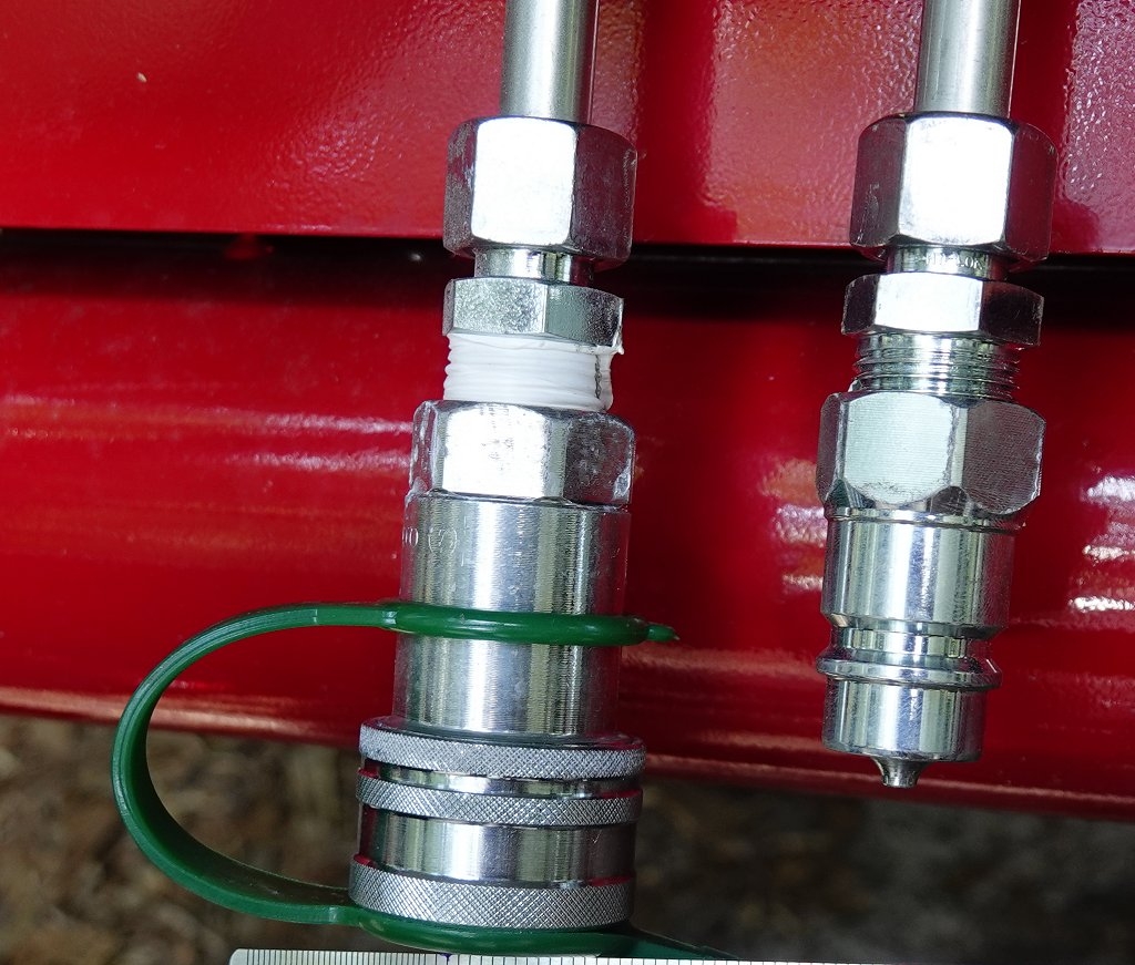

Okey dokey, here you go.....

I have AG couplers; some are ball, and some are poppet. They are all the same series. They all work interchangeably, poppet gives better flow if that matters (driving a hydraulic motor, etc.). They all leak if that is an issue.

Ag or series A....
Where is the pic of the other male coupler?
What other male coupler? The one on the Notch tree puller? The male coupler on the hose from the Notch connected easily to the female coupler of the tractor. It was the female coupler on the hose from the Notch that was a real SOB to hook up to the male coupler on the tractor! Quite honestly, I am not going to disconnect them until I have a real good reason to do so.

Yes, it would be handy to see both males.....and or any writing or numbers on the couplings.
Because the male/female pair on the tractor are most likely the same series.
As are the ones on the tree puller.
But is the pair on the tractor, and the pair on the puller both the same series? And the only way to know is either the writing.....or examining the couplings closely. And since you cannot see down inside the female very well, especially via picture over the internet.....a picture of the two male halves side by side would be helpful.
There are "some" ISO 5675 and 7241-A that "can" interchange. As some have reported compatibility. Though its not a good Idea to mix/match series of couplers.
So in your case....I was wondering if you had a 5675 on the tractor and a 7241-A on the puller. Which could explain why the male of one couples to the female of the other but not vice versa.
In otherwords.....a MALE 5675 my indeed hook into a female 7241-A......but the male 7241-A may NOT hook into the female 5675. Because the make 7241-A had some extra notches down at the base of the coupler
See the picture. Hence why I was wanting to see the other male fitting
