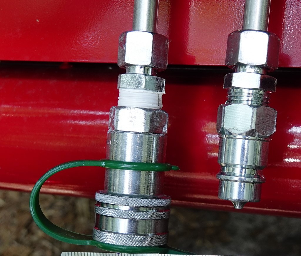

Beats me. I have some extra coupler sets on order. I will change out the female coupler on the Notch if one of the new ones works easier than the one now on it. That coupler DID work, but it was a real bear getting it to. If I have to replace ALL of the couplers until I get some that don't take a dozen grunts and a prayer to connect, that is what I will do. Otherwise I will have to pick which attachment I want on the front of the tractor, and that is the one that will stay there. Which is kind of stupid, but sometimes a stupid problem requires a stupid solution.
So which type is that male coupler on the tractor shown in the pic? ISO 5675 or 7241-A?
/ Hydraulic coupler compatibility? #22
It's a 5675. Notice the difference? It don't have the extra step in the body behind where the balls lock
