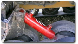

You just unscrew the grease fitting, or in my case I will tap a screw on plug, so just unscrew the plug. Its possible that they have built some special valving but I doubt it because you do not want grease to move past the piston or you would be greasing the tensioner all the time. The attached pictures are the size I found them.

Most aircraft landing gear legs or 'struts' are oleos.
OLEO stands for air over oil.
Basically a hydraulic cylinder with some oil in it and the air pressure controls the length.
When the aircraft hits the runway the air compresses therby absorbing the shock and the arrangement produces no bounce, just shock absorption.
For purpose of track tension, a closed cylinder with some oil and a suitable air valve (to increase pressure (for more tension) would do the trick without needing springs.
I would think that any heavy shafted hydraulic cylinder (single action OK) with one plugged pipe thread and the other with an air valve would do the job and eliminate the need for a pressure spring.
Someone mentioned snow plow cylinders which are generally single action.
Great, that'll work, just add air valve instead of hydraulic source.
The plow cyls are big shafted, single action, rugged and cheap!
Generally 2 lengths are available: (think, 12" and 16")
When I plowed with a truck I always knew if there was air in the cylinder as it gave just the kind of effects that you want for a track tensioning device.
The air valve you'd want is made by Schrader for aircraft and comes in pipe thread or O-ring style.
Good luck, have fun!

If you do use a grease zerk (Or screw in plug) and "just unscrew it" to relieve the pressure be careful as this could be dangerous, or should I say WILL be dangerous. If you have more than a couple of psi pressure in there it will shoot the zerk with a lot of force (ever use an air cannon to shoot potatoes).
You would be better off to have an on/off valve that could block the pressure and then make sure it points away from you when releasing pressure.

I picked up two new 6' stroke plow cylinders. They are 1 1/2 in bore with 1 1/2 inch shafts. Unlike a dozer, my unit has both suspension and air filled tires (for now) so there will be give in the system. The cylinders were only $31 a piece. I have done nothing in the past two weeks.
