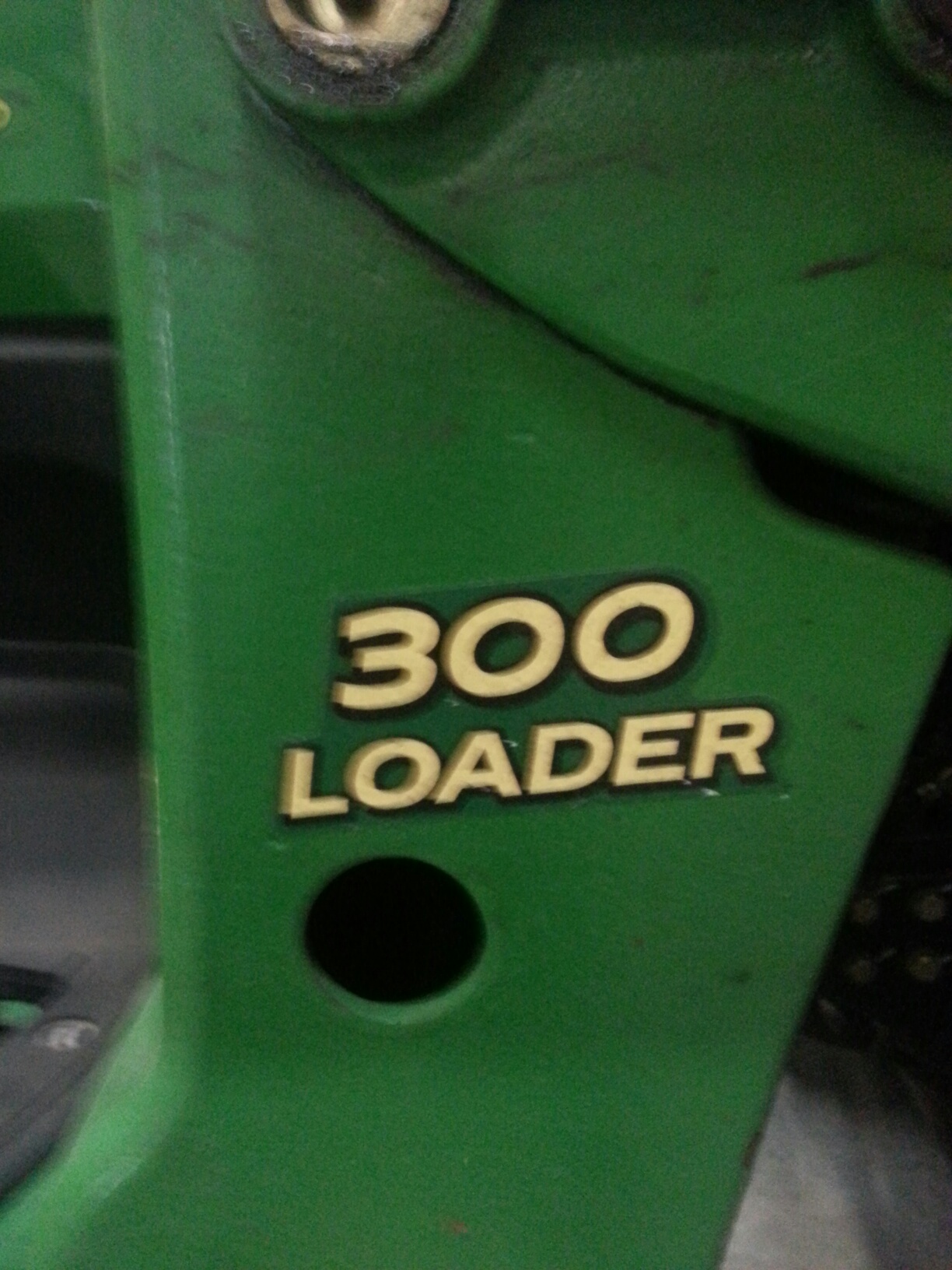

Do you have any pictures? How are you positive that it is a 300 loader and not a 300x?

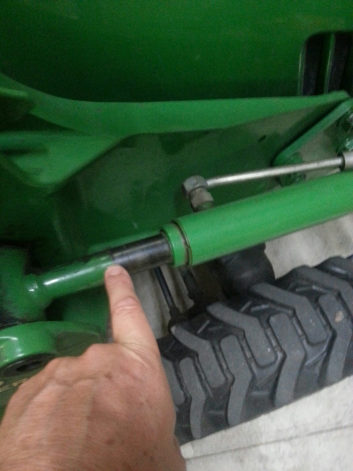

And in an earlier post, when you mentioned that you thought the cylinder bore was 1", how did you come to that conclusion? It is hard to put a finger on the bore size of a cylinder without actually taking it apart. And also just wanting to be sure that you were not measuring the rod itself...

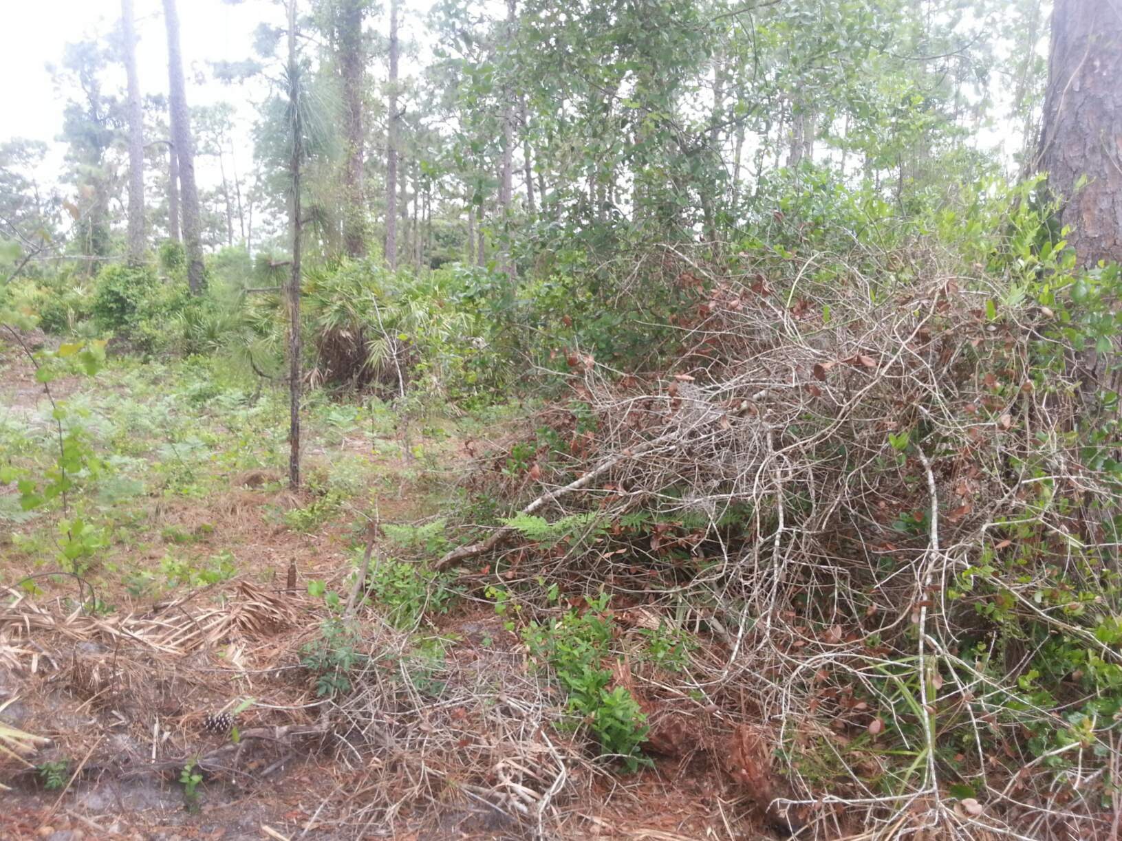

I've upladed several photos. One will give you an idea of what the land looks like prior ro clearing it with the tractor. The second shows the model numbr on the loader. The third shows the piiston part of the cylinder that measures 1 inch,.
So how would I go about measuring the hydraulic pressure ?

That ain't the piston. That's the rod. And I have no idea for sure what loader it is. But if indeed it is a 300 and not a 300x, it is too small and underpowered for a 3320. But don't know if it can handle larger cylinders that develop more force, from a structural point
