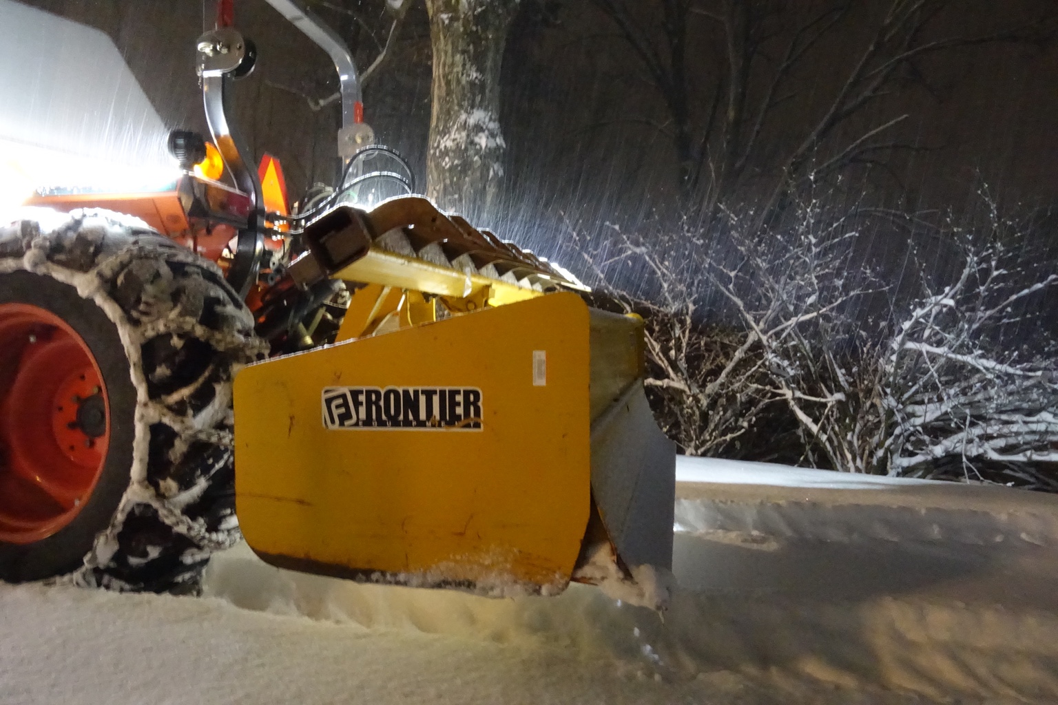

You guys are hilarious :)
Why don't one of you do an experiment? You know, actually prove something? I would, but I really don't care the reasons.

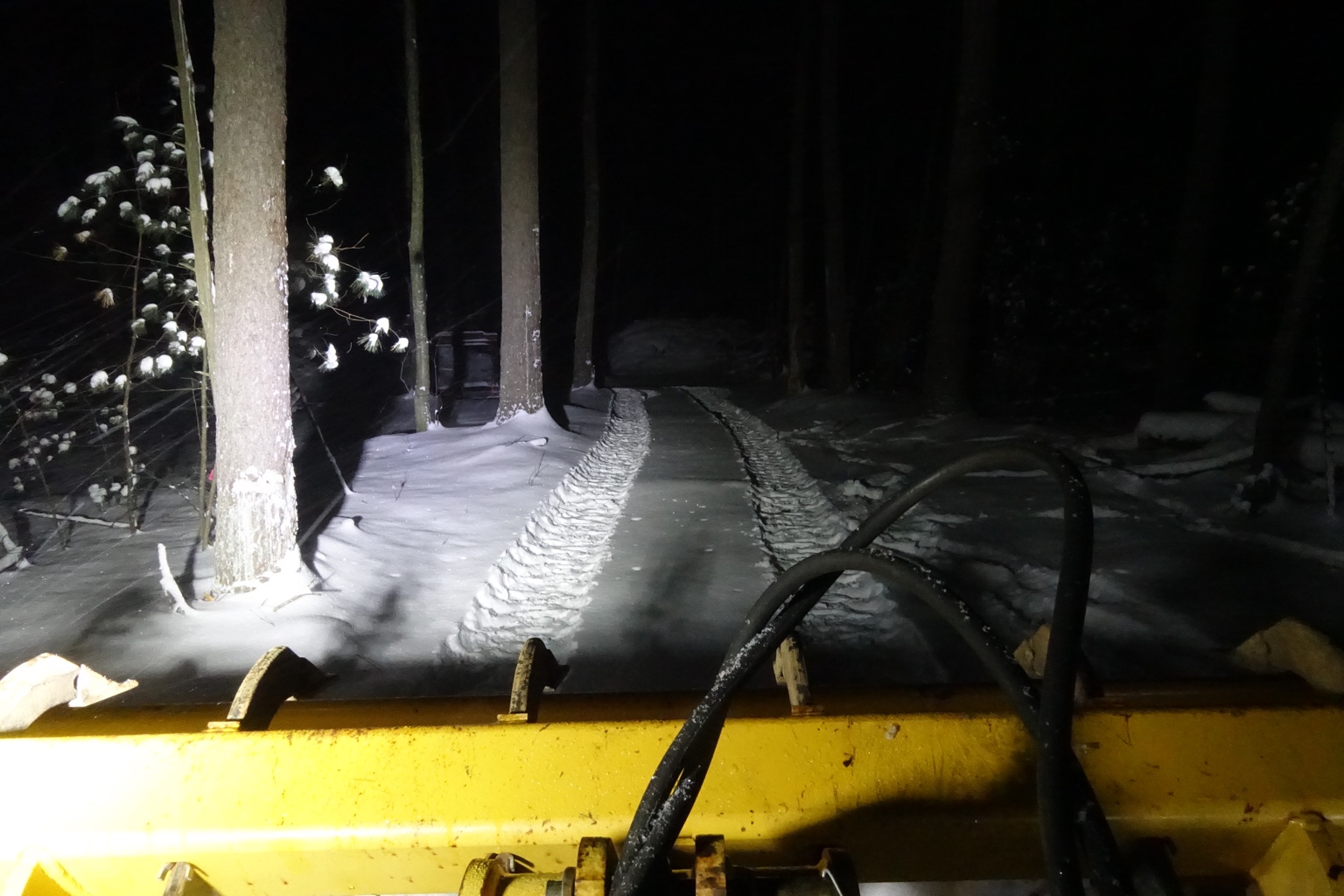

I'm just happy it's all still working perfectly. Didn't drift at all playing in the snow today.

You already proved it. You rebuilt the cyl and got rid of the air and it started working.
   / Hydraulic Cylinder Leak Down on Box Blade??? #84
Since a small shaving was stuck in the piston valve it is feasible that the shaving was holding the valve "cracked open" so the fluid exited through this valve slowly. Air space on the back side of the system allowed this fluid to escape. That is my opinion or gut feeling as to why the cylinder retracted slowly along with simple friction.
Very possible.
